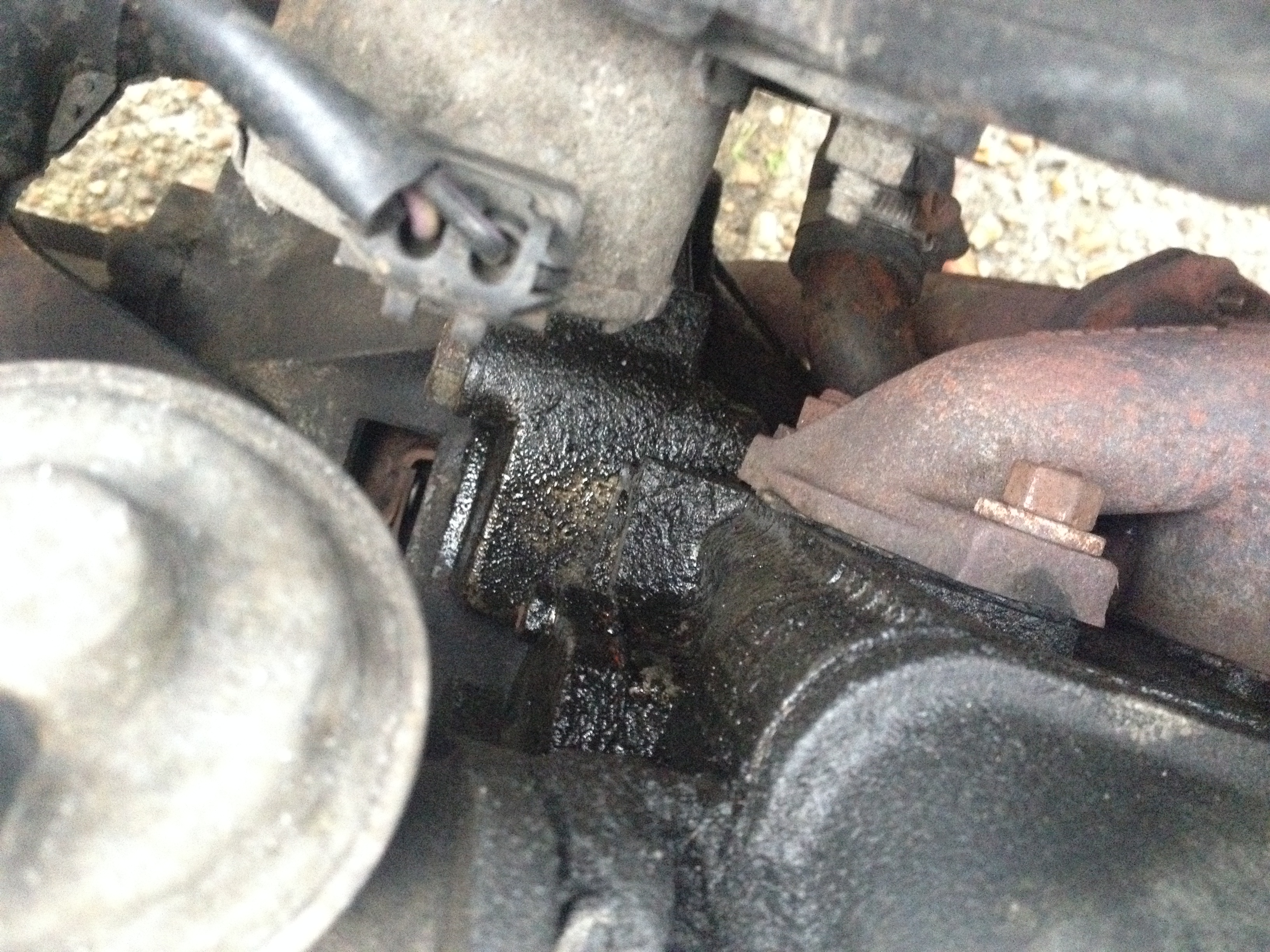

Think exhaust has a hole somewhere, possibly downpipe/manifold, she doesn't stall if I cover the exhaust with my hand but can't really hear anything hissing.

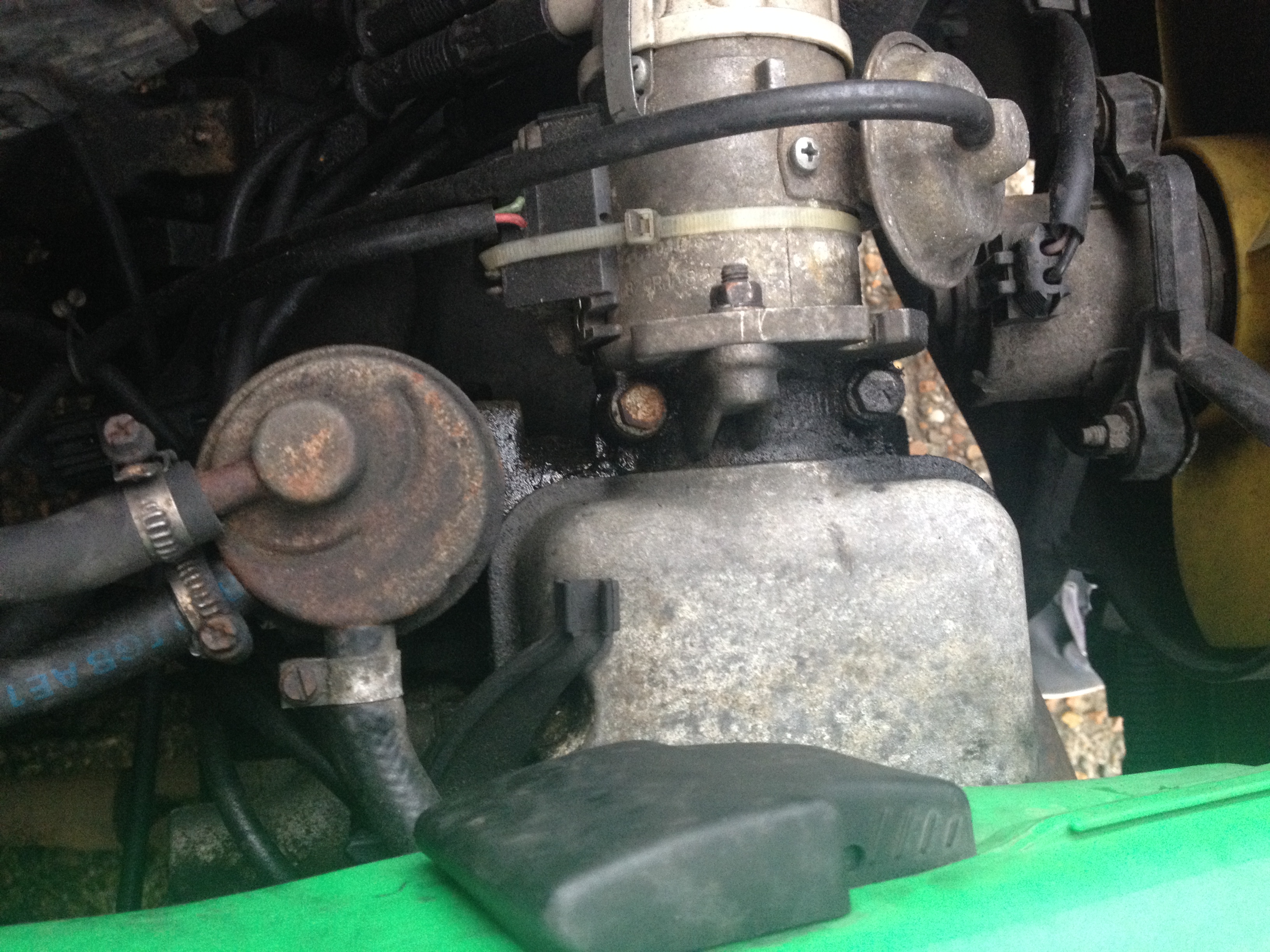

Engine has been degreased but was scared to hose under the engine too much incase I damaged those fragile Italian electronics so its not exactly shiney but should at least be able to confirm if oil leak is present on her next run.
Assuming the manifold isn't cracked then it should be, might be worth tightening the retaining bolts in case they're loose?
The smoke (when running on choke you can see slightly white smoke) comes from the join between, could try and tighten the bolts I guess. Hope it isn't cracked manifold :(
Not worried about exhaust leak that much as its so minor, only can really see the gasses escaping if I block the exhaust. More concerned about the oil leak...
I'd ignore them both, will be like our origional 750L then :ROFLMAO: (although she's no back box fitted atm.
The problem with the exhaust join is that the bolts get mega rusted and brittle. You sometimes end up snapping them if you can get the bolts/nuts to move at all. If they are newish bolts though see if you can loosen them slightly, squeeze a bit of exhaust paste around the join and tighten the up again. A quick fix but it won't last forever if you use your car every day. The gaskets for that joint are still available to buy from most good parts suppliers :)
As Andy says they are bound to break as soon as you touch them so if you are going to tackle it, make sure you don't need the car anytime soon as it could easily turn into a bigger job. I wouldn't panic too much about the oil leak, it looks much worse than it is, you will be loosing hardly any oil at all. Rocker cover gasket is a half hour job to do anyway(y)
