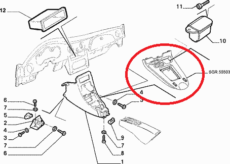

Hi,
I got a big scratch in the part of the panel just in front of the handbrake.
(See pic below)
Can anyone tell me how I go about to replace it?
Where could I find one and how much could it be?
Thanks a lot
/Jorgen

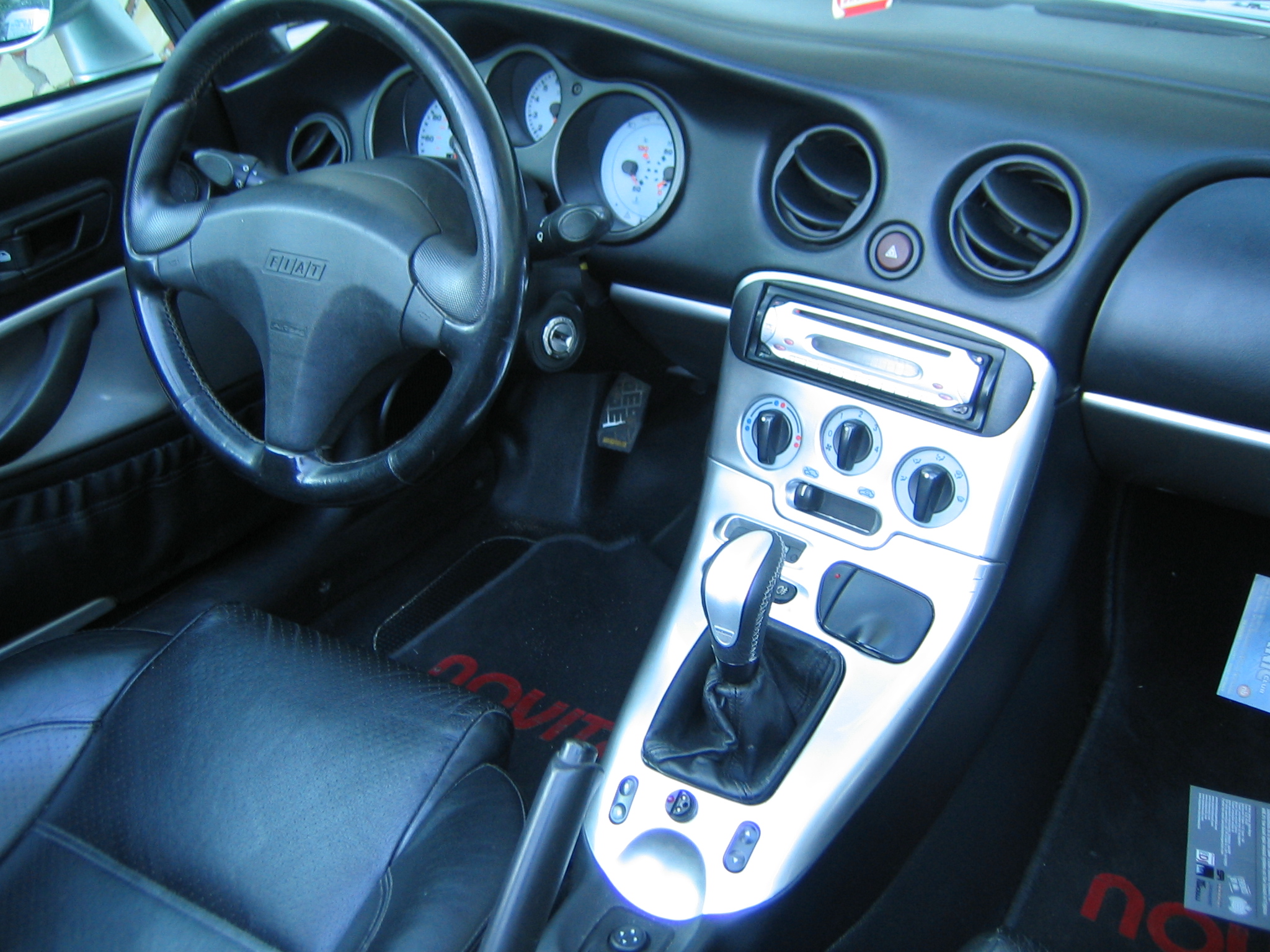

If its the centre consul you can spray it. No need for a new one. Is yours black or another colour. Mine is sprayed silver..
Heres a quick guide on how to remove the console
Remove gear knob leather cover and ashtray
Unscrew 4 bolts where knob is, and there is one screw in ashtray.
Start lifting up that console where are switches for windows.
Unplug all connectors for electric windows, fog lights and clock.
You will also need to remove the radio & radio adaptor suround as there
are some more bolts behind radio cover (adapter suround)
Remove the three heating switches by just pull them away ...Note behind the middle one is another screw and there are also 2 screws in bottom of that console.
Hope that helps..

and when you will put switches back, don't screw them to tight. those plastic screw holders could crack if you have strong hands. and i think screws are not same size, so remember from where each screw come from.
