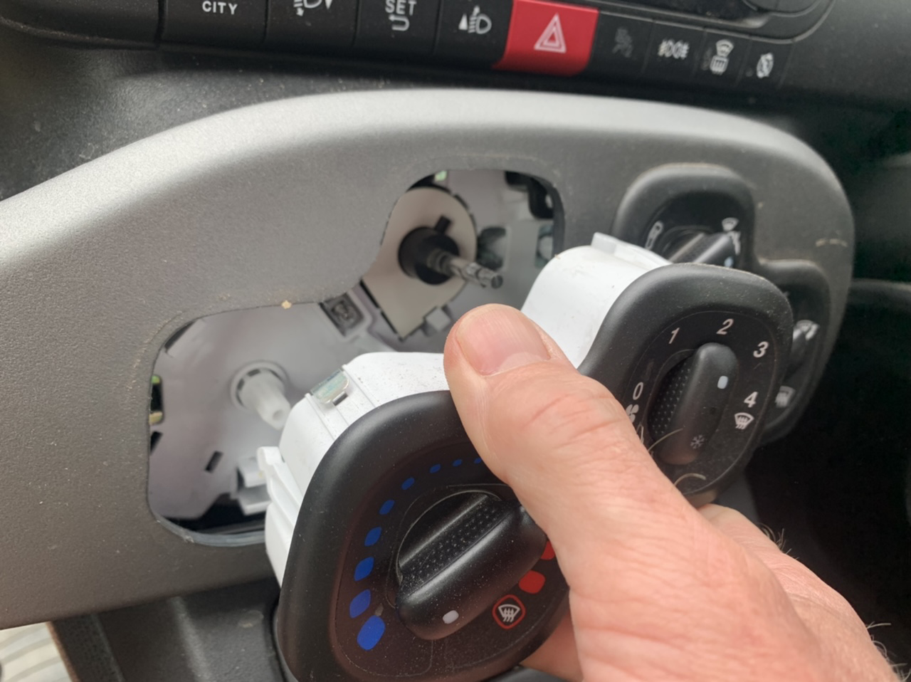

I've been able to pry the panel out as-per the video, but the problem I'm facing now is that because my car is RHD, the light that needs replacing is on the other side of the panel (if that makes sense)
It feels to me like there are another set of clips directly in line with the gear lever that are stopping the panel from coming out further - does anyone know whether this is the case? I've tried applying as much force as I'm game to, but they didn't budge.

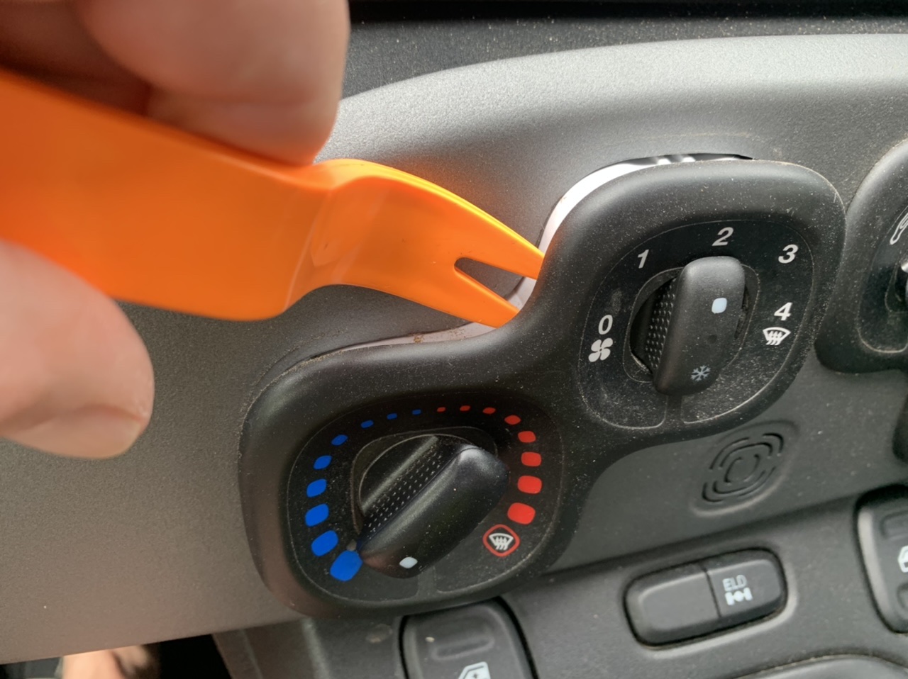

There are two separate bulbs - one behind each pair of controls. You can pry the black surround from either the temperature and fan speed control, or the direction and recirc control out of the dash. On the 2012- model you don't need to remove the knobs - they come away with the black surround. The clips are very strong (they are metal springs so will not snap) but once you get it started it will ping off quite easily.

Here’s how to remove the left panel. Exact same approach for the other side…
Before you start, turn both knobs fully to the left - this helps line them up as you put it back together.
Work a pry tool around the edge of the trim. To get it started, pull the temperature control towards you to leave a gap the pry tool will fit into. Ease it all the way round. Once free enough you can pull the panel out by hand. Last phot - my finger is pointing at the bulb

Thanks. I didn't scroll far enough down to see the 2012+ update ?
However, after much perseverance and some very, very, very sore finger tips I managed to get both sides off and swap the bulbs!
Happily, everything snapped back together with ease.
Success!
