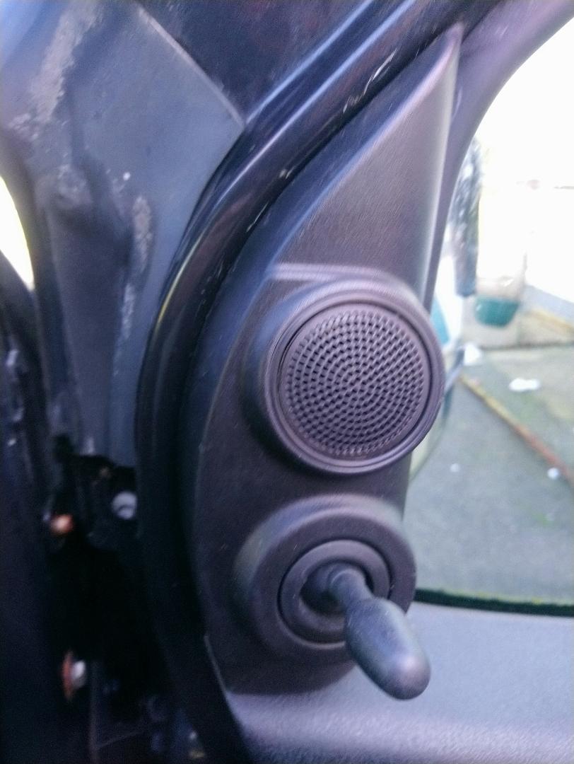

Hi
Can anyone enlighten me as to how i remove the inside side mirror adjustor on a 2012 Doblo, so i can access the bolts and change the mirror assembly.
Its one piece with a little speaker.
I have to do mine sometime...I assumed it was just clipped and use of a suitable lever would pop it off (possibly accompanied by the sound of shattering plastic :) ).
Let us know please.

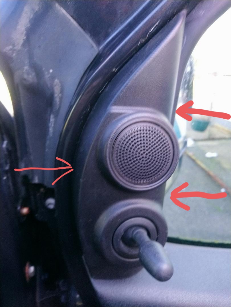

Hi, this part is clipped in place. If you shove a wide blade screwdriver of interior trim removal tool (also known as wide blade screwdriver ?) in the areas arrowed, and lever it off.
