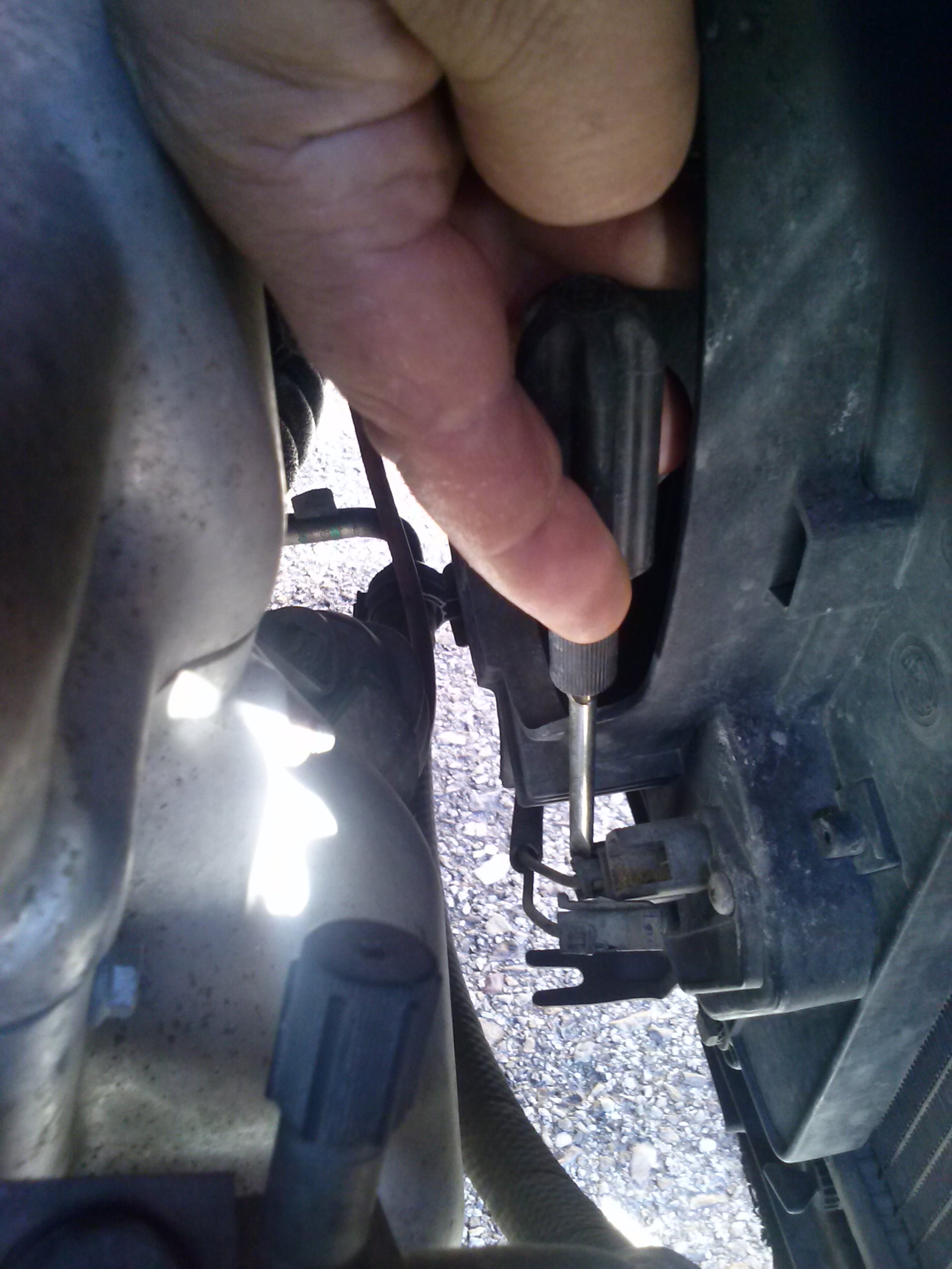

The work is simple .
Just look at the photos.
The resistor can be purchased here:
https://www.rexbo.eu/frigair/preresistor-electro-motor-radiator-fan-3510015

I do not know, but my Multipla resistors (JTD 110 Cv 2002) and my Stilo (150 hp Mj 2006) are equal.
Resistor in Multipla:
..... and this is the Stilo:
