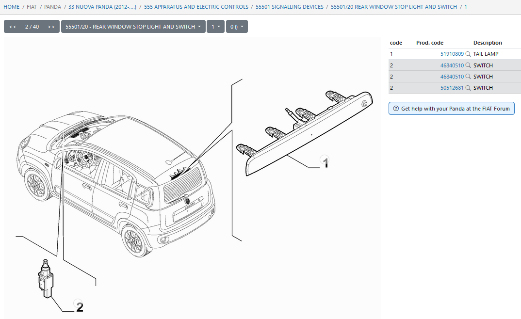

The part number is 51910809 according to this diagram from the forum ePER:
