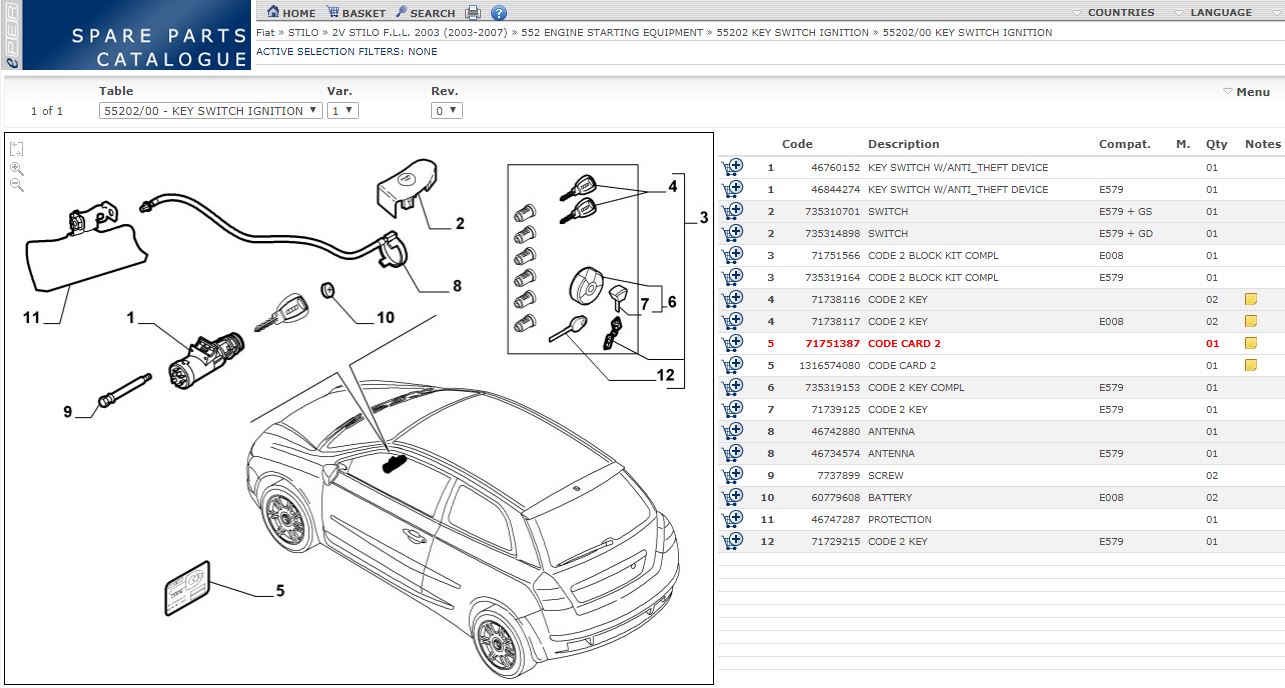

What are these for. The green fuse in green plastic....the long black plastic thing....and the square black plastic thing

Thanks mate. I am back on to this now and please see attached photo for the work that Fiat did however I'm not sure about the codes or if the code starting with q on the photo is my renewed keycode? They say "attempted to recode" but not say if that went successfully nor if have a different code
