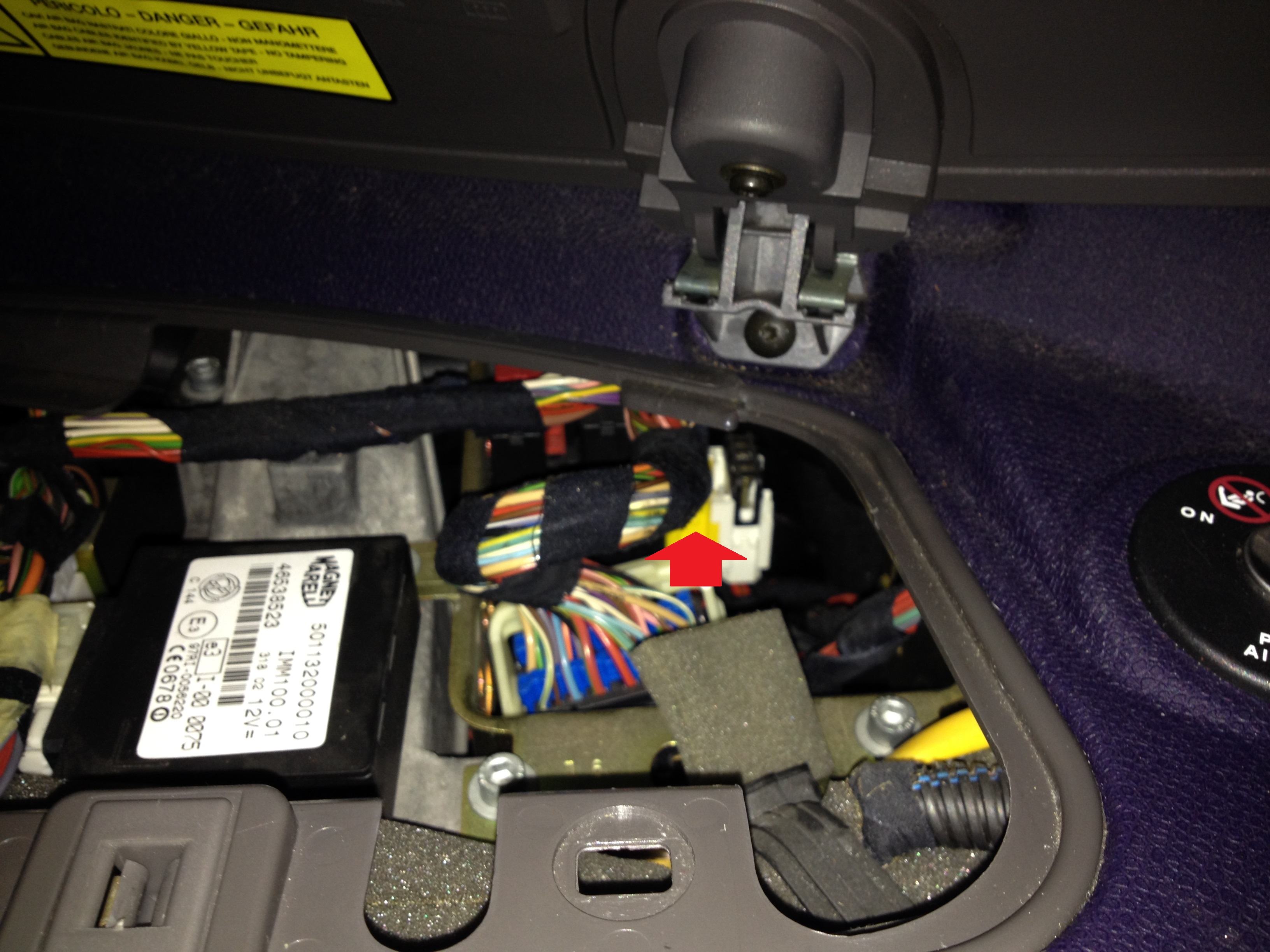

OK, found the fuse.
A textual description couldn't adequately convey the obscurity of the fuse location. See attached for a photo of the location.
It is well away from the main set of fuses(far right side of fuse bay), behind the wiring loom and actually under the dashboard. You will need to use needle nose pliers to remove the cage and fuse.
I don't know what they were thinking when they put those fuses there.
Dylan
