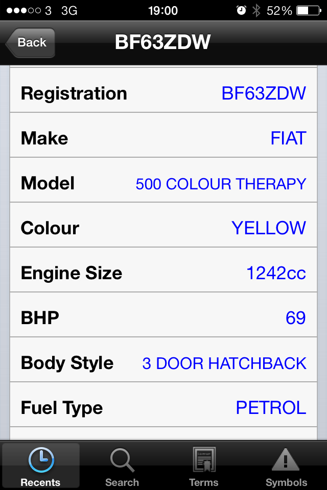

Post the reg plate and I'll check what engine it is for you.
I enjoyed the 1.2 500 I had for 7 weeks on loan, but couldn't have one as my daily motor due to size :(
BF63ZDW is the reg. I think this particular model is one of those 'colour therapy' models with the white wheel trims, aerial and mirrors. And the body and interior are mustard yellow. Really not my cup of tea at all. But at least I got a courtesy car, although I would have preferred a Panda Pop or something more utilitarian :D Even a Doblo or Qubo would have been more up my street. Boxiness all the way!
