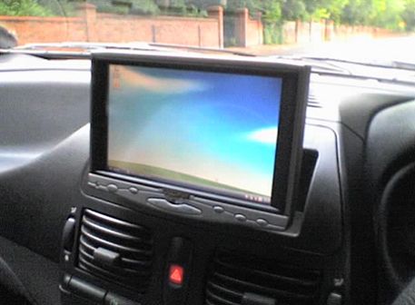

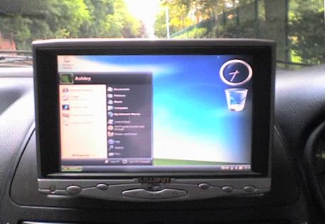

Well, carputers fitted and working. Opted for the screen and laptop combo in the end purely cos it was an absolute doddle to wire up and from a security point of view it can all be removed and hidden away. Laptop has a continuous power supply so it's not dependant on the battery.
Couple of pics:
Am well chuffed :D
There's honestly nothing worth seeing as I left the glove box in tact. I just stuck the laptop under the passenger seat where the CD changer normally sits then ran the screens VGA cable and laptops power supply under the carpet up through the dash.
Can take pictures later on when I get in from work but like I say nowt of interest other than a seat with a laptop under it, lol.
