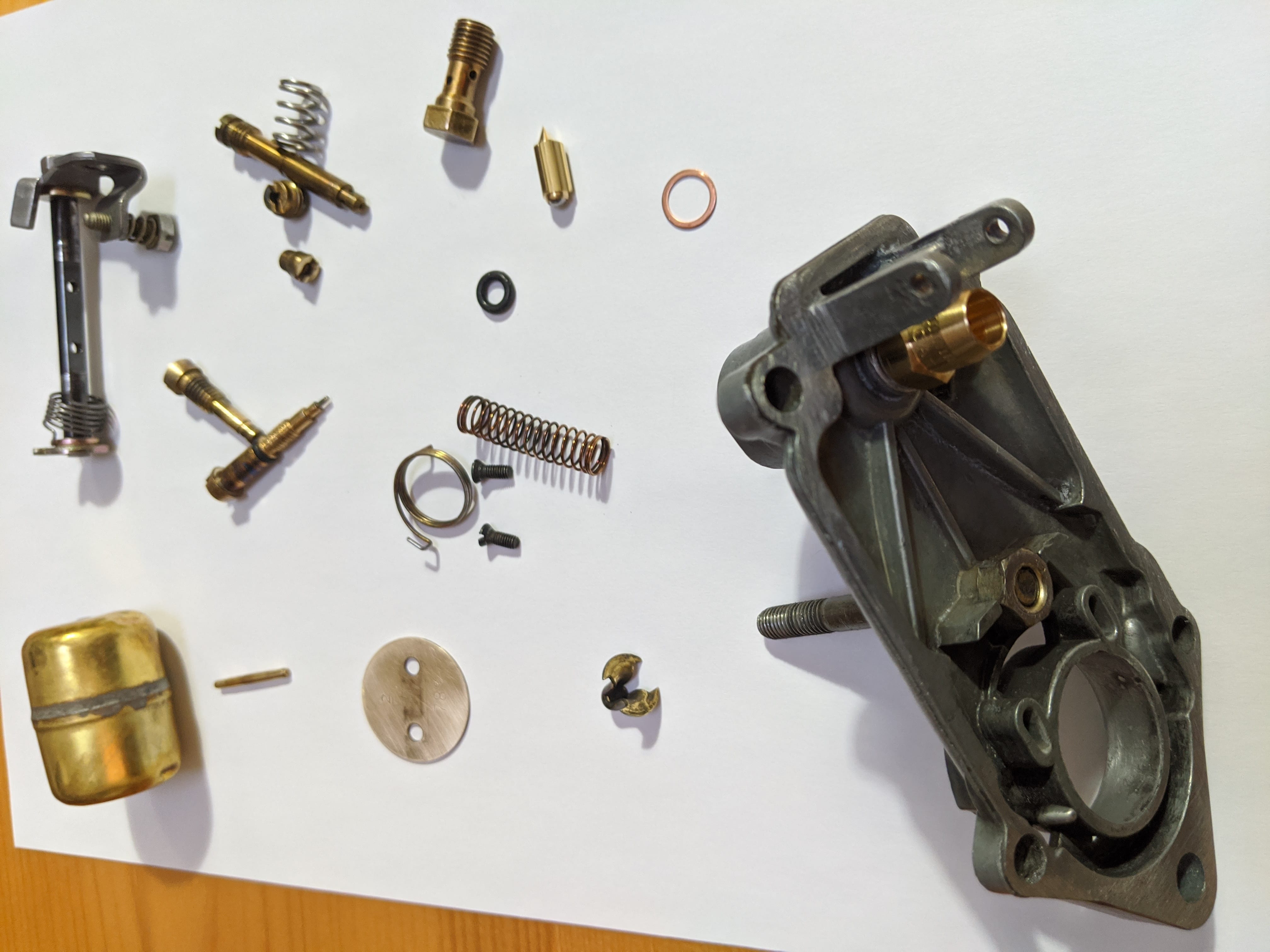

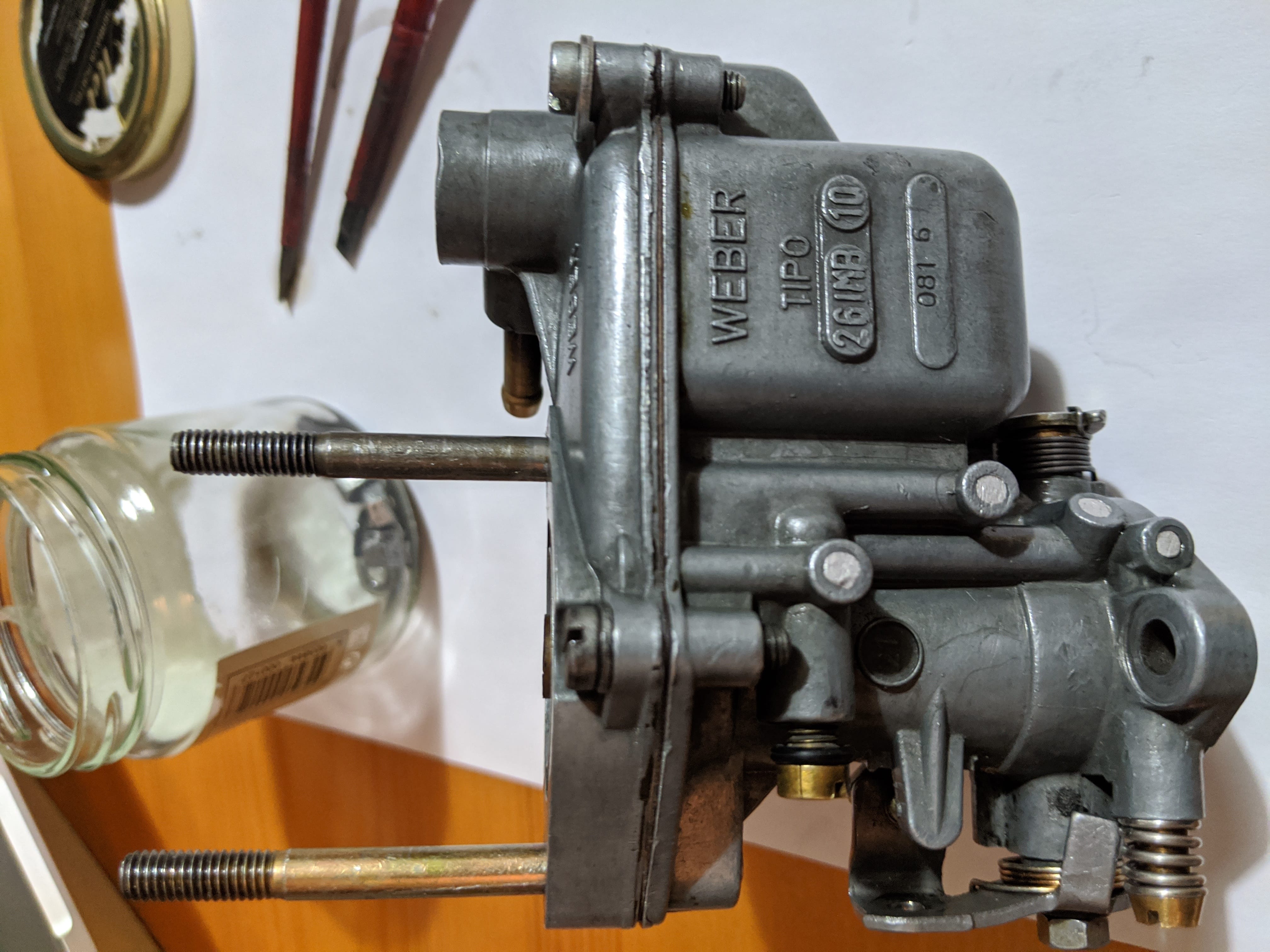

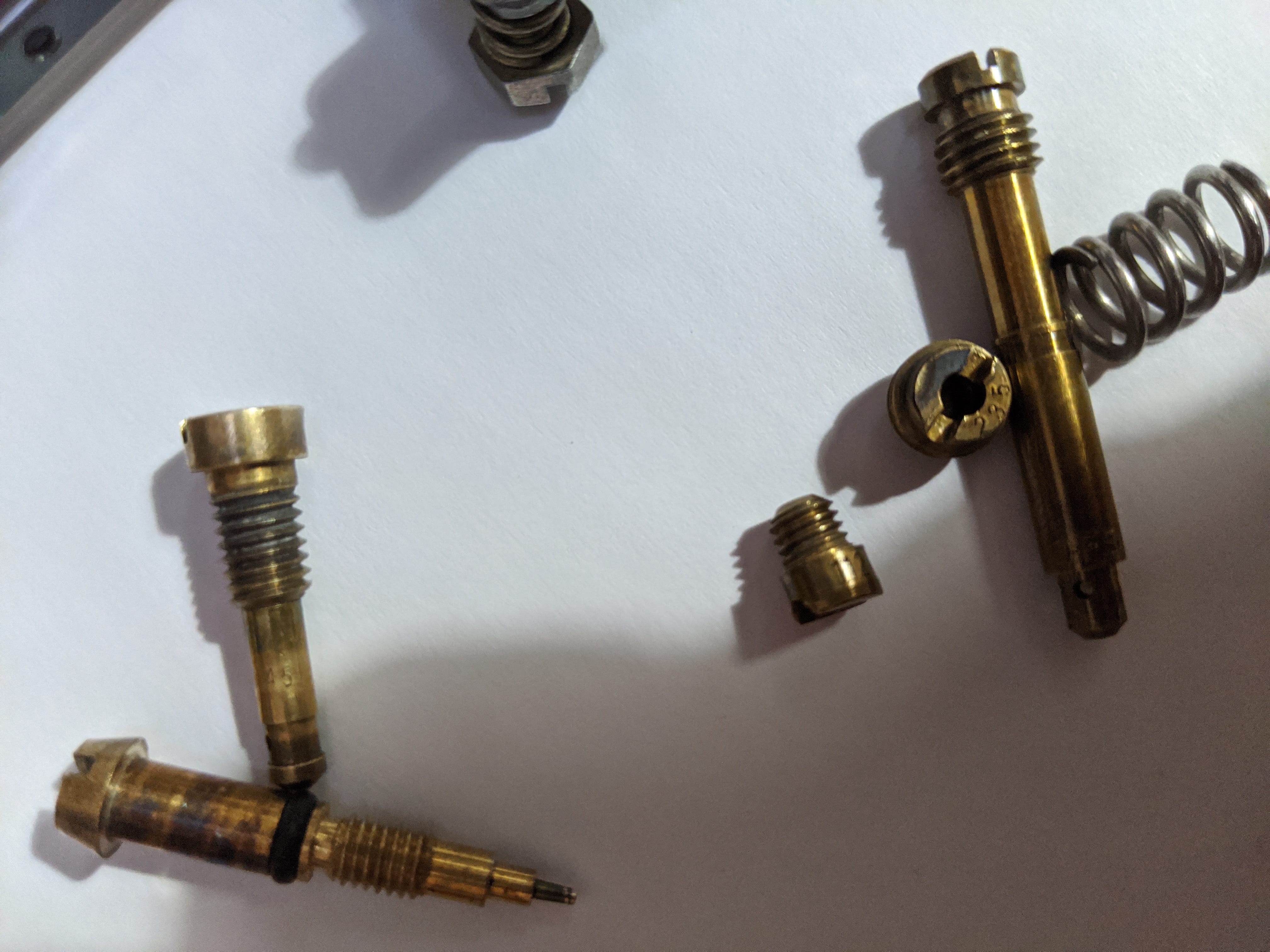

Several pictures of the carb, while assembling it back together.
There is no mesh fuel filter on mine. No place to put it:)
also the cap on the spring of the "choke" is different from most pictures I have seen.
The Venturi tube seem to be made of plastic ( is this possible ? )
I posted a picture with all the number of the metered holes. Might be useful for some one else.
When close the venturi flap partially closes the pinhole at the bottom. Should it partially close or should it be clear from obstruction?

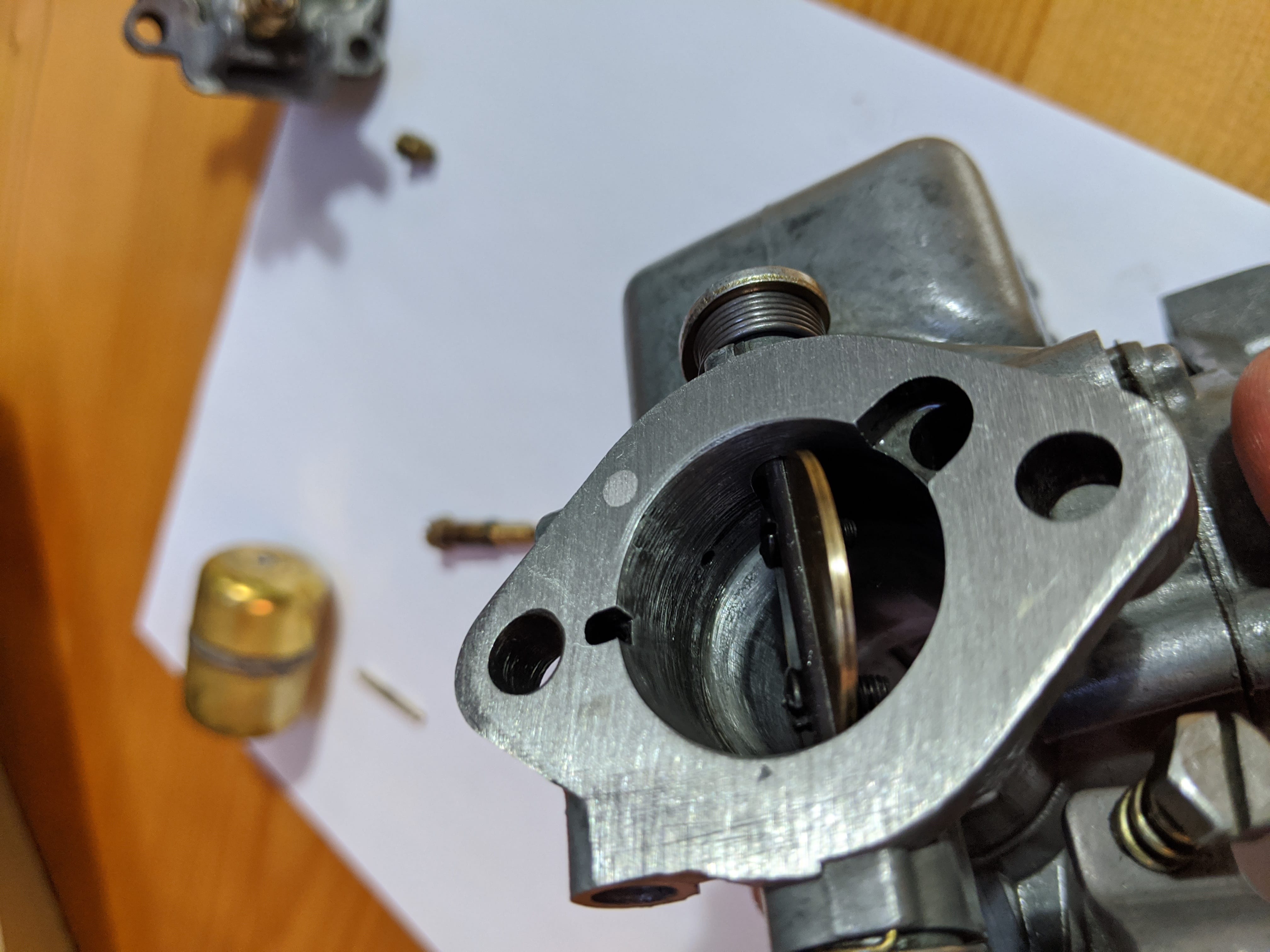

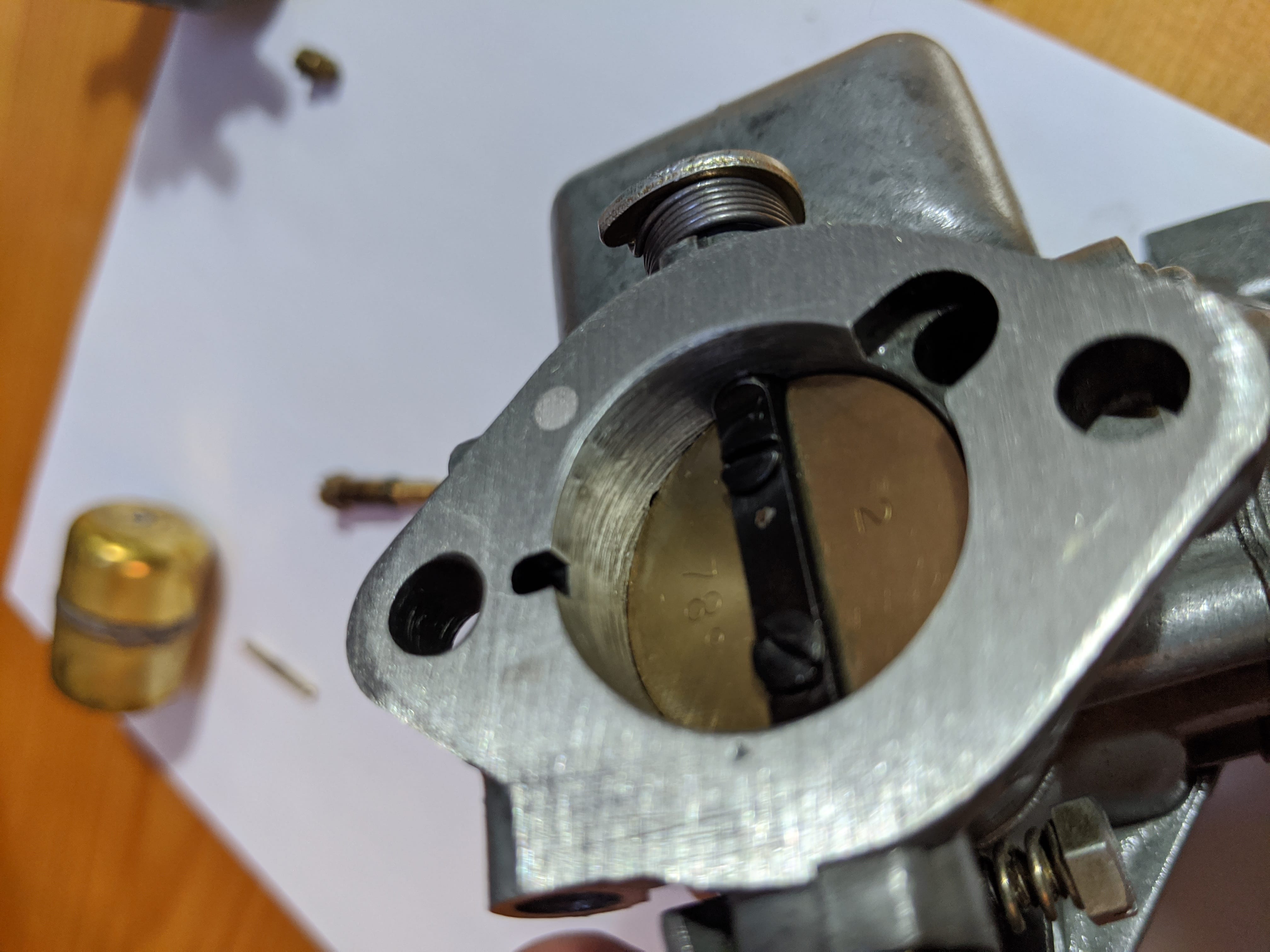

Great job with the pics, very clear. (y)
The venturi flap is usually referred to a 'butterfly valve' or 'throttle plate' in workshop manuals written in English, might help avoid any confusion.
I wasn't aware that you had dismantled the carb this much.... my experience is that people can get themselves into great difficulty when they remove this throttle plate. And into even more difficulty if they bore out worn spindle holes in the carb body to fit bushes but bore the holes off-centre....
Anyway, looking at pic 10 of 12 you've posted, it seems to me that the throttle plate maybe isn't centralised? - with the idle speed screw on the throttle linkage backed off fully, the throttle plate should close off the carb. bore completely. As things stand, there seems to be a slight gap on the right side but the throttle plate is touching the carb bore on the left side. The pinhole that you mention is the where the fuel at idle comes into the carb - it doesn't have to be completely uncovered but it does have to be positioned so that the small amount of air that passes around the throttle plate at idle (i.e. when you turn in the idle speed adjusting screw, it opens the throttle plate very slightly) can cause a depression (vacuum) across the hole, thus drawing the fuel out.
That throttle plate (butterfly valve) can be fitted in 2 ways, one right, one wrong! There's a slight chamfer along 2 areas of the circumference to allow the plate to exactly match the carb bore when closed, it's important it's fitted correct way around and then centralised. To centralise it, back off the idle speed adjustment screw fully, loosen the 2 screws holding the throttle plate, snap the throttle closed a couple of times to centralise the plate (hold the carb up to the light to ensure it's centralised i.e. that no light can be seen around the plate's circumference) then hold the throttle closed and tighten the 2 screws. These screws should have been coated when fitting with a fuel resistant thread locking compound and are usually 'peened over' to ensure they can't ever fall out.
(Iirc, the figure 78* on your throttle plate indicated the amount of chamfer on it's edges? or maybe it's the angle of the throttle plate when fully closed?)
In pic 8 of 12, the idle jet holder can be seen - it's the large brass slot-head screw with the rubber O ring that's partially unscrewed. Some of your other pics show this removed and alongside other carb jets etc. You don't appear to have separated the idle jet from this idle jet holder - the idle jet part (it has 45 on it) just pulls out of the idle jet holder (you might have to carefully use 2 pairs of pliers). It's important that the recess inside the idle jet holder is cleaned along with the idle jet. The idle jet has a large cross drilling and a tiny hole in it's end - this is the metered part i.e. 0.45mm. Cleaning of this jet can be done with the carb on the engine, even at the side of the road - unscrew, separate into it's 2 parts, blow through the idle jet part, hold it up to the light to check that the tiny hole is clear, then reassemble and refit to the carb.
Al.
