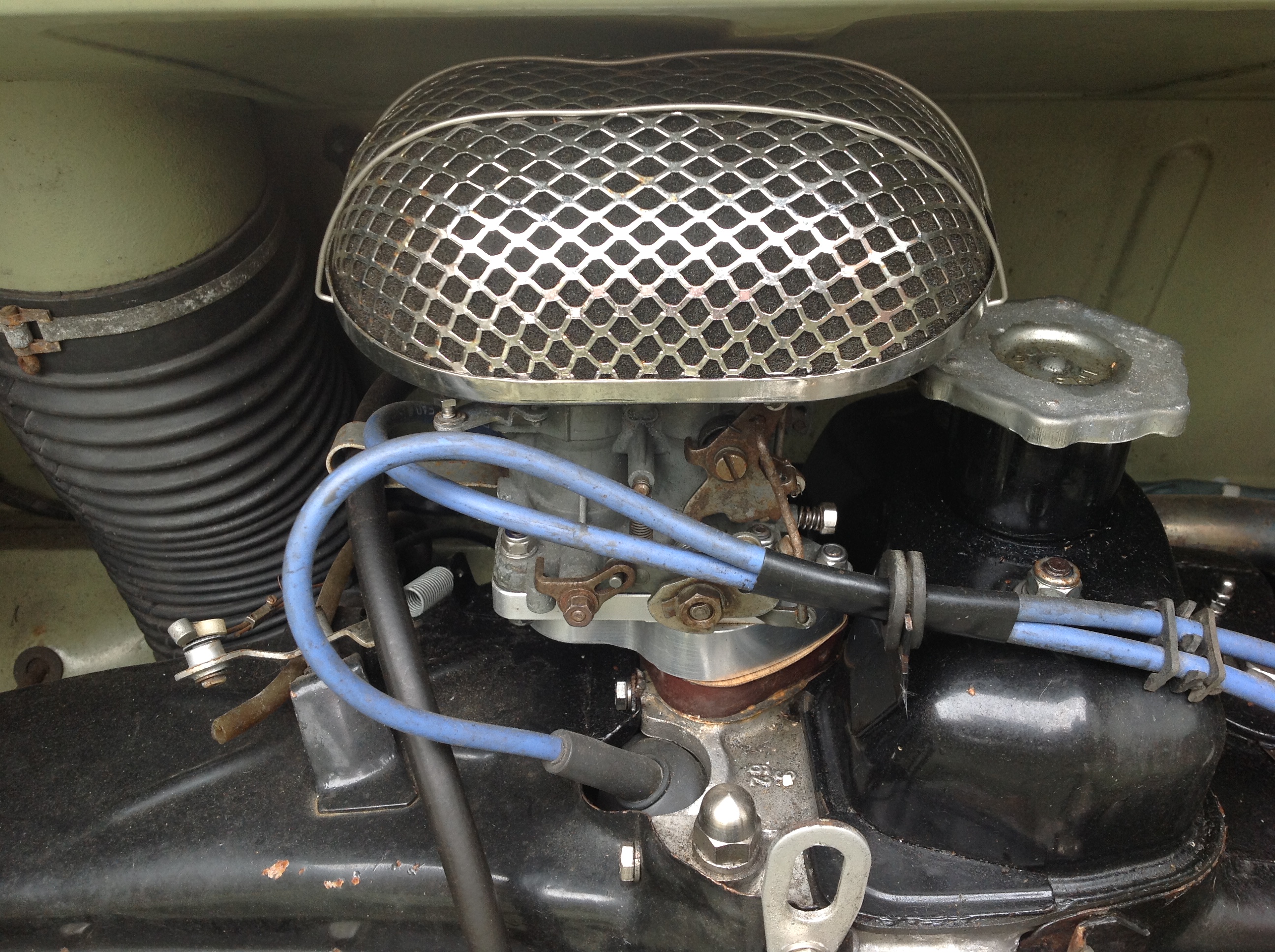

Hi 500n, I wouldn't get too taken by the size of the weber carb in your quoted post, yes it is big, but these carbs are very flexible in their fitment to various engines. The secret is not the size of the carb intake throat (40mm) it's the size of the venturi fitted Inside the throat that matters, these can be as small as some 28-29mm (don't quote me!) and therefore can handle the engines air intake requirements by providing the velocity required for good atomisation and carb performance. One of my engines uses a Solex 32PHH-10 which is smaller and lighter carb with fixed venturi of 31mm. After crunching the numbers I found that 31mm is about as big as I needed to go to for good performance given my engine tune. My other engine of lower tune uses a Weber 30DGF as mentioned in the thread, this does indeed give good performance with remarkable fuel efficiency at the same time. One of the reasons I use these carbs is the availability of parts and the common fitment to other Fiat/Italian cars.
