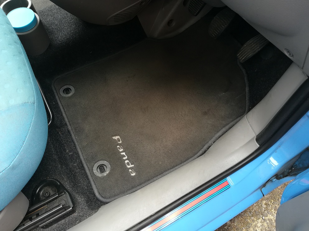

Heh - maybe we have each other's mats:) My mats have sockets but no pegs in the carpets to attach to!
That said, the mats don't slide around at all - they have a textured underside that grips to the carpet pretty well.

The mats we have are the same as in the photo above posted by rmjbn1; they used to stay out but over the years seem to have lost their grip. Maybe I’ll try some self adhesive rug gripper stuff rather than screw into the carpet.

After getting totally bamboozled looking at all the various options on ebay I took a punt on some self tapping clips that are meant for Audi / VW Skoda etc. However, they have an oval shaped fitment that happens to fit the holes in the Panda mats perfectly.
Took literally seconds to fit. Used a bradawl to puncture the carpet then simply screwed the self tapping plastic screw in. Then you just turn the top cap through 90 degrees and bingo, all done!
