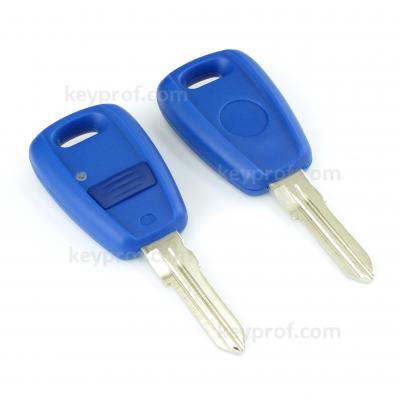

Is your key anything like this?
No, it is the older blue key
