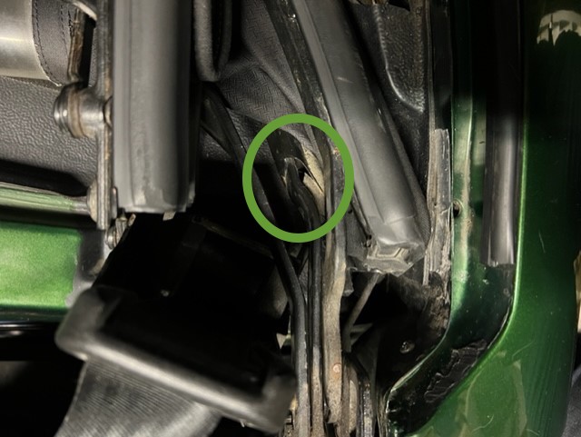

Scissor sharp frame edge:
In the picture below, near a frame hinge, inside the green circle you can (hopefully) see a sharp metal edge on the frame that cuts through the canvas when pinched stuck. The light grey material on both sides of the sharp edge is old foam plastic that has been nicely cut in two. I have two holes/cuts on the soft top thanks to these edges. How do you keep the canvas from being pinched there and how did you deal with the sharp edges?
(With the soft top mounted to the frame and the frame mounted to the b, it is not all that easy to access the area.)
For (real fiberglass) boats you have edging(?), but I don't think one of those would stay put with regular up/down movement of the soft top. The minimum edge width is 1mm, I believe the metal is thinner on the barchetta soft top frame. Perhaps glue?
