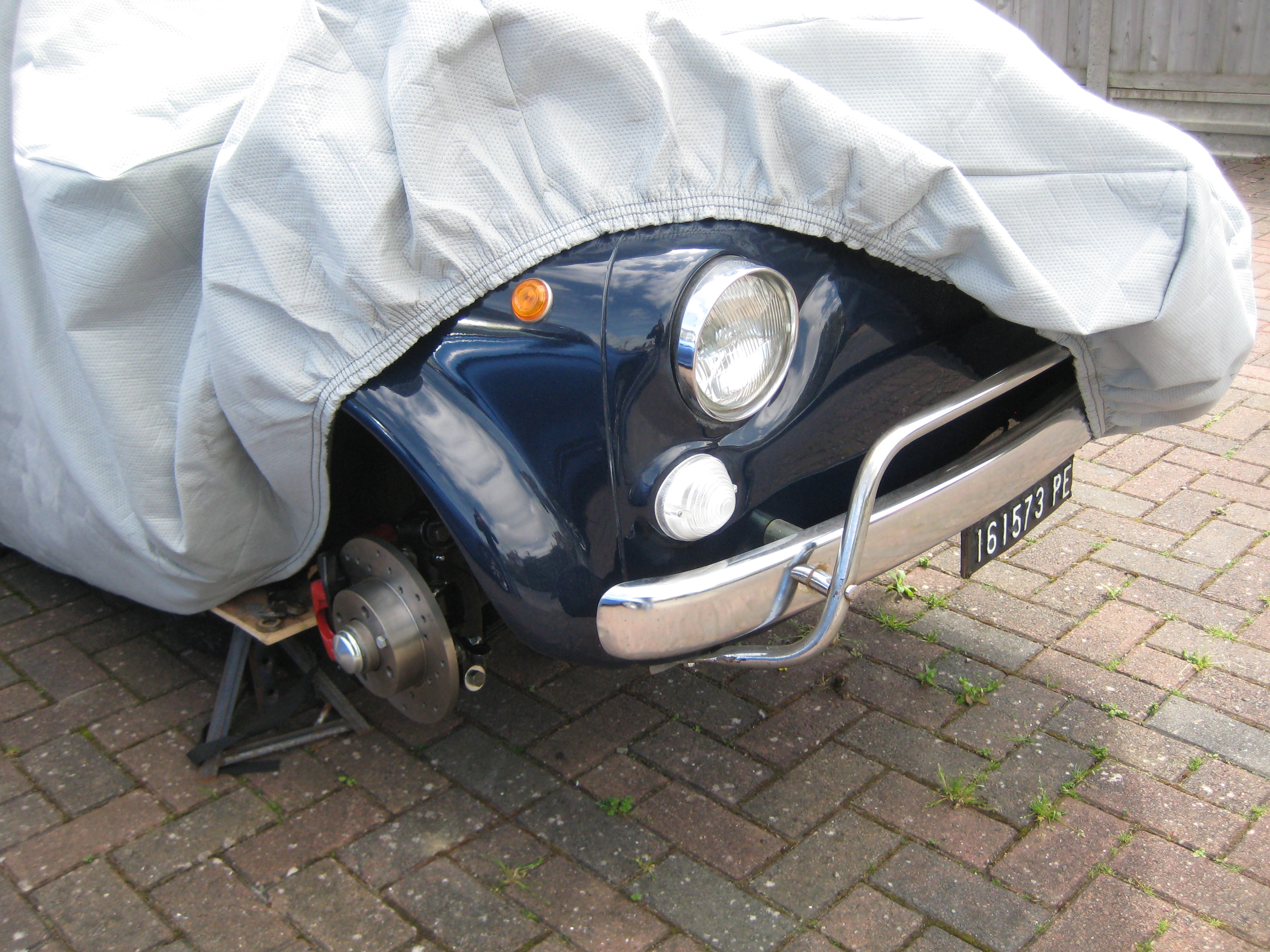

You can see it in Steve's photos Andrew. There is a heavy-duty adaptor plate which bolts to the swivel-axle in place of the drum back-plate. The caliper bolts to this plate. The discs are bolted through to the 126 hub which is a separate item from the drum in the case of the later 126.
I have read elsewhere that, depending on which calipers you use, there can be issues with wheel sizing. I have also read that some kits are made with modified components which may mean that supplied pads can be cut-down versions which aren't just available off the shelf.
PS. I see Steve already said most of that....

Only other piece of advice I can give Andrew is:- confirm absolutely that the are suitable for 12in wheels.
If you are going to build up a suitable disc brake set up on the 126 stub axles with the Cinquecento callipers then you need the 126 hubs and bearings etc so you can mount the pcd adapters. Steel ones are heavy but I would avoid the aluminium ones. For the brakes you will need to have a standard disc machined down to 210 mms diameter, the calliper carriers will require modification to avoid rubbing on the disc and the disc pads themselves will need to be ground or machined away for the same reason. If you look at the red set above you can see that the bar across the front of the calliper has been cut away.

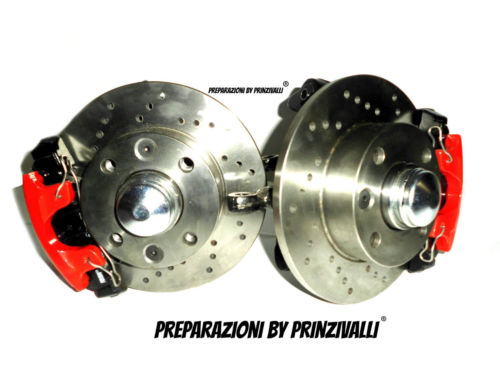

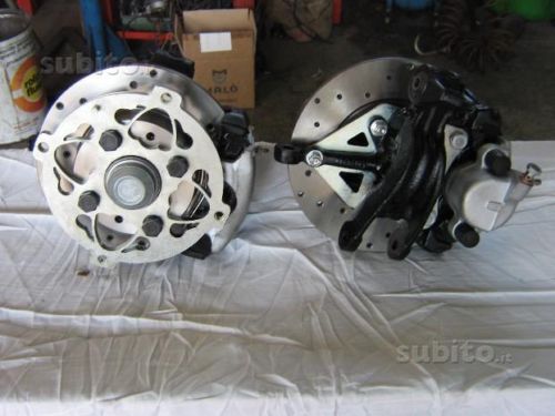

Now this disc conversion...I'm awaiting confirmation from two suppliers that the product they offer fits over 12" rims - both in Italy - both yet to respond.......
one is:http://www.ebay.co.uk/itm/COPPIA-FRENI-A-DISCO-ANTERIORI-FIAT-500-EPOCA-/321720091443? looks great with adaptor included
The second one :http://www.ebay.co.uk/itm/331244292087?_trksid=p2055119.m1438.l2649&ssPageName=STRK:MEBIDX:IT
requires adaptor plates at 50 Euro's
Failing these its the ones Steve found - 70 pounds or so more expensive...;)
