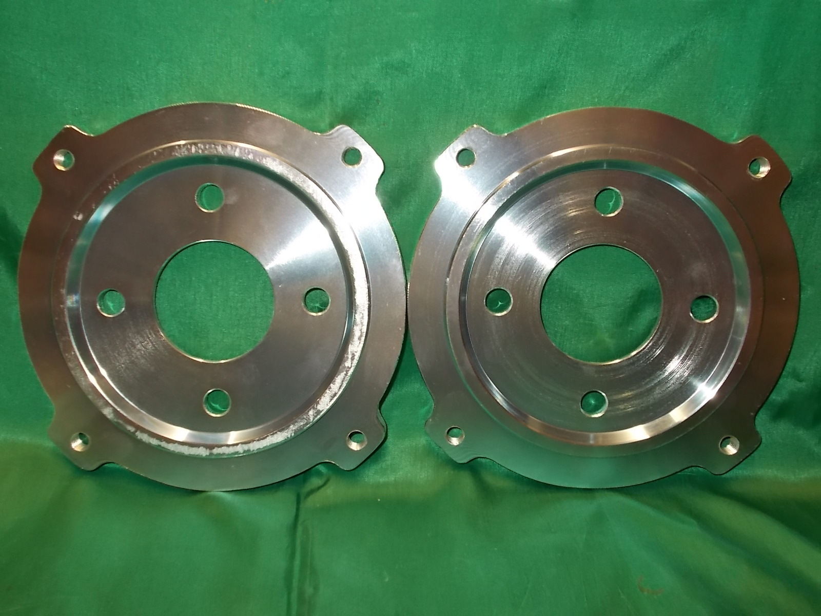

Andy;
Why not just fit adaptor plates for the time being? When I purchase my 500 it already had 126 hubs (98pcd) but the previous owner had bolted adaptor plates which allowed him to fit 190pcd alloys. Unfortunately, when I was made an offer too good to refuse for my alloys, the adaptor plates went with them. Ricambio International sell them (in pairs, complete with bolts)--they are listed in the 'Classic Fiat 500 modifications' section. These bolt onto the 126 hubs, but allow you to fit original 190pcd wheels. They do increase the track a bit (the thickness of the plates) but if you are running standard suspension this will not affect you.
Hi Tom
- I had no idea that you could fit spacers over the drums....
I have 190 pcd drums and two lug 500 backplates - so does the 98 pcd stub not need a 98 drum and the different 3 lug backplate?
Andrew, if you are getting the 126 front swivels, won't you need matching back-plates, hubs and brake drums?
It looks like the adaptors for the 500 wheels will then bolt through the 126 drums into the hub at 98mm spacing..
