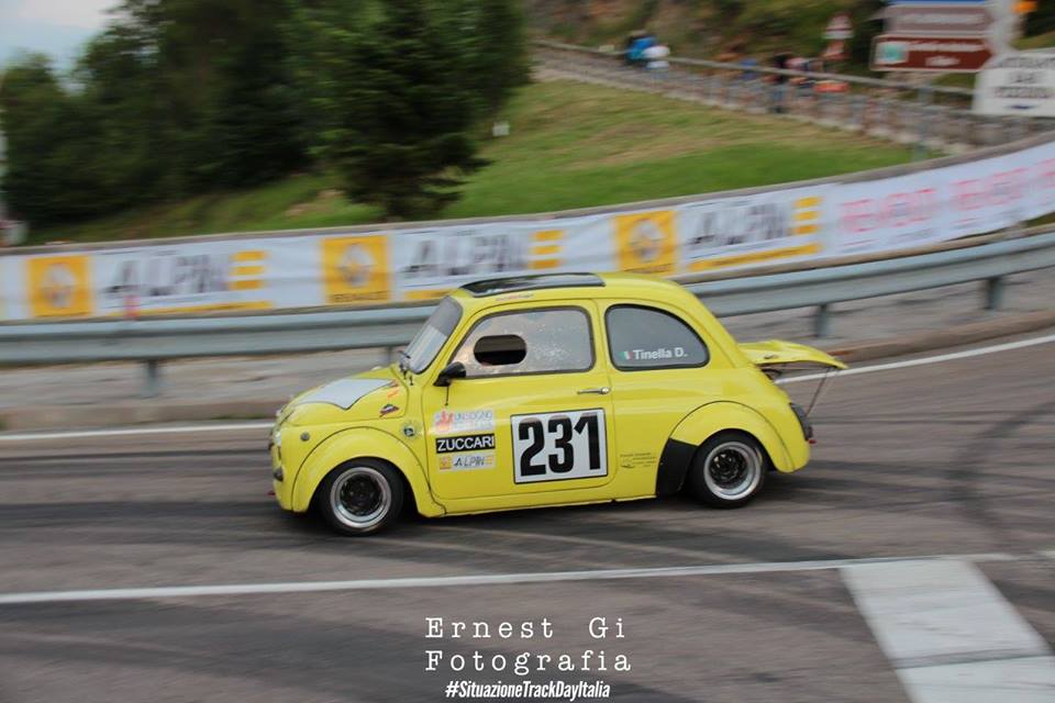

The idea is still possible - a few comments that disagreed - but then who'd paint it blue and banana yellow????
That looks like fun!
They look quite different on 10" rims/shirt buttons.
I will have my engine lid closed as I have a modified 500 / 600 amalgam - but mine will do some track / rally work
