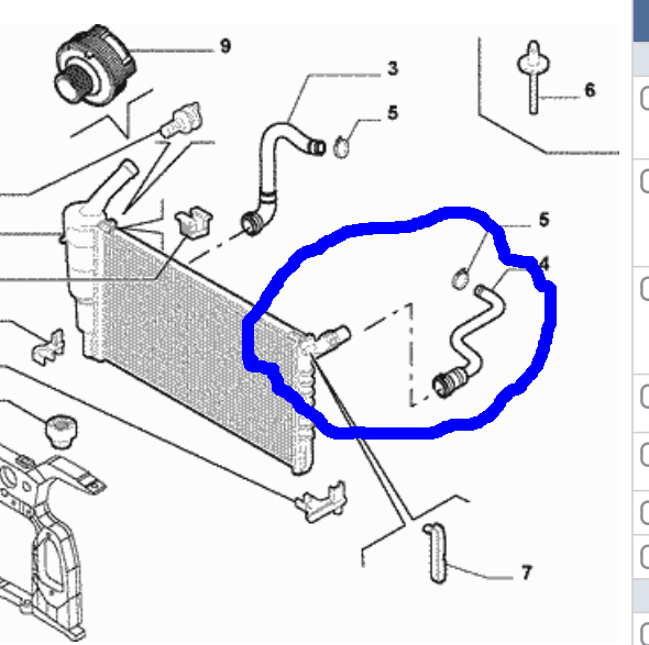

start your car and put you hand on this hose it should stay cold for at least 3 minutes
It will confirm or eliminate one possibly within a few minutes

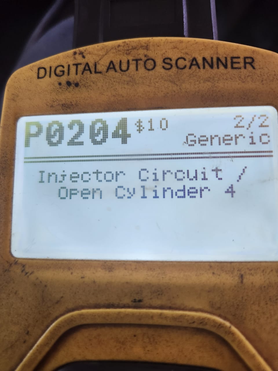

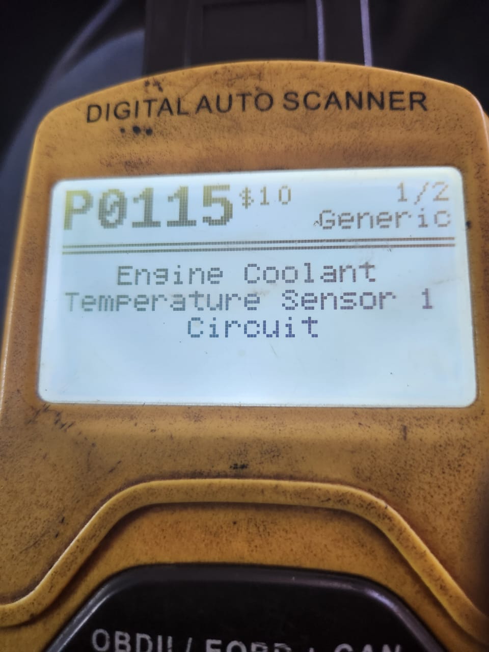

I thought I would give n update on this. I took the car to a garage and the guy did a scan with an ODBII scanner. It returned two error messages i.e.
  • P0115
  • P0204
However, the guy said that in spite of the error messages, the car seemed fine, so he cleaned out all the bits that could be cleaned. I guess I will know on my next long journey if all is in order.

Check the top hose as per the post above
Still sounds like the thermostat
P0115 is the error code you get normally
Let’s hope the injector circuitry was just a knocked wire while checking things out.

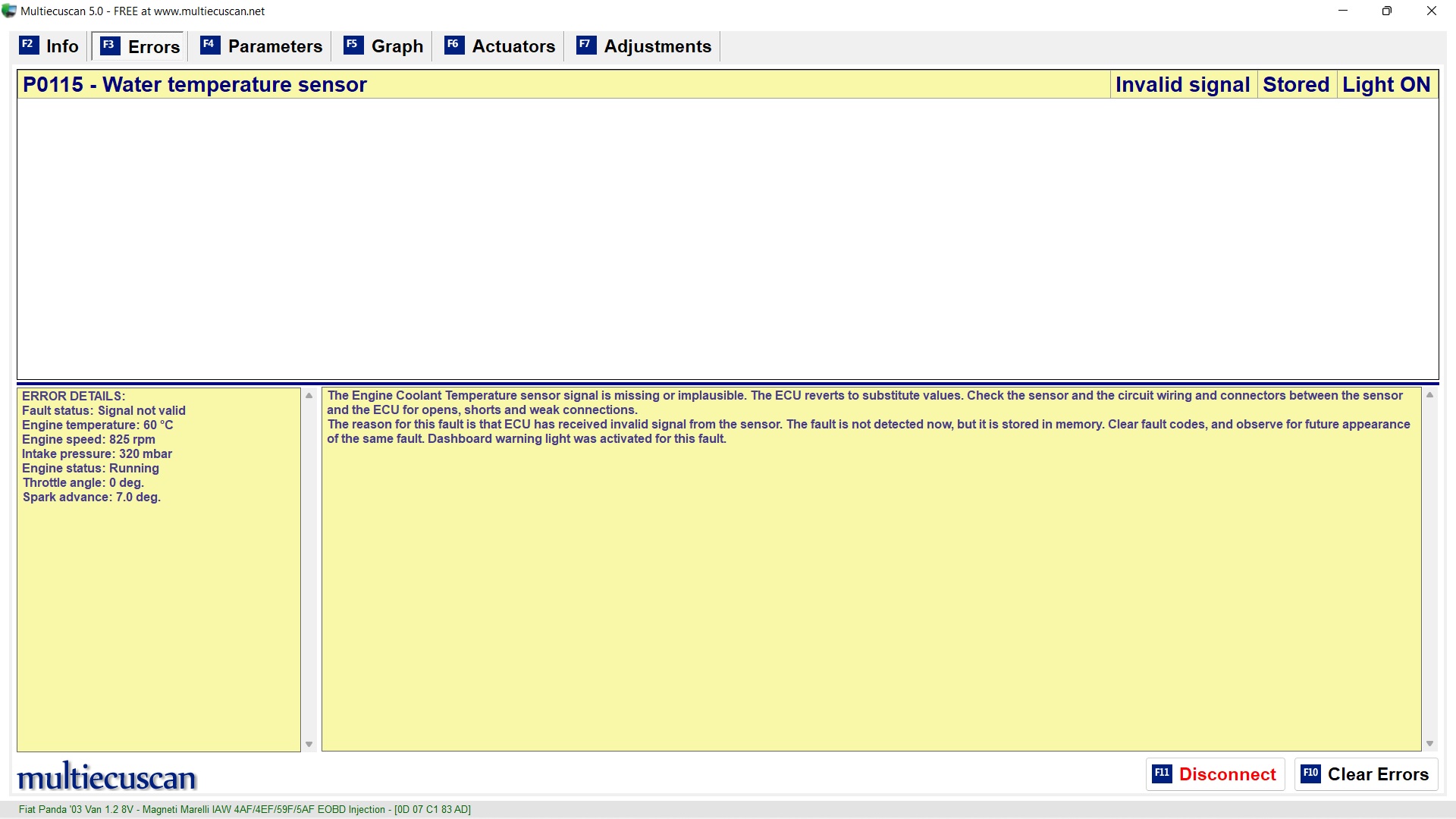

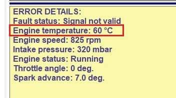

Just had a chance to connect to MultiECUScan, P0115 DTC, and shows recorded coolant temp as 60deg c
My fault for being too lazy to change the thermostat and coolant. Will get on with it.

Yep sounds like the same
Should have mentioned that P0115
Self clears after so many starts and stops without an error
Maybe 5 or 10 can’t remember now.
Just in time to get the heaters blowing hotter for winter.
