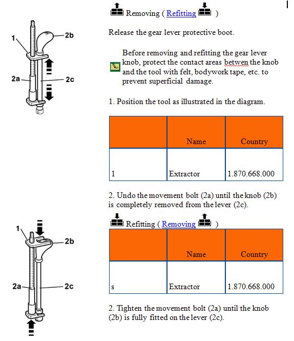

can anyone help,i tried removing the shift know out of my 1.6 5 door stilo but the top came off and a plastic is on the lever,how do i remove it?(sorry for my bad english is not my native language

I assume you mean the gear knob? If so, there is a special tool to remove it.
