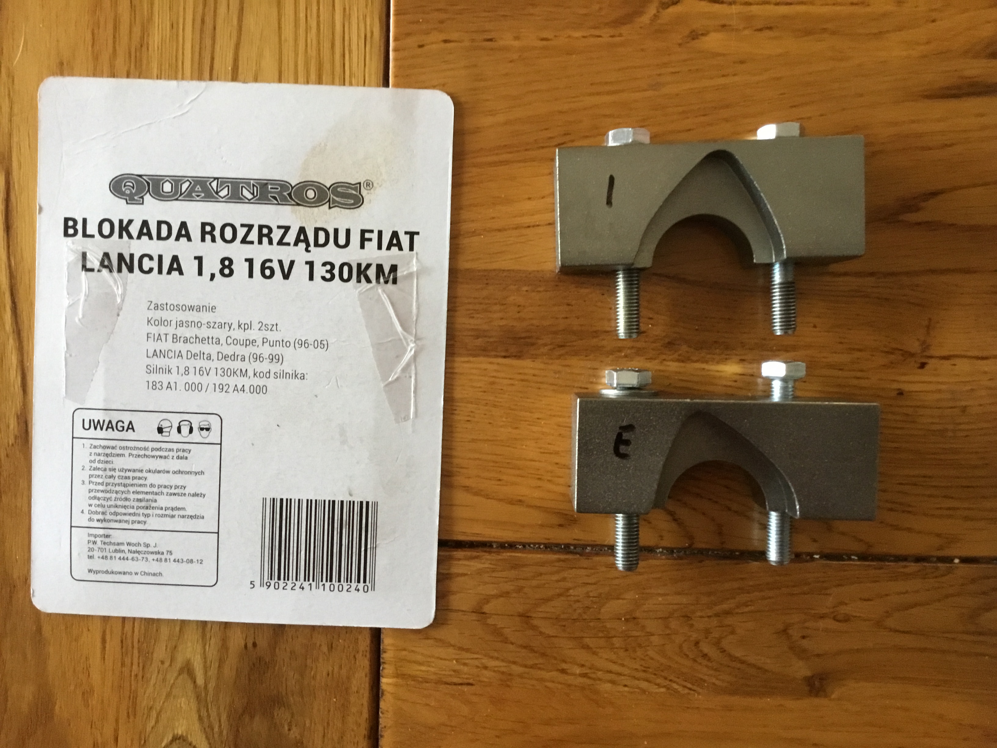

And ... i'm 99% sure those ones in the picture are the intake cam ones !?
Phil sorry, I can't help myself, just to be sure: here you see a picture from both the M1 (grey) and M2 (gold) exhaust cam shaft locking tool.
Easier to identify: the M1 locking tool (183 engine) has the top at half past 12 and the M2 locking tool (188 engine) has the the top at exactly 12 o'clock.

For out MkII, 2005, Engine 188A6.000. I bought the offical Fiat cam lobe timing blocks P/N: 1870697000/1 @ 2 degrees and 1870697000/2 @ 3 degrees
The intake cam shaft locking tool (what a word): with "A" (for Aspirazione = intake) engraved.
The outlet cam shaft locking tool: with "S" (for Scarico = exhaust) engraved.

Just to be sure my locking tools for the 183 M1 engine have the following markings
G1, A-2-CIL (inlet because ‘A’) and G2 S-3-CIL (exhaust because ‘S’).
S130 can you confirm I have these correct? Thanks
