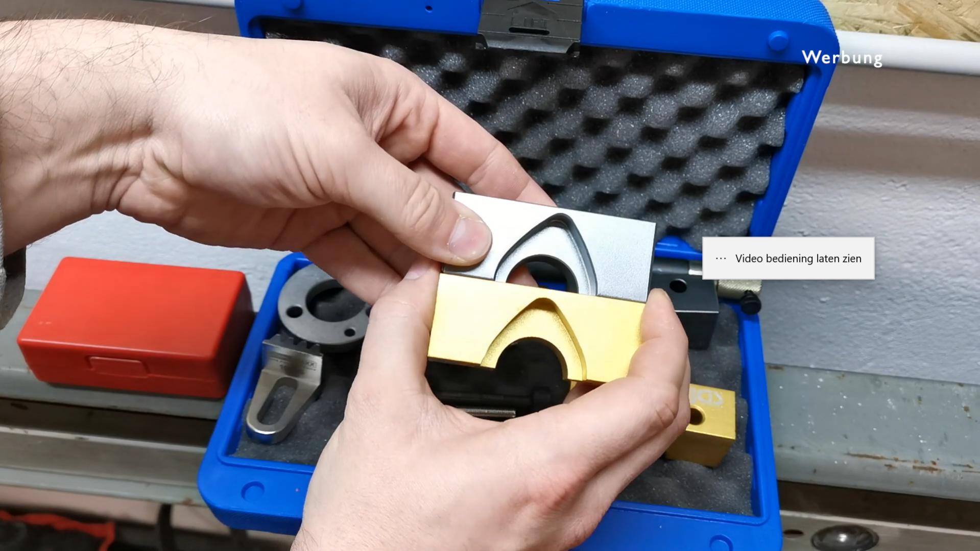

Phil sorry, I can't help myself, just to be sure: here you see a picture from both the M1 (grey) and M2 (gold) exhaust cam shaft locking tool.
Easier to identify: the M1 locking tool (183 engine) has the top at half past 12 and the M2 locking tool (188 engine) has the the top at exactly 12 o'clock.
Regards,
Frank
