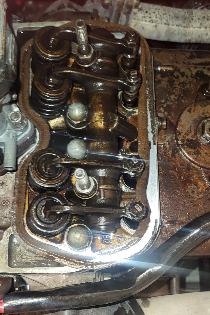

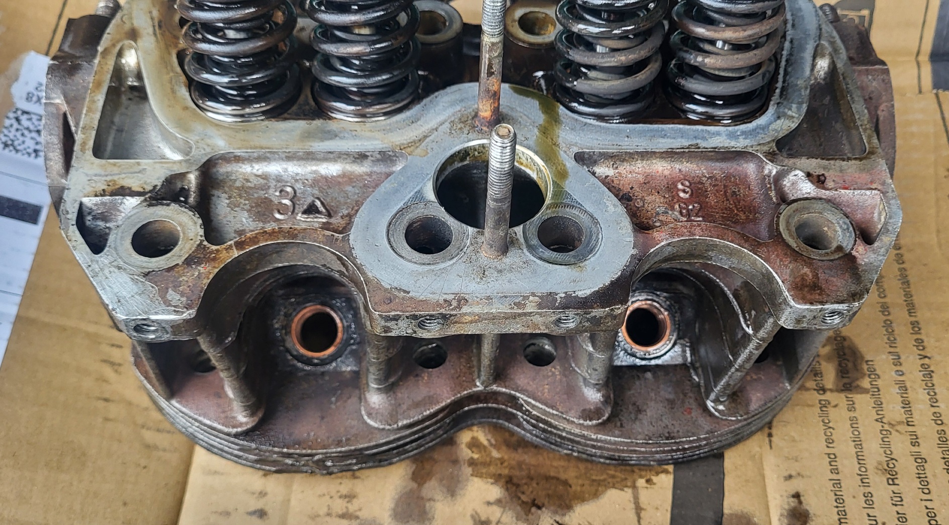

I would have it brought back to the correct specification of 12 x 1.25mm thread. Obtaining 14mm plugs can be a bit of a pain---they are not very common in the automobile world. Have you got an engineering company near you who could fit an insert rather than helicoil?The RAC man suggested tapping the head to M14 x 1.25 and fit a larger spark plug, rather than have an M12 x 1.25 helicoil fitted. What would you do?
