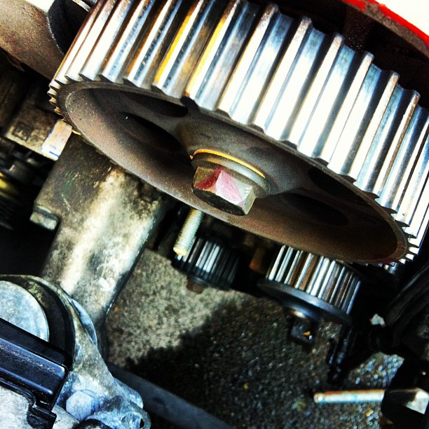

Ok, so did the cam belt, tensioner and waterpump today.
Thank **** I didn't waste my money on those stupid tools :rolleyes: Absolutely no need for them replacing the belt on an already timed engine.
Exactly the same as doing an 8v engine except that the tensioner is sprung, which was a bit fiddly but I managed and its tensioned perfectly with no excess slack on any part of the belt. Buying the tensioner tool would have saved me approx 10 mins thinking how to tension the belt without 3 arms. A tiny little allen key keeping the spring mech in position using a breaker bar to apply the tension and a spanner to tighter as I did it, did the job perfectly.
Timing is spot on as before.
Thought I would pop these in here too ...
