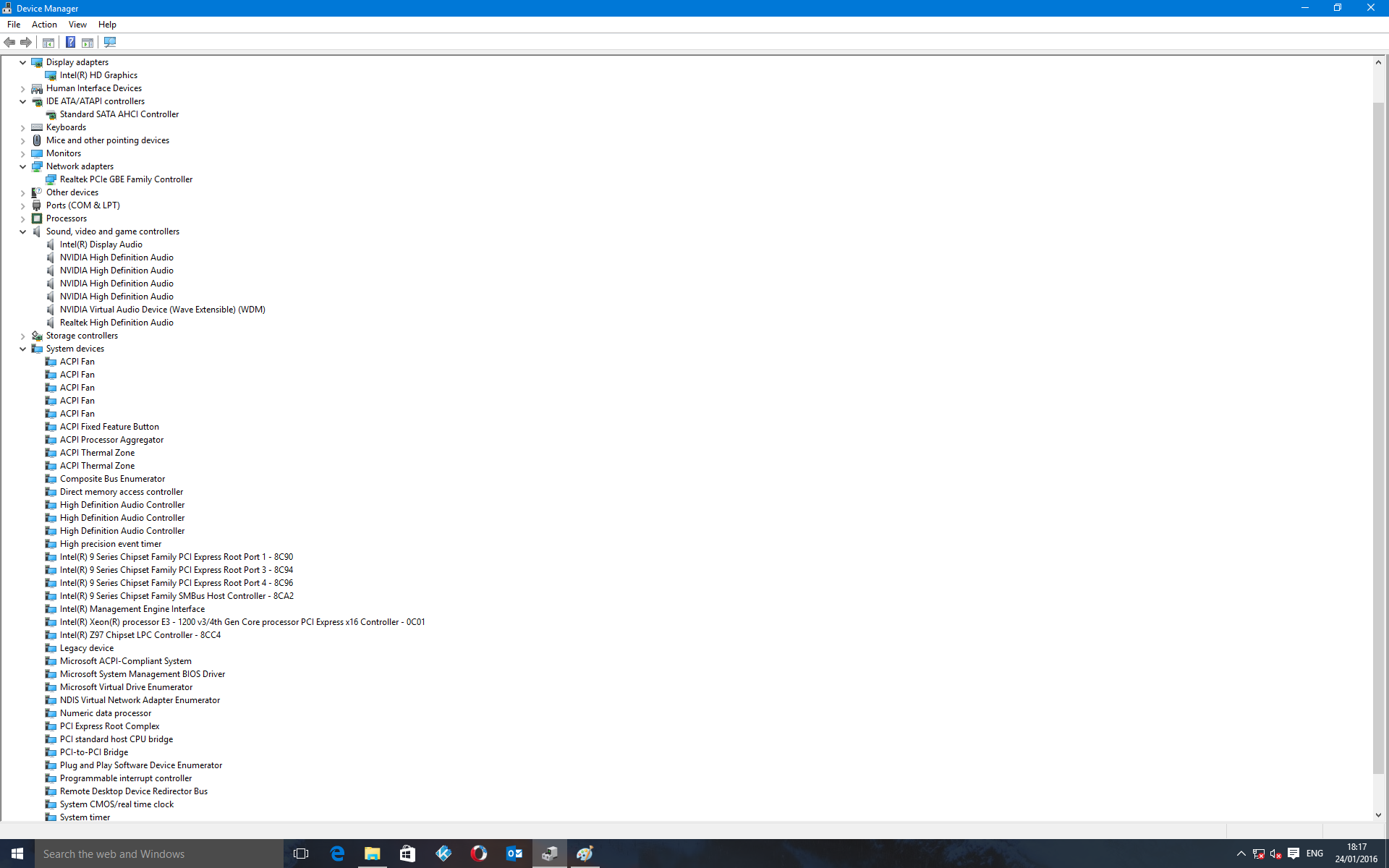

screen grab of device manager attached.
Latest bios installed.
I tried to install the latest graphics driver from usb dive but this failed.
There is one unknown item on the device manager. Dont know what,but it is tagged to PCI bus 1 if that helps.
It has had a full restart,hung for around 5 minutes before completing the cycle.
ta

ok, can you download the latest drivers from your mobo manufacturer and copy them to your ssd, disable any antivirus and install them all, reebooting properly each time.
also try another ethernet cable and another port on your routerc/ modem first.
and finally, you have most of the drivers installed allbeit maybe not latest... the sata ahci is running a generic driver as you can see by its name but anyhow the nic is installed and looks ok, as for the unknown driver, right click and hit proprties then check your tabs in properties and you will find one with a drop down list, look for device id, highlight the pci ven string and copy it, search google by pasting it in and you will probs find out what device it is
hope this helps, might even need as full reinstall to be sure, doubt the NIC has died onboard.

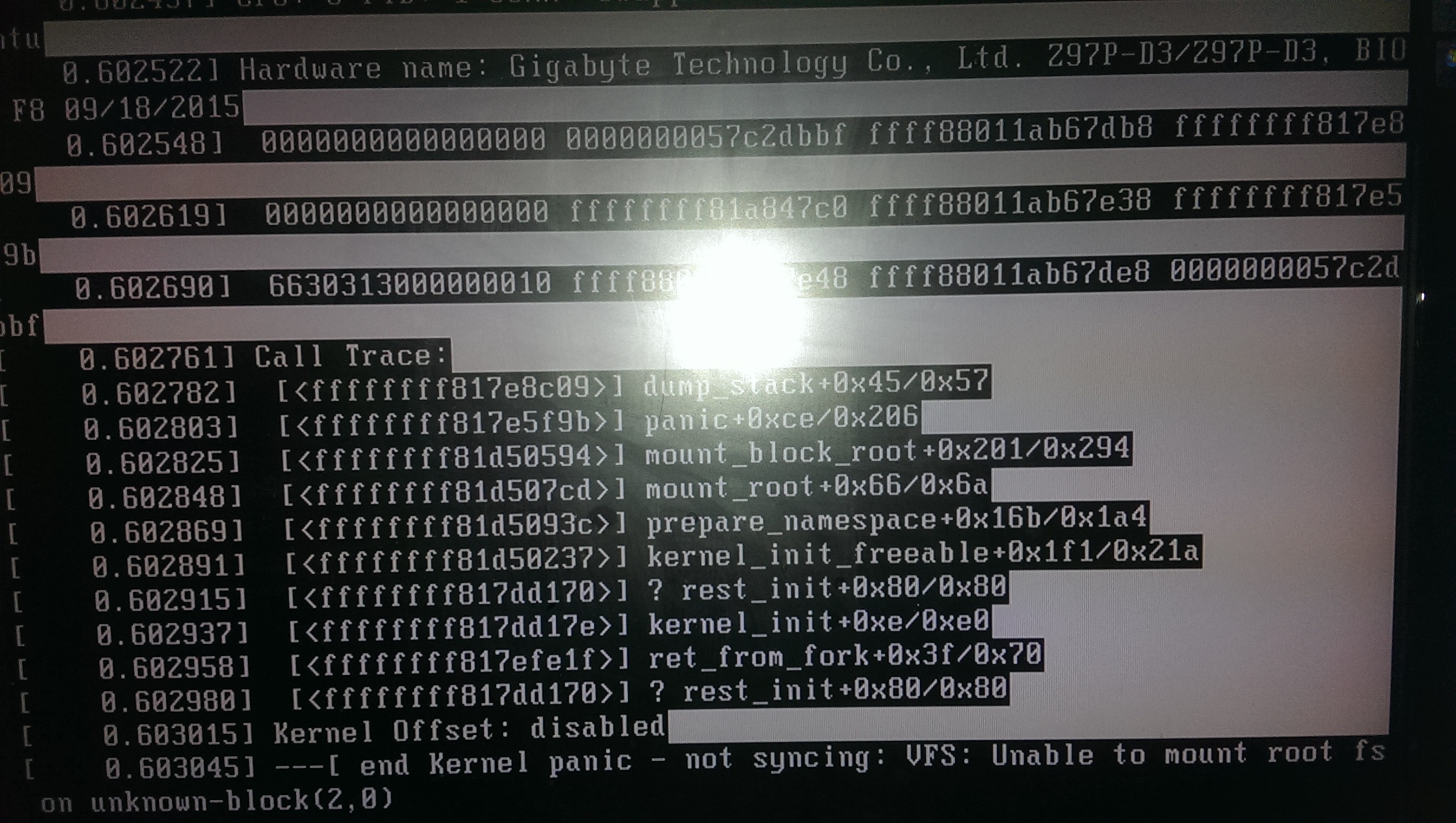

Tried booting Ubuntu from USB,got the splash screen offering install,boot from USB etc and before I could select anything, this happened.
This is with all hard drives disconnected except the original W10 SSD.

right,Ubunto 15.10 is running fine off the usb. Has network and sound :D
However it seems to be sticking at preparing to install?
Tried it with and now without 'install updates/3rd party software'
Doesnt seem to be moving on though?
EDIT: just rebooted and the PC booted to the Ubuntu install menu and then presented the same/similar error page. accompanied by 2 separate mobo beeps

Linux is now crashing out every time on boot now.
Boot has been slow too with beeps and no video.#I had assumed it was the switch to onboard,so set the bios to onboard only.
No change.
I have just rebooted again from the linux error page and had a few beeps and am sitting with a black screen.
just timed it from cold boot.
1 minute 40 seconds for a beep and display of the linux install options the on the screen. followed by a beep,followed closely by another beep as it brings up the linux error.
