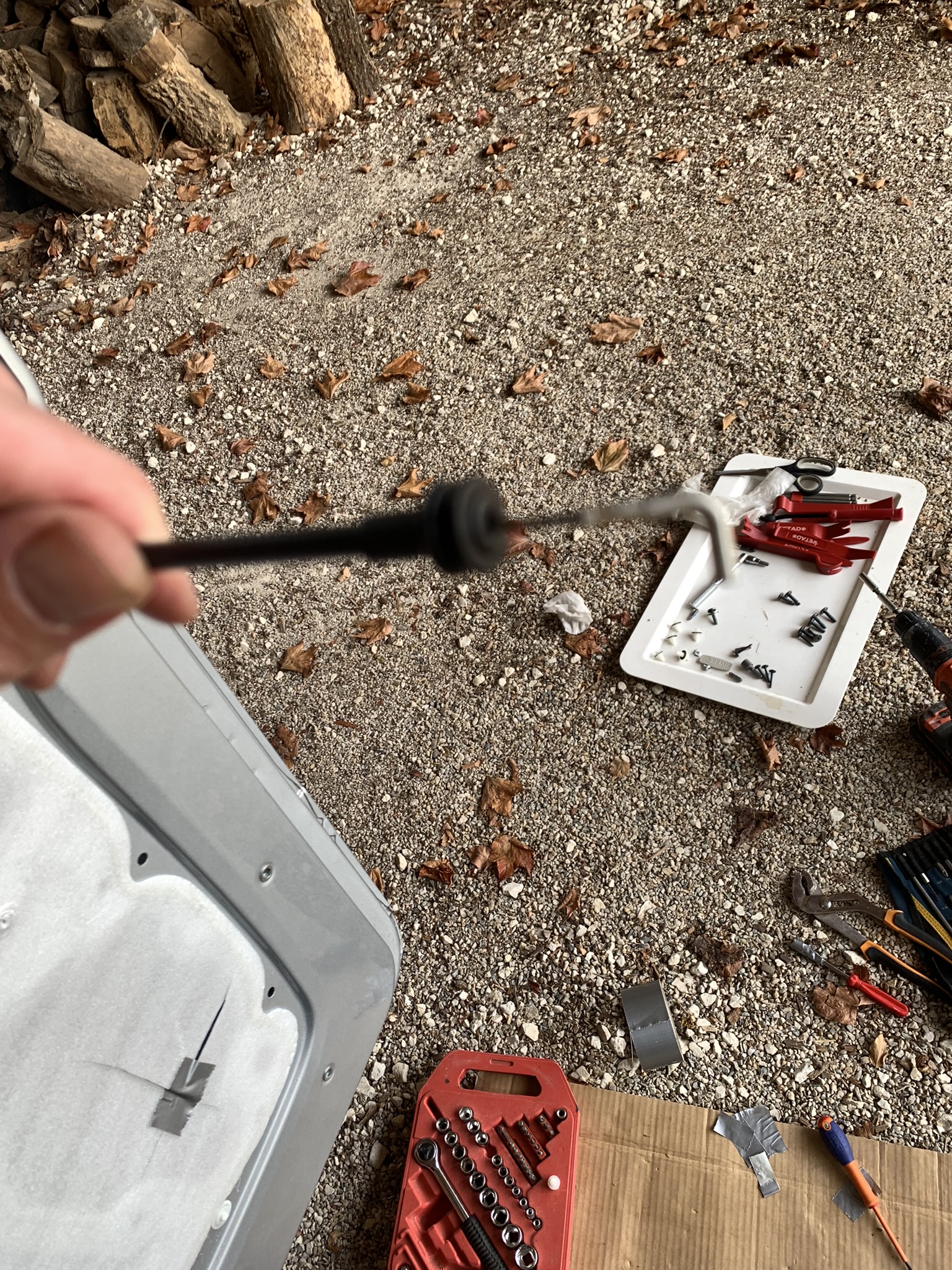

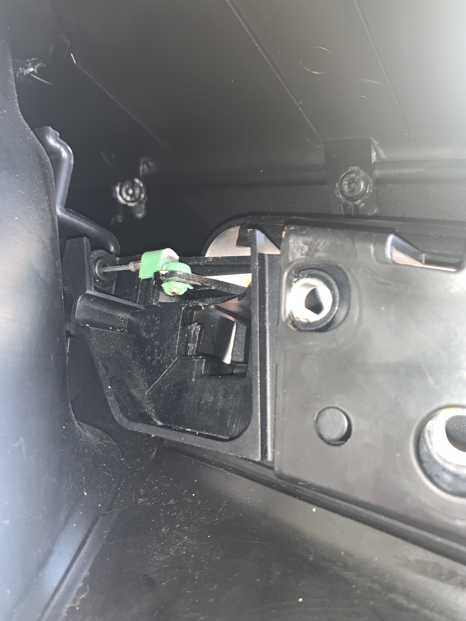

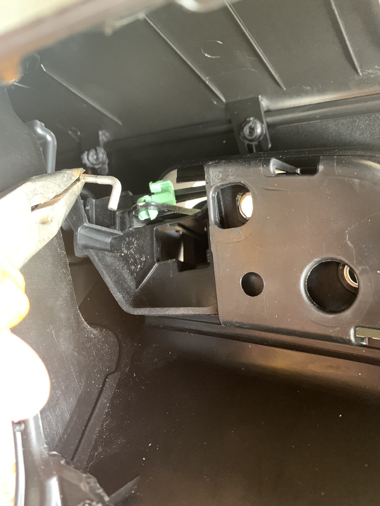

Hi does anyone know how to remove this little green clip so I can remove the cable from the handle to the door lock, it’s a 2018 fiat Ducato but I’m hoping it’s a general type of cable clip, it’s got me baffled and I’m one clip away from removing the door lock but don’t want to break it.

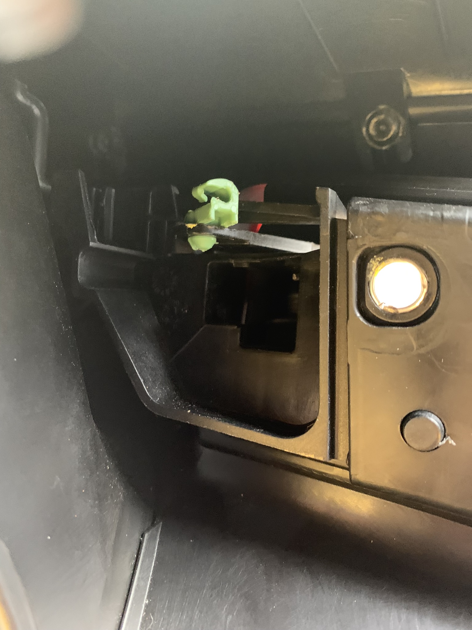

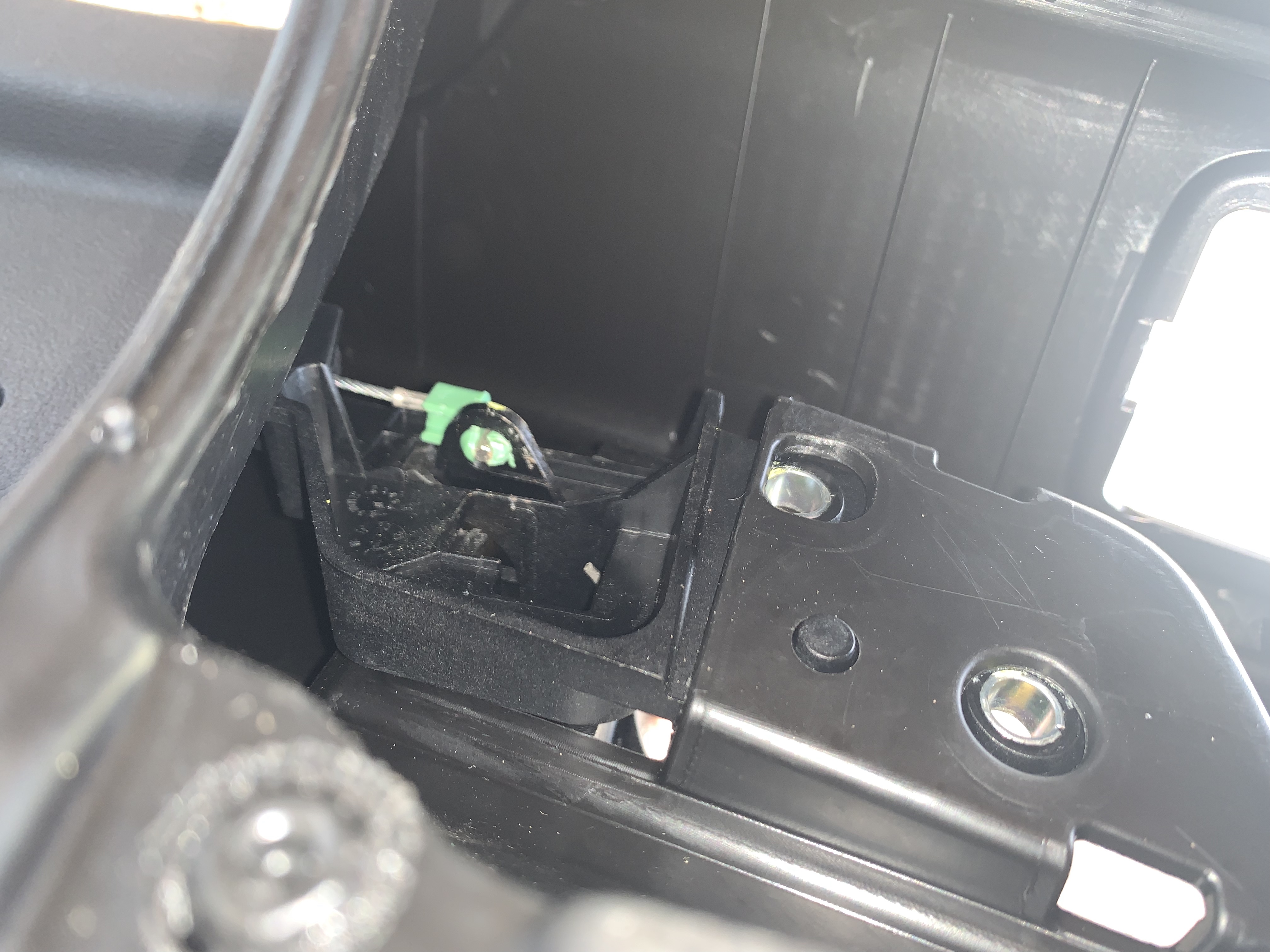

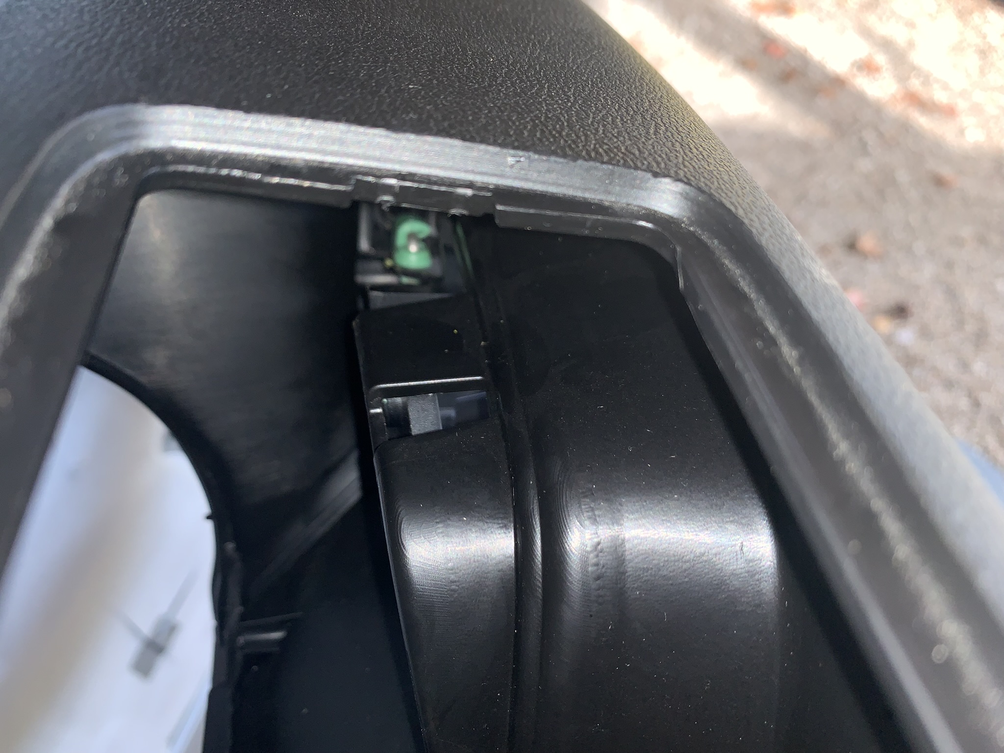

It’s so hard to tell as it’s within the plastic frame work, I might try gently easing it anti-clockwise and see it the top green bit pivots off anti-clockwise as you suggest 👍
Just found the same clip on eBay , I’m stead of trying to clip the top off you “ turn” it anti lock wise and it should pop out of the open edge, going to try now

Done 😊 easy when you know how 😓 thanks for the help 👍
