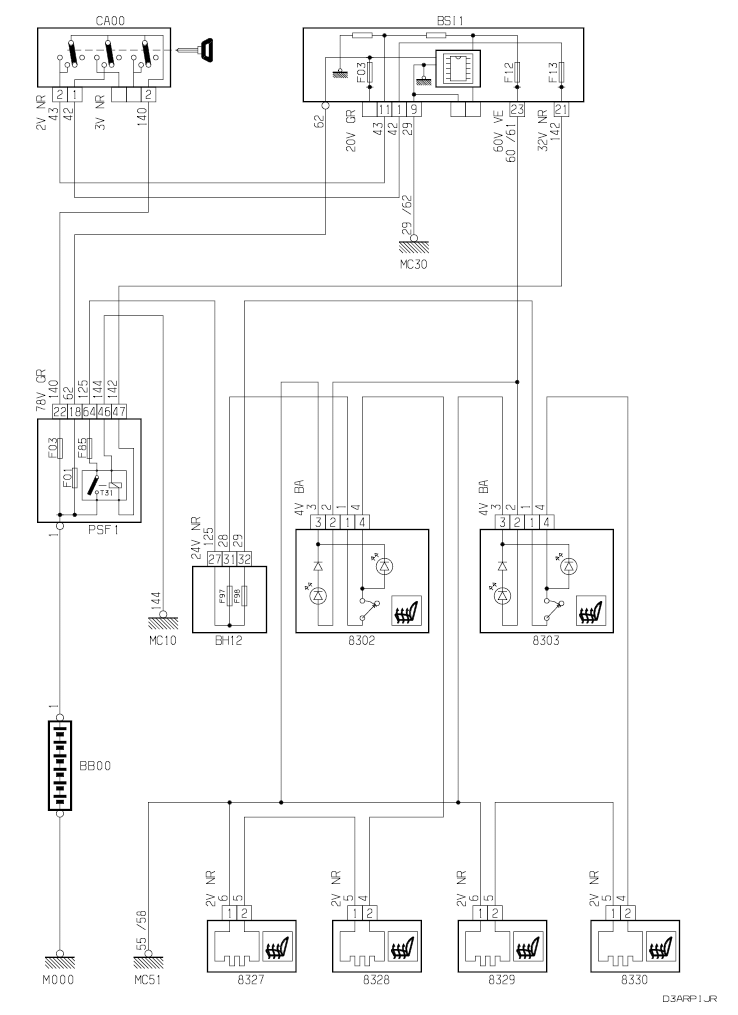

Weird problem! If I leave my Qubo cabin blower fan on settings 1-4, the fan keeps running continuously after I have switched off the ignition circuits and removed the key. This drained the battery overnight last week after I had the air conditioning re-gassed (possibly not connected?) - the first time I became aware of the issue. There is no problem if I turn the cabin blower off before leaving the car, so I hope I don’t forget to do this. I’m carrying a spare battery just in case.
Any suggestions on what might be the cause of this problem? Could it be a relay failure somewhere? Surely the blower circuit should only be live when the ignition is on?
Thanks in anticipation.
i would need a wiring diagram of the Qubo to pinpoint the problem, right now my guess would be a relay problem but that's hard to check without a wiring diagram.....
you can also search for a workshop manual for Qubo - Nemo or Bipper which are basically the same cars....
When you found or bought one post the download link and i will try to help you solve this problem....
Thanks - I found these on Peugeot Forum for the Bipper:
