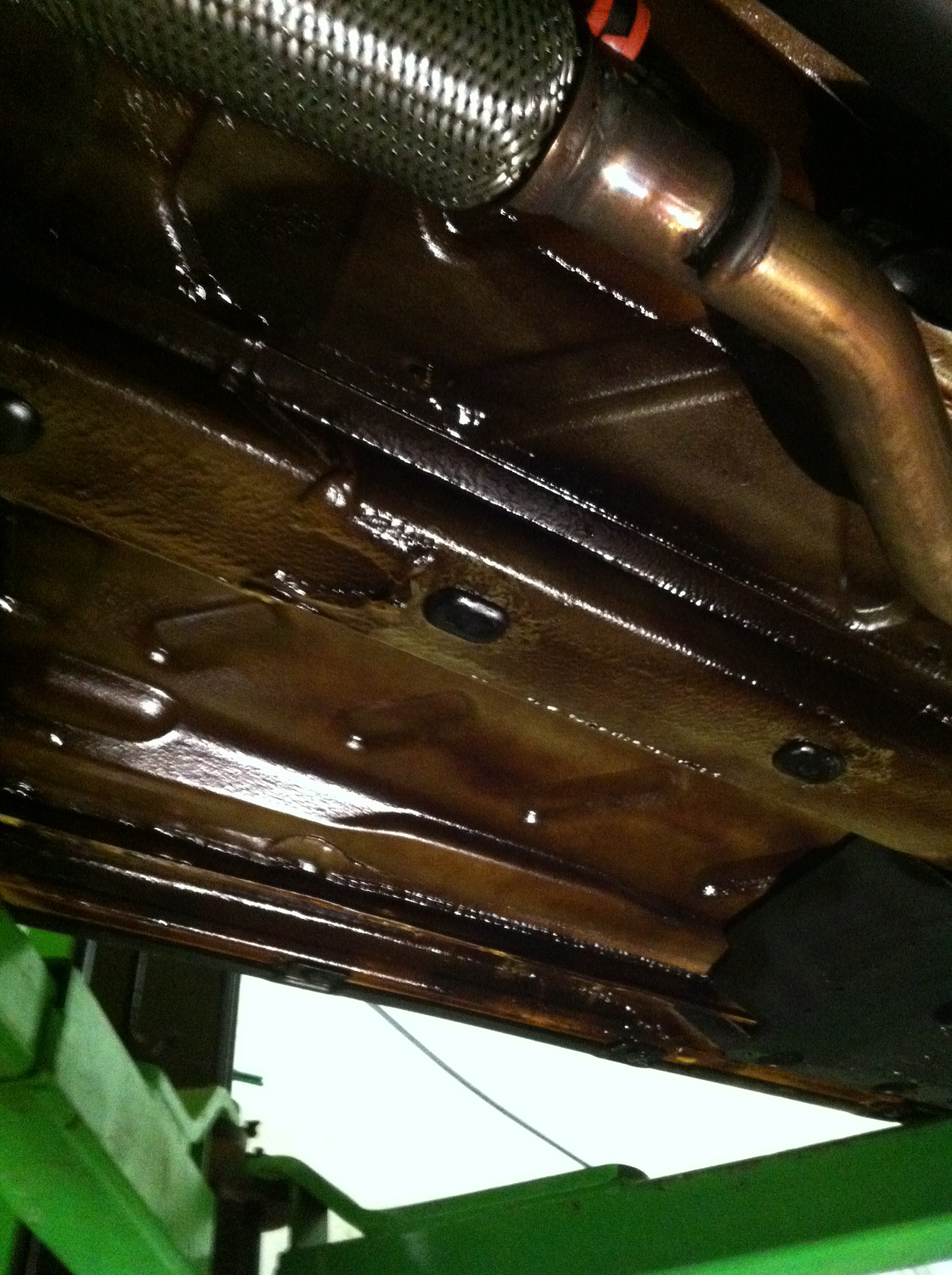

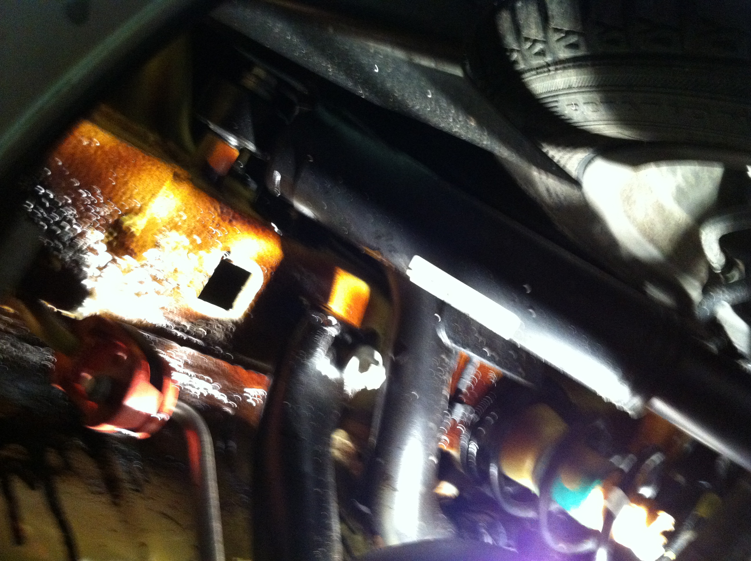

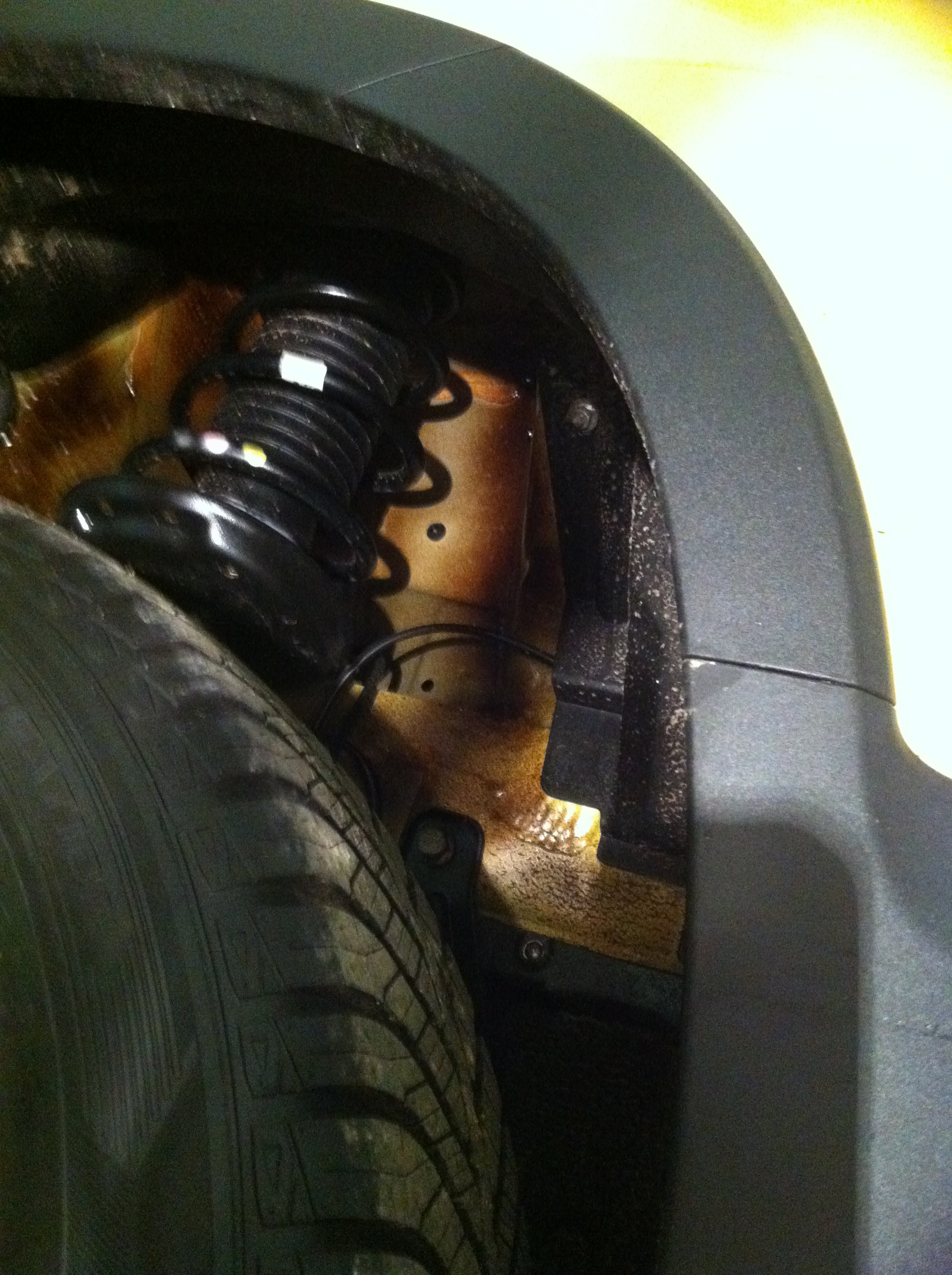

Well today I've been under Buzz giving him some added protection against the winter.
Cars these days are pretty well protected against rusting but I wanted to add some wax protection to Buzz just to be on the safe side. Anyway, it's not just the body you need to consider, suspension components, axles, subframes etc can rust too, and these parts don't get the same attention as the body.
As you can see from the following pics there are many areas of the underside that don't get covered in the stonechip/ underseal......
The chassis rails and other box sections all have rubber grommets that are easily removed allowing you to spray cavity wax into them with an extension tube.......
I then used an underbody wax on the outer areas of the floorpan wheel arches etc. On all the suspension parts, subframes etc I used a clear wax that's pretty much invisible once dry.....
Ok, bring on the salt and the snow, we're ready for you now. :)
