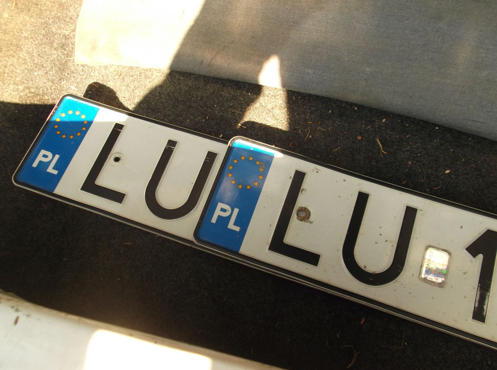

Thanks for the encouragement. She does start and run OK and the brakes seem pretty lively, so the basics are all there and the body is sound (if dented). Everything is very neglected and dirty so it's going to be fun giving her a bit of tlc. I'm saying 'her' as although I'm not in the habit of naming cars, that photo of the number plates suggests that she may have to be known as 'Lulu'...

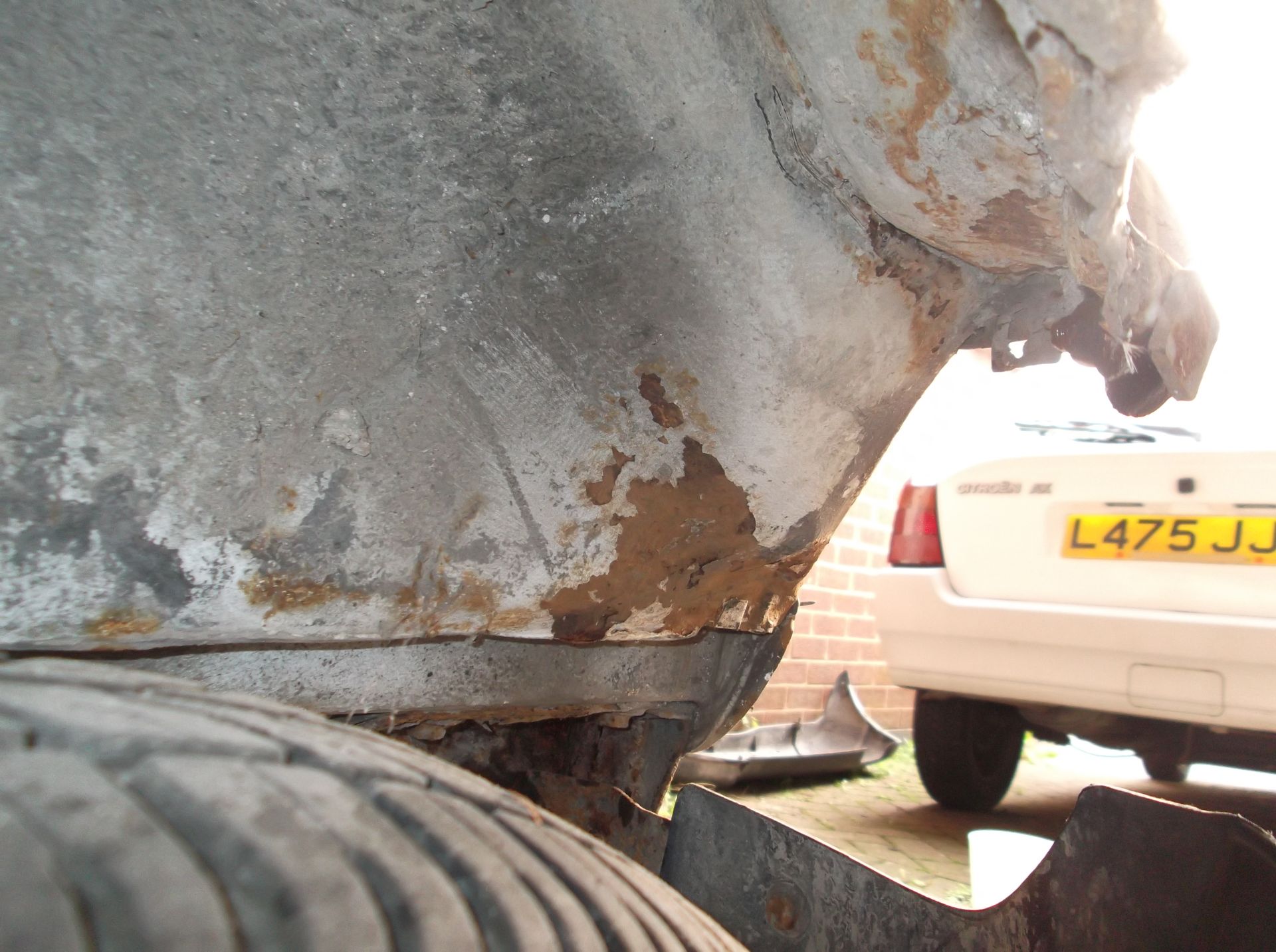

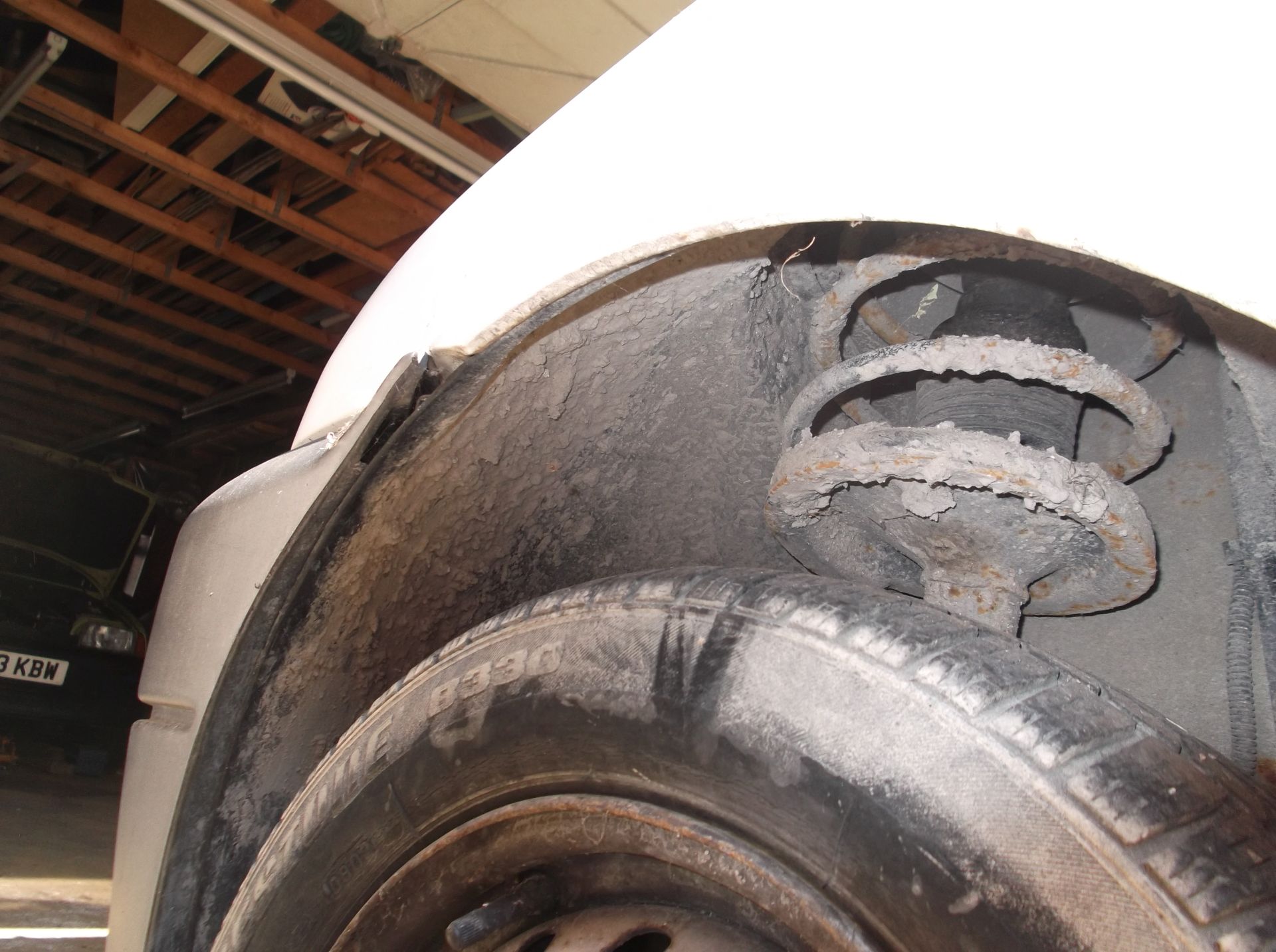

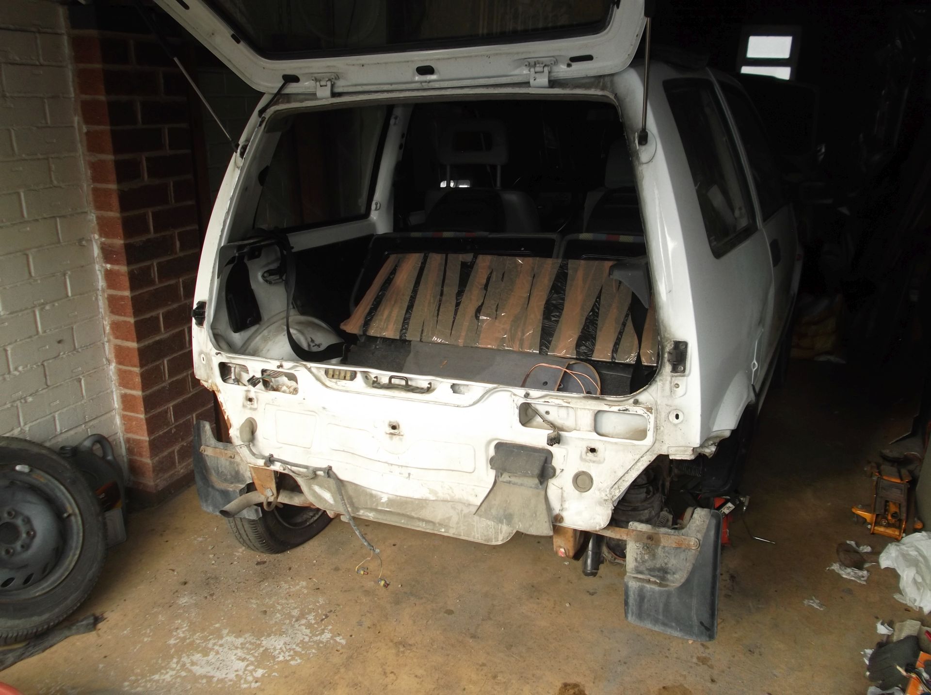

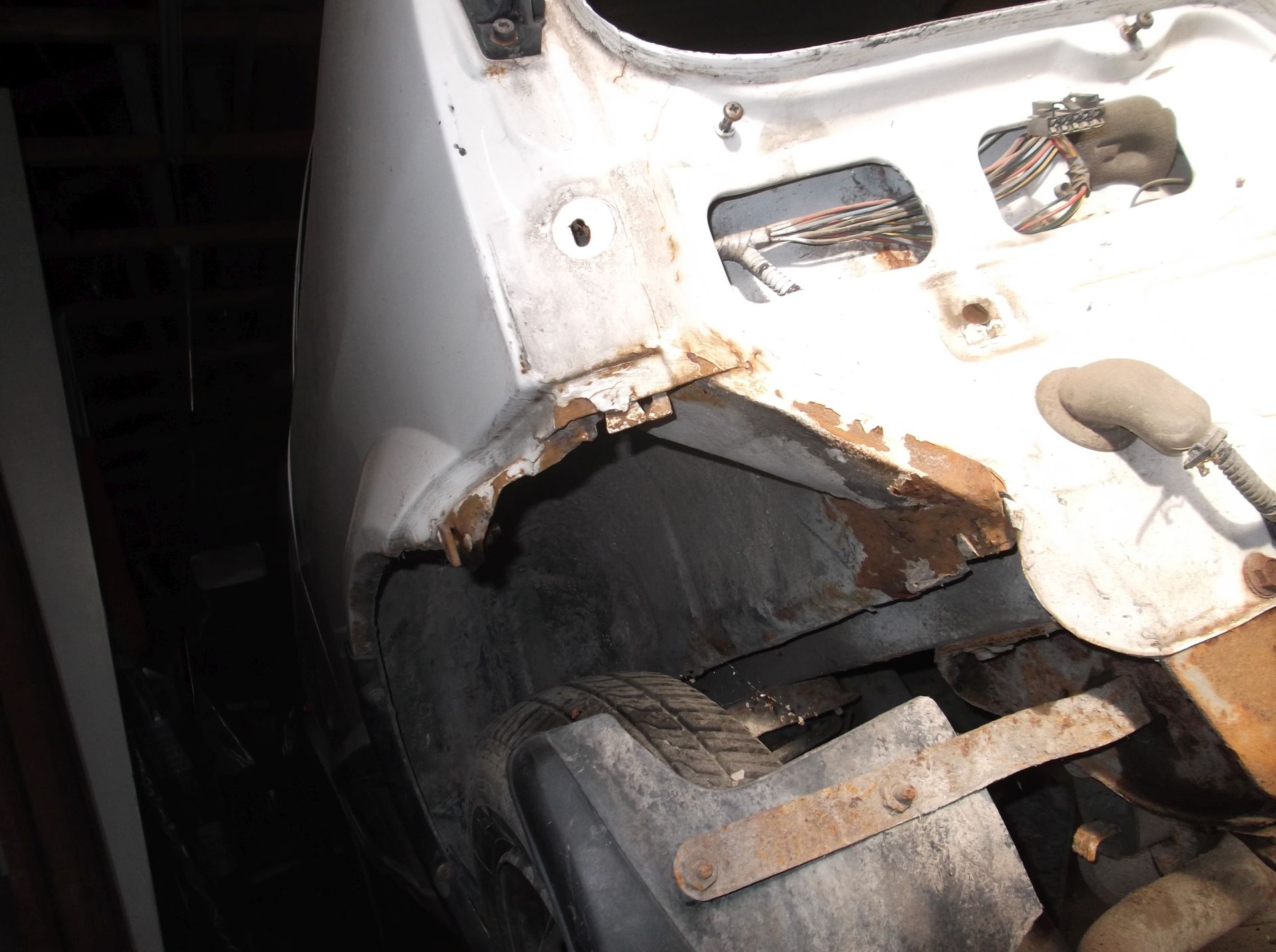

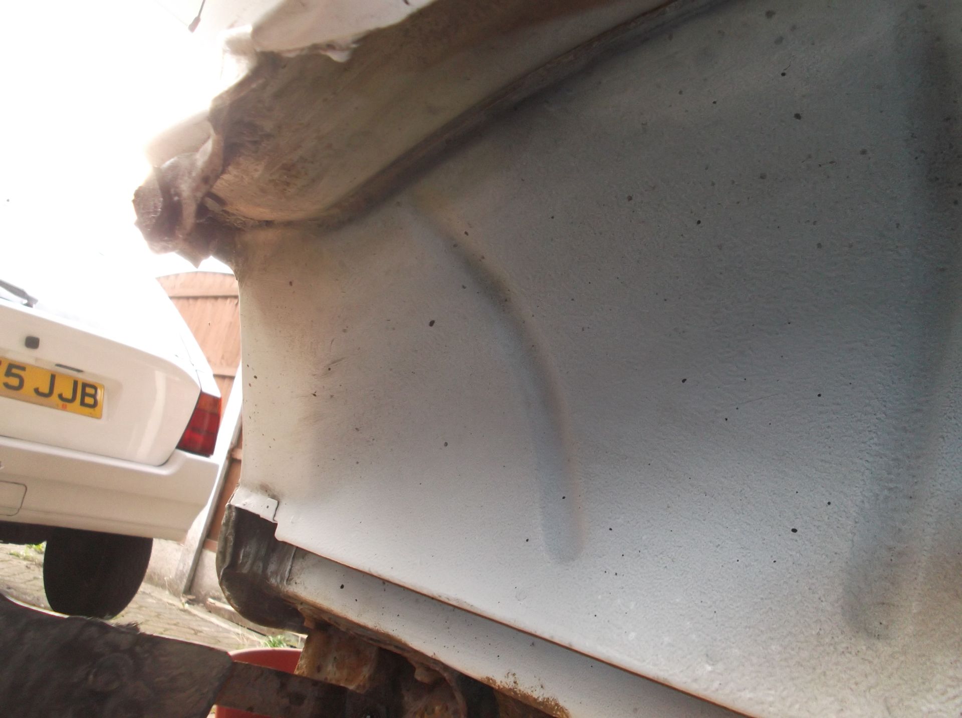

I've not had much time to spend on the Cinq, although I have stripped the rear end to see what sort of state it's in. I don't know where the previous owner of this car worked- possibly a quarry, as I removed about half a ton of dried mud from the rear arches and suspension. Under that, the structure seems pretty good. The rear of both inner sills is OK which is a relief. The usual rot spot at the back of the inner arch is excellent on the O/S, but is rusted through to slight pinholing in the N/S, which will need addressing, however I don't really want to make more work at the moment as the plan is to just get the car mobile, M.o.T.'d and registered, then progress from there.

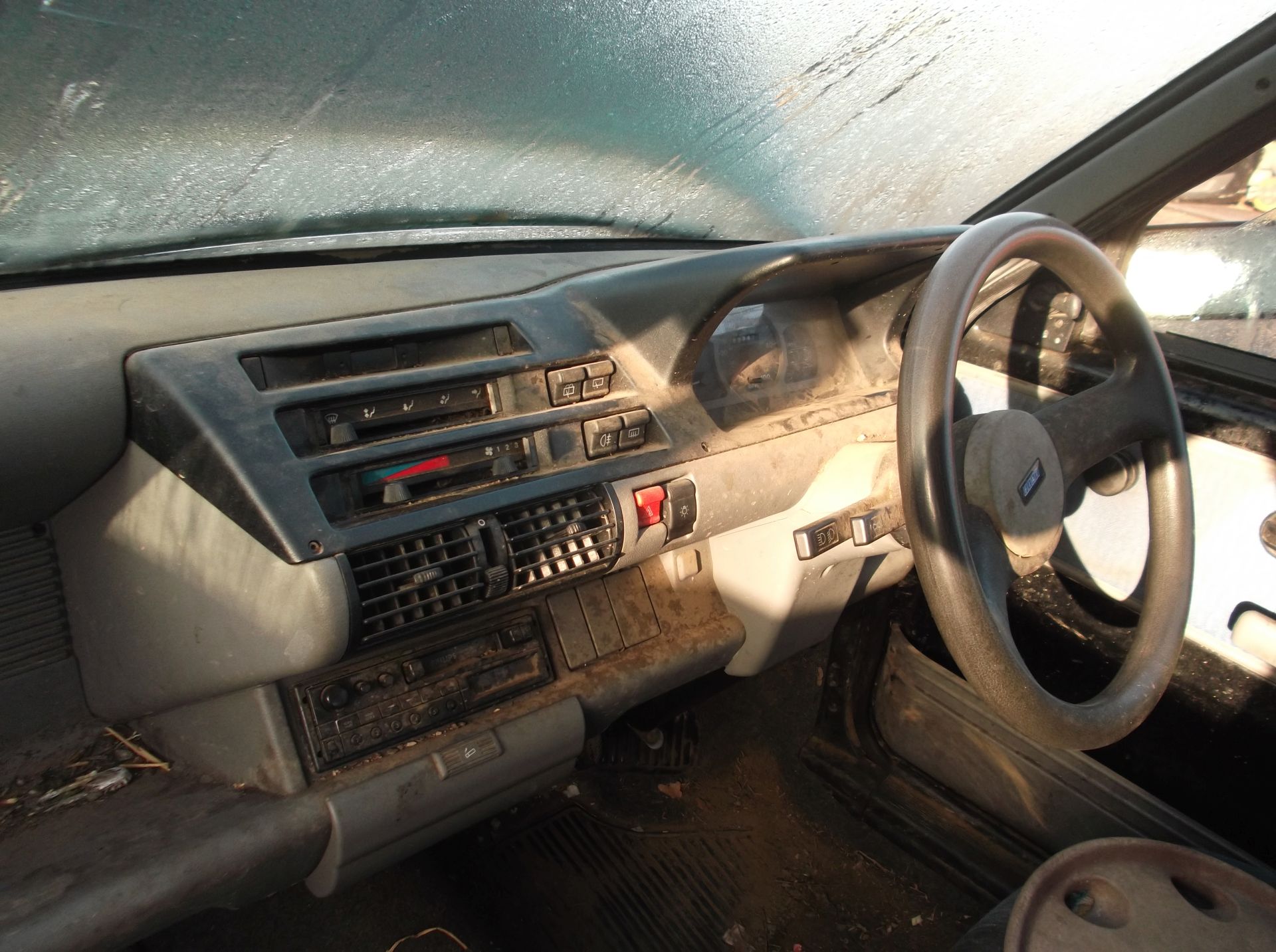

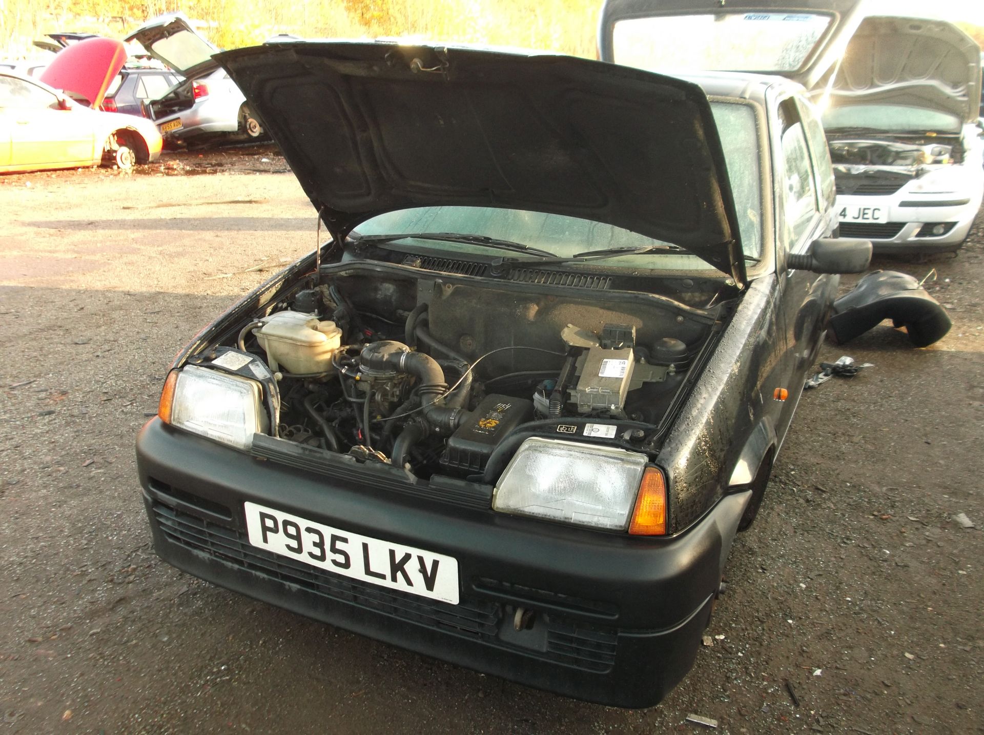

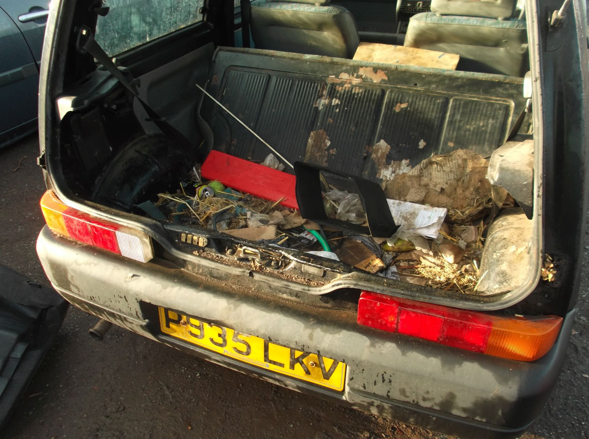

Meanwhile a poor little black Cinq turned up in a local scrapyard, so I raided it for UK spec headlights and rear lights, as well as anything else I could remove. I was hoping the complete interior may be salvageable, but as you can see from the photos, it was filthy, wet and damaged. To my surprise when I checked on the DVLA database, this Cinq is still M.o.T. until November 20th!
