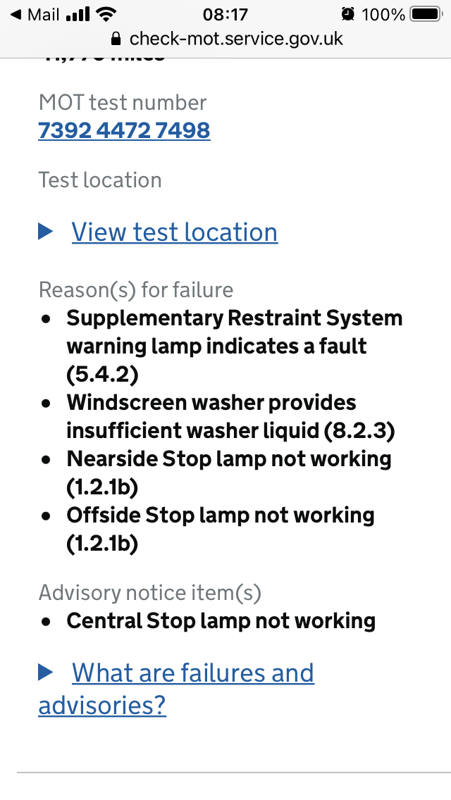

Hello everyone,
My local dealer has a 62 plate colour therapy 500 for sale.
It’s process at £3.5 and has 61000 miles on the clock.
Current mot has no advisories but look back last couple of years there have been issues. I have attached some mot history for you.
Should I consider or avoid the car? I want a cheap run about.

The brake light issue would make me think rear hatch wiring issue, has it been bodged or correctly fixed?

Your one ^^ would worry me a bit, since taking a car in for an MOT, not realising the rear indicators/lights don't work.. or that the tyres are knackered suggests and owner that was better suited to owning a vacuum cleaner than a car... but it needs a look to be sure.
If the sub-frame/arms/springs at the back look rusty/crusted in dirt and the engine bay looks like it could be used for growing potatoes, it may be a "No" from me.
