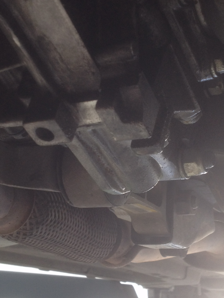

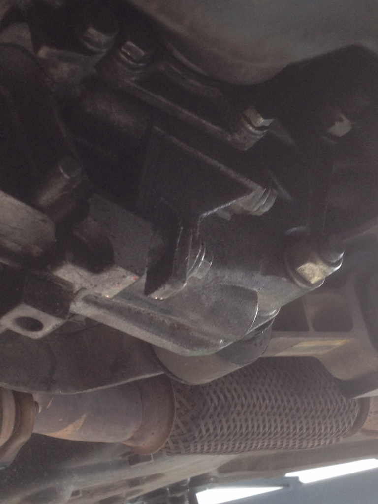

Wow just noticed a few drops of oil on the floor of garage after I reversed so that must be the cause of the smell! Garage tomorrow. Oil was very clear so must be gearbox oil
Yes sir gearbox oil leak! ImageUploadedByFIAT Forum1409556093.776931.jpgImageUploadedByFIAT Forum1409556109.442528.jpg

ok leak is fixed, no more smell. From what i saw fluid leaked onto exhaust? That possible?
