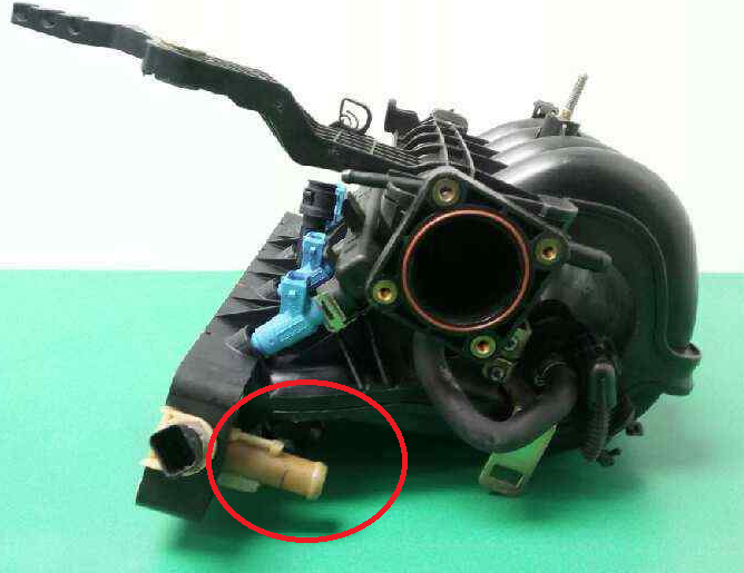

On my 1.2 16v ELX, the plastic pipe in the intake manifold broke.
Do I need to remove the whole manifold in order to replace it?
Which one I need? I have seen 2 types:
I think mine is the white one

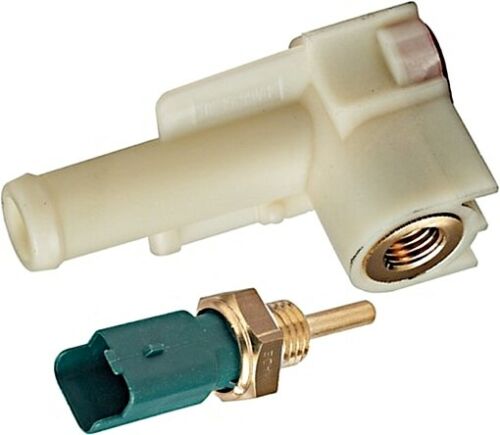

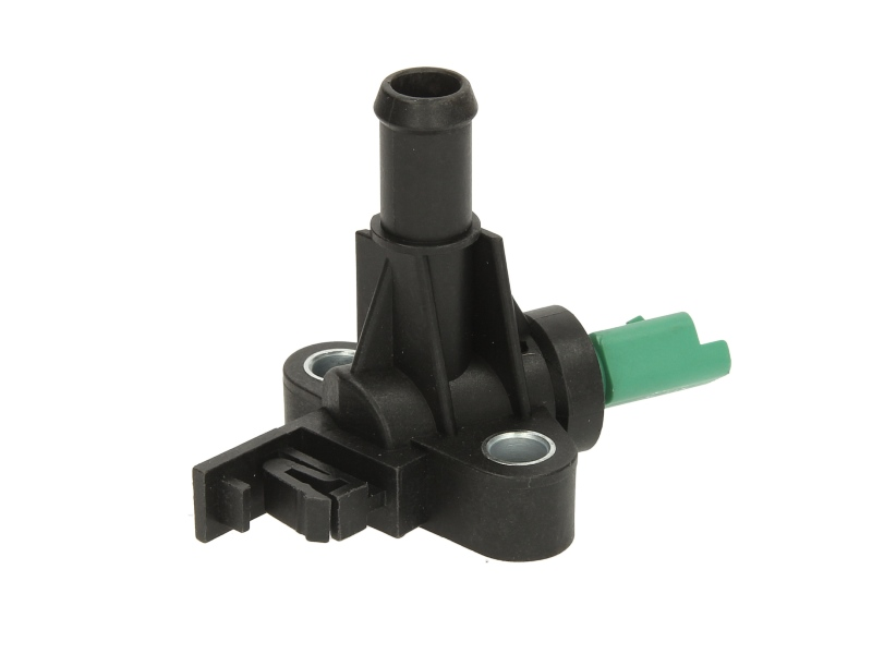

most likely you have the white part where you can replace the green sensor part without buying the conbined sensor and black part.
If you have the white part you can unscrew the sensor and it can be replaced. With the black part the sensor nut is held by the plastic and cannot be replaced.
To replace the white part you have to remove the inlet manifold. I think it is best to get some new gaskets which are not expensive.
