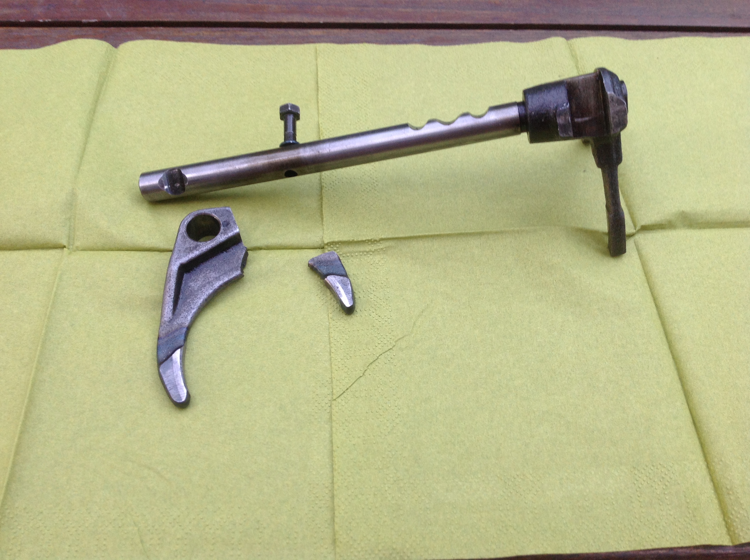

I was in the process of installing a 126 gearbox into my 500 when during strip down to change the driveshaft's I was presented with this, see pic.
I believe it’s a broken 3rd / 4th gear selector but I am not sure. Compared to the pictures in on-line catalogues it does to look like 3rd/4th selectors or the 1st / 2nd.
Can anyone help with identifying which selector it is and how I might find a replacement?
Many thanks in anticipation of your help.
Peter

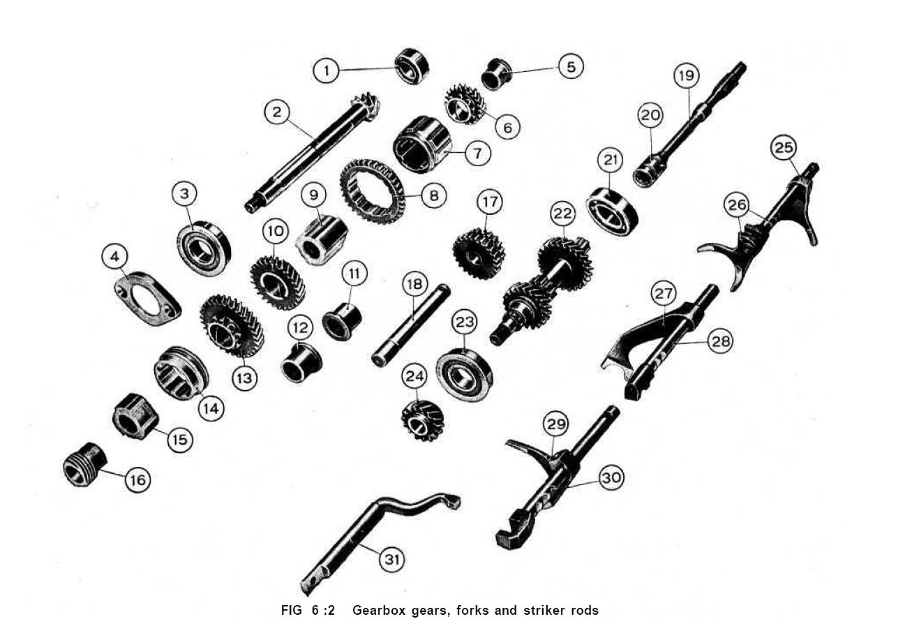

Peter,
I found the attached photo in the Fiat 500 Workshop Manual and I would think that the 126 selectors would be very similar, if not the same.
From the picture your broken selector fork looks like component 25 which is the 1st gear fork. There should be plenty of second hand ones around.
Hope this helps,
Chris

Chris,
Thank you, part 25 it is, I do not have this picture in my manual so you have really helped. I just now need to track one down without having to by a whole box.
