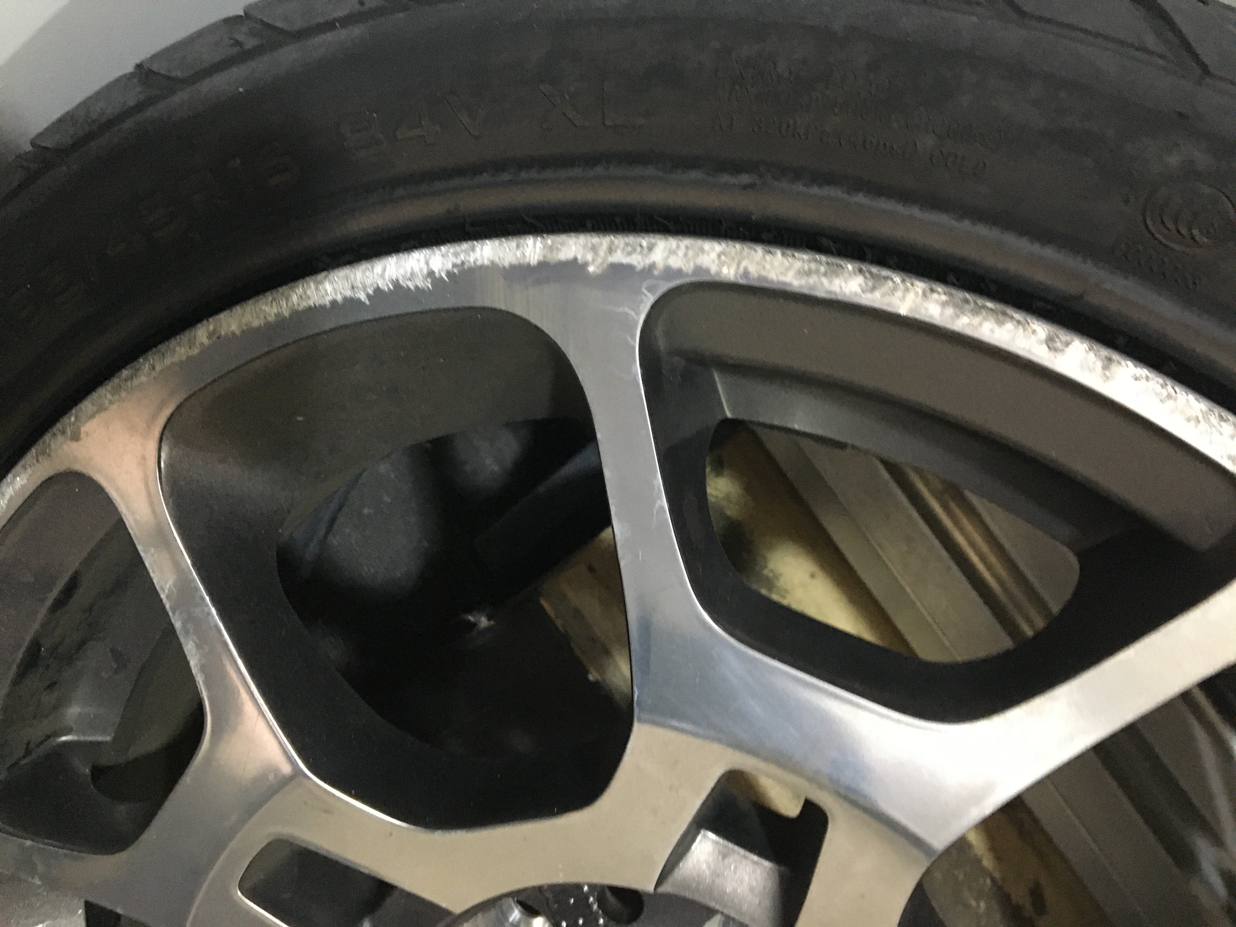

My wife has a tendency with her car 2013 Fiat 500 Sport to run into curbs resulting in curb rash (BIG TIME!) tire size 195/45/16
Infact she curb rashed the drivers side so much it upset the bead (seal) on the tire and now its flat!
Luckly I have 16” Fiat spare steel wheel I put on the driver side same size 195/45/16
Knowing I would need spare some day and that day has come
Before I go the tire shop I tried to fill the tire to no avail it kept leaking obviously the bead is broken
I have photos of the rim and will the tire shop able reinstall the tire?
I don’t know if you tell by the photos!
Next step CURB FEELERS for her car
Have you got a compressor and a copper or leather hammer?
If so, try some washing up liquid all round the rim where it meets the tyre. Let it soak in for a few minutes and try inflating the tyre to it’s correct psi and see if it reseals the tyre.
If that doesn’t work, and there’s an obvious crack/fracture, which will be obvious as there’ll be bubbling from the washing up liquid…then don’t do anything, it’s ‘fuhbahed’
But if it’s just not seated, again, obvious from bubbling, deflate tyre and a few taps with either of the soft hammers may reseat it. Then try reinflating again.
Wheels can be refinished if beyond home repair, but worth a try

The impact could have just unseated it, or the rim might be damaged preventing a seal. Difficult to see from the pics, all a little dark in there.
Sharp edges from the kerbing could puncture the tyre, or gently chafe at it. Probably a good idea to let a tyre shop have a look. Wheel may well clean up with a file once the tyre is off. If it has taken an impact enough to unseat it, it may have sustained internal damage, which will not show, but may develop, and go pop some time later. If it's had a good bump, safer to scrap it.

Upon closer inspection I found a hole in the tire a little bit higher than the rim
I had only just seen this, I was going to suggest reading through everything above that kerbed wheels do not tend to cause punctures but if you go into the kerb and then roll off it its possible to pinch the tyre between the wheel and the kerb and puncture it that way. sounds like that maybe what has happened.

The main issue with your wheels is they look like they are diamond cut faces so once filled you may have to make the decision to paint the whole wheel one colour to then not see the filler around the edges, and cover up the bare alloy (normally just lacquered over the bare metal on diamond cut wheels.

I did sand down the gouges on the wheel before I got the tire put on the wheel
I decided on painting the whole wheel BLACK!
