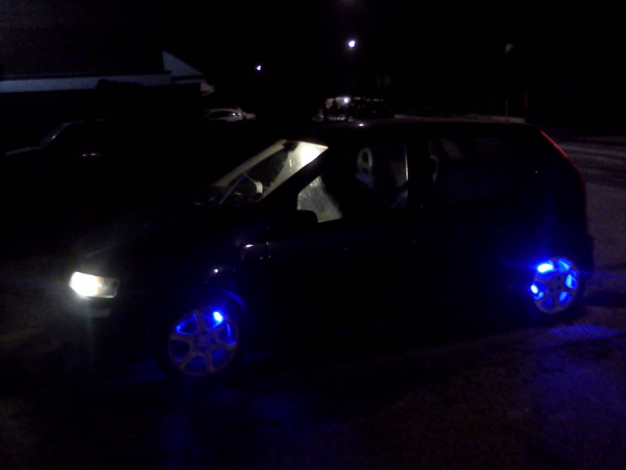

Got my lights done (y)

Re: Bredsticz MK2 BredMobile!
lol that looks so strange! Not in a bad way and i think blue undercar neons would go well with them.
I know you like to be different and that certainly IS different (y)
have you got a switch on them too?
MOFO!!! u stole my idea! lol
i wer planning on buying them have loads on ebay but not sure which are best dnt want some cheap china sh*t
u got a link to the ones you got they look quite decent mate? and how do you actually mount them never figured it oout me lol
but they do look the shizz bud nice one(y) UFO;)
I do have a switch on them and I would like under neons.
They are just the cheapo LEDs on eBay.
As for stole your idea? WTF? I said I wanted to do that since I got the car :p
Rear ones are tigersealed the the drum back plate,
Front ones are cable tied to the caliper, shock and track rod. All leaving enough play for turning etc
Quite simple to do really. Mount the lights as I mentioned in post above. I ran a wire from one of the rear lights all the way along where the brake lines go up into the car through the firewall.
Then a wire from the other 3 lights sliced into the one big one. Taking care not to touch the exhaust with it or trap it in the rear suspension (which I did first) :p
With all them wired onto the one big one. Inside the car I took centre console out, Wired in a fuse to the positive wire and the switch the the negative wire. Splice onto cigarette lighter power supply and done! (y)
My switch is mounted on the side panel that bolts the centre console down aswell
To avoid the exhaust. The 2nd rear wire I went up where the handbrake cable enters the car and cable tied onto there, the front one I followed the anti-roll bar.
Main wire runs up the passenger side. Took a while to do but well worth it :D
