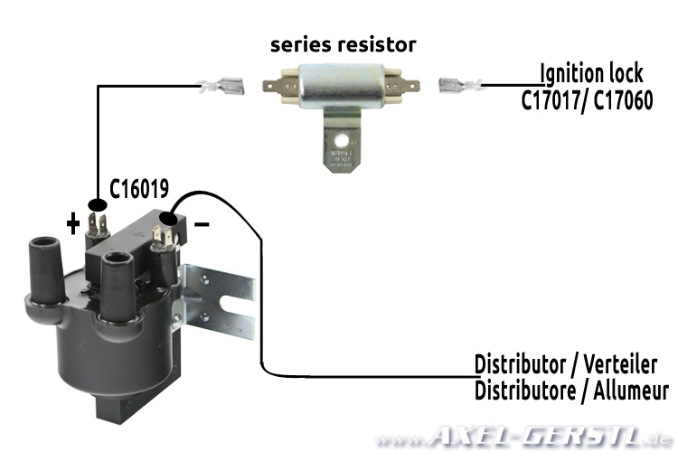

Axel Gerstl, who supply these provide the following diagram and recommend the resistor to protect the coil. Not the true ballast system as Mattsdad describes but it looks like the whopper that I used to have in my 126 BIS. This was actually fitted in the front wheelwell and possibly kicked out quite a lot of heat.
http://webshop.fiat500126.com/katalog/artikelinfo/7659/series-resistor-for-twin-coil
I understand what Mattsdad says but I don't think a true ballast setup as he describes was ever installed on a 126 but I may be wrong???
Maybe the term ballast is what is confusing the issue. From what I can see it's just a resistor that sits on the +VE from the ignition switch, so it is in series constantly and rated at 1.5Ω and would drop 14V's down just below 10V's.
It seems odd that Axel Gerstl would recommended it for a twin wasted spark coil if it isn't needed???? It maybe simply the case that due the fact it is dry that is can't handle as high a voltage as an oil filled one, therefore is more prone to overheating and burning itself out????

The Fiat 500 Club says that if the coil is specified at 1.5 ohms you need it, if 3.0 ohms you don't.
Some people say that its resistivity increases as is warms up, hence it is a very basic ballast system. The commonly stated value for it is 1.5 to1.7 ohms, which seems to follow at least mathematical logic to me.:eek:
So it might help clear things up if Darryl knew how to ascertain the rating for his new coil using the multimeter.
Regards, Peter
