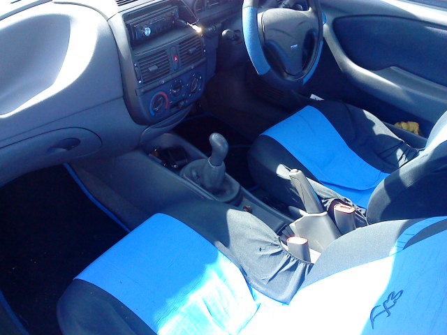

just thought i would post a picture of the dismantling process
The Problem i have is clearing the stalks. the facia is ready to come out, but like i said the stalks are the problem, is there any way of bypassing that by any chance?
Chris.
Ahhh that pic takes me back :cool:
If theyre in the way, remove them :p disconnect the clock spring and remove the cable from its holder. Either 3 or 4 phillips heads hold in the clockspring depending on the car. An allen key holds it in position around the column, then disconnect the plugs. Violá (y)
