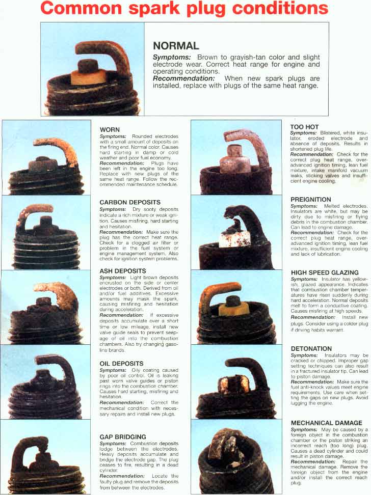

It might be worth checking the spark plugs even tho they are ~new.
-check to see if any are wet/oily or in general good condition.
-check spark plug gap.
If any of the spark plugs are oily/wet it might help you determine if
injector leaks or if the coils are faulty ( these seem to be a very probable cause for the symptoms.. runs bad when hot or under load)
It is possible that the error was not registered.
