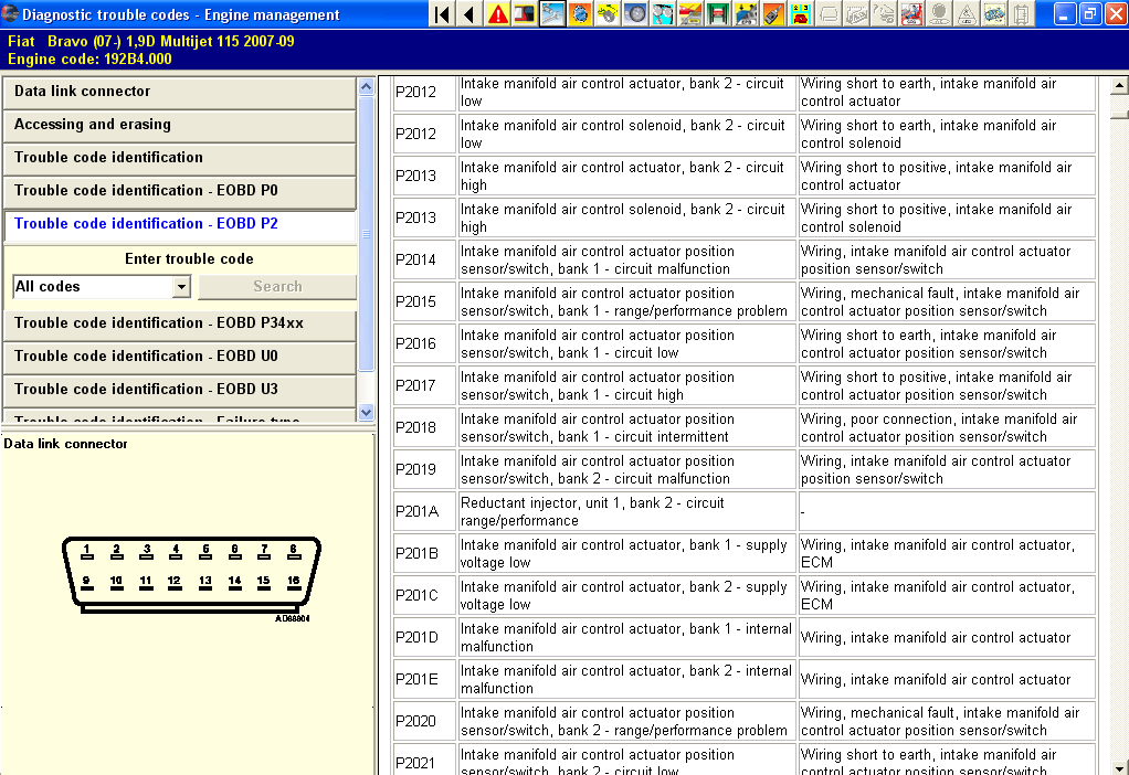

Hi i have a 2008 1.9 multijet diesel Bravo. When i first turn the car on, it is fine, then after 5 minutes or so it goes into Limp Mode. After reading loads of stories on the internet, i changed the MAP sensor. That didn't work, Eventually, i took it to my local garage and they done a diagnostic test which says it is an air valve. However, the garage say they have checked that and can see it is working fine. They said i should take it to Fiat....i can only imagine how much that will cost. Any ideas on what i should check, or should i change the MAF??

P2015......which is something to do with swirl flaps......but the garage said they were working fine...they why they suggested going to fiat

attachment.php
