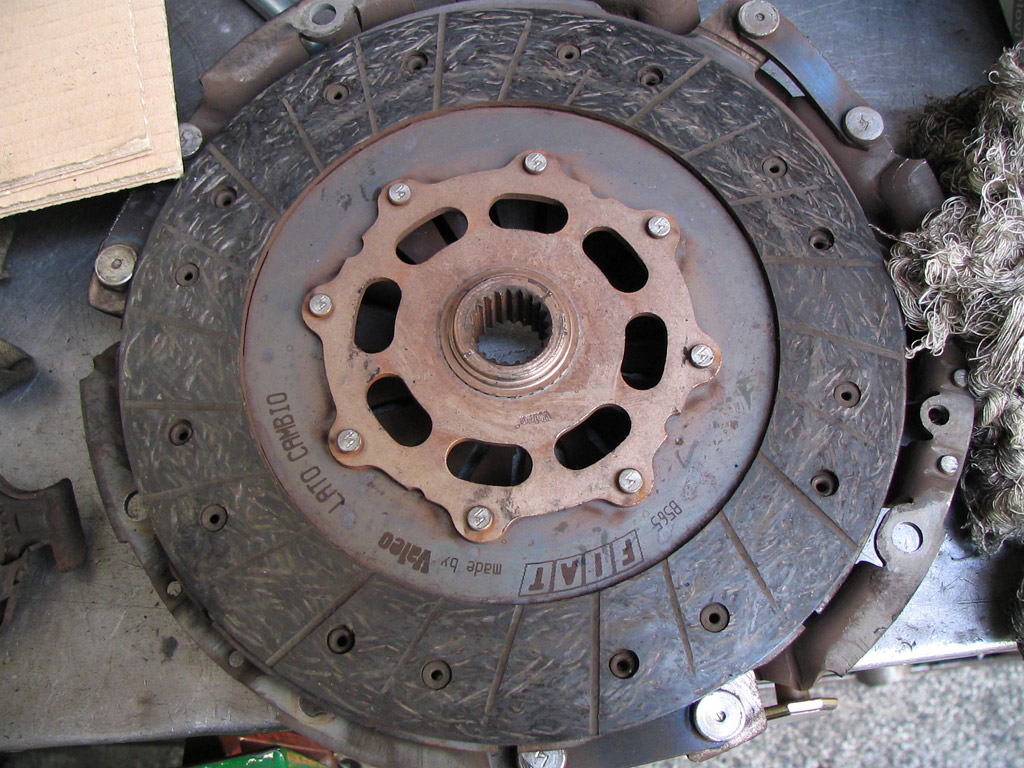

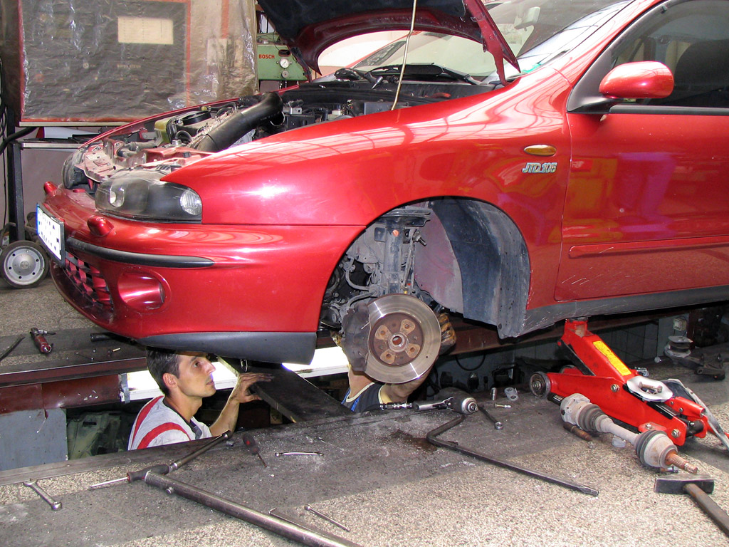

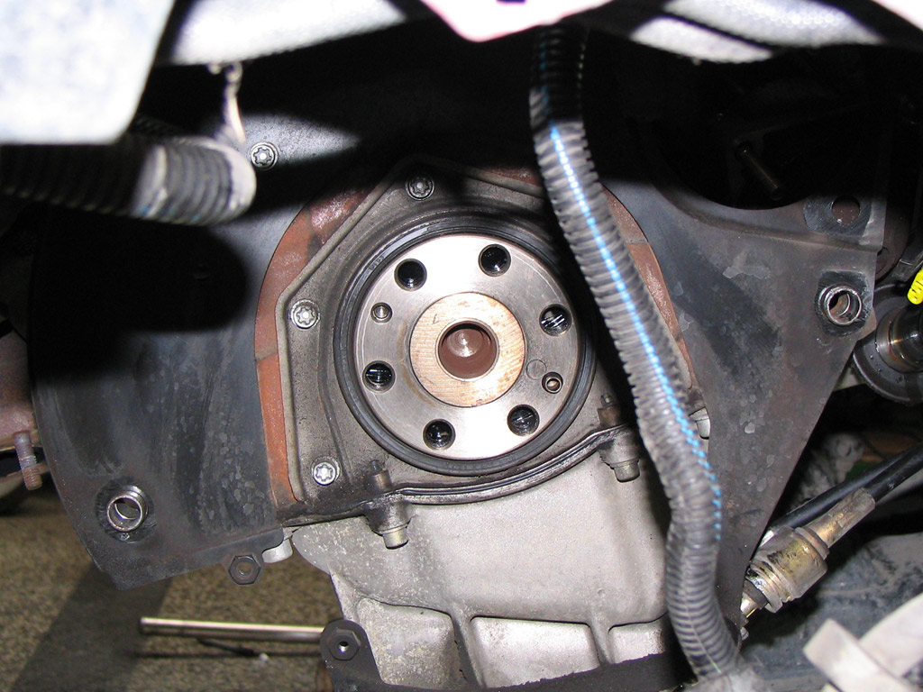

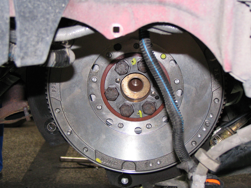

You'll love your car when you change the clutch and the flywheel. I did it last summer for 750 euro here in Bulgaria. Clutch and flywheel by Valeo, the clutch pump on the gearbox was leaking so I replaced it with new one by AP, new brake fluid. The labor was only 75 euro (included in the total price of 750). It took them 6 hours to change all this. The whole front suspension was removed plus the exhaust pipes. I was going to cry when they told my my flywheel needs to be replaced. I suffer 4 hours until they reassemble my car and believe me when I did the test drive.. this was not my car! It sooo cool to drive it now - no more judder at all!
Here are some nice pics below:
