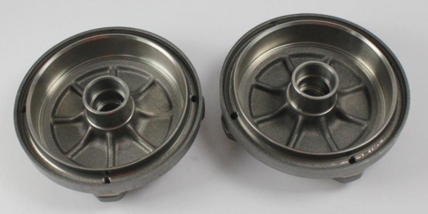

The new ones I ordered are looking quite reinforced judging by the ribs on the inside. The ones on the car look the same mind you...but it's difficult to tell how much service they have done...maybe to the moon and back...who knows!
