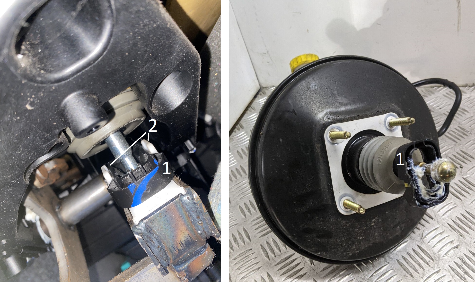

Hi I’m trying to remove the brake servo but can’t work out how to disconnect the servo rod from the coupling in tbe passenger footwell any advice please? See pic attached

I'm only guessing as I haven't done it, but it looks like the black plastic housing (with blue paint, I've labelled it '1' in the picture) seems to be part of a retaining device for the servo rod.
I would try prising apart the clips on the white part of the housing (2) to release the black section
There may be images of the RHD assembly on ePER but I'm getting an error when I try to open pages 2&3: http://eper.fiatforum.com/eper/navi...INT_MODE=0&EPER_CAT=SP&WINDOW_ID=1&GUI_LANG=3
Hope it's of some help - good luck!
