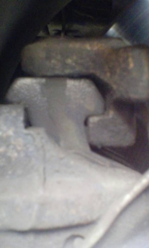

If it's front look through wheel at caliper if end of pad looks like this it's ate
Look at ends of pad backing plate if they look like a T its ate

The discs are the same part whichever calliper is fitted.
Have a look at widemouths link
On that there are drawings of pad out lines.
On The drawing labeled ate its the second pad that you see through the wheel (with the T shape or ears)
The drawing of the Bosch caliper pad shows how different they are so you can be confident .

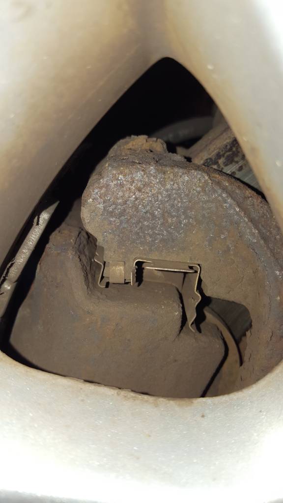

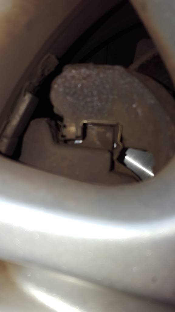

Will you be fitting yourself?
You are correct they are Bosch callipers.
