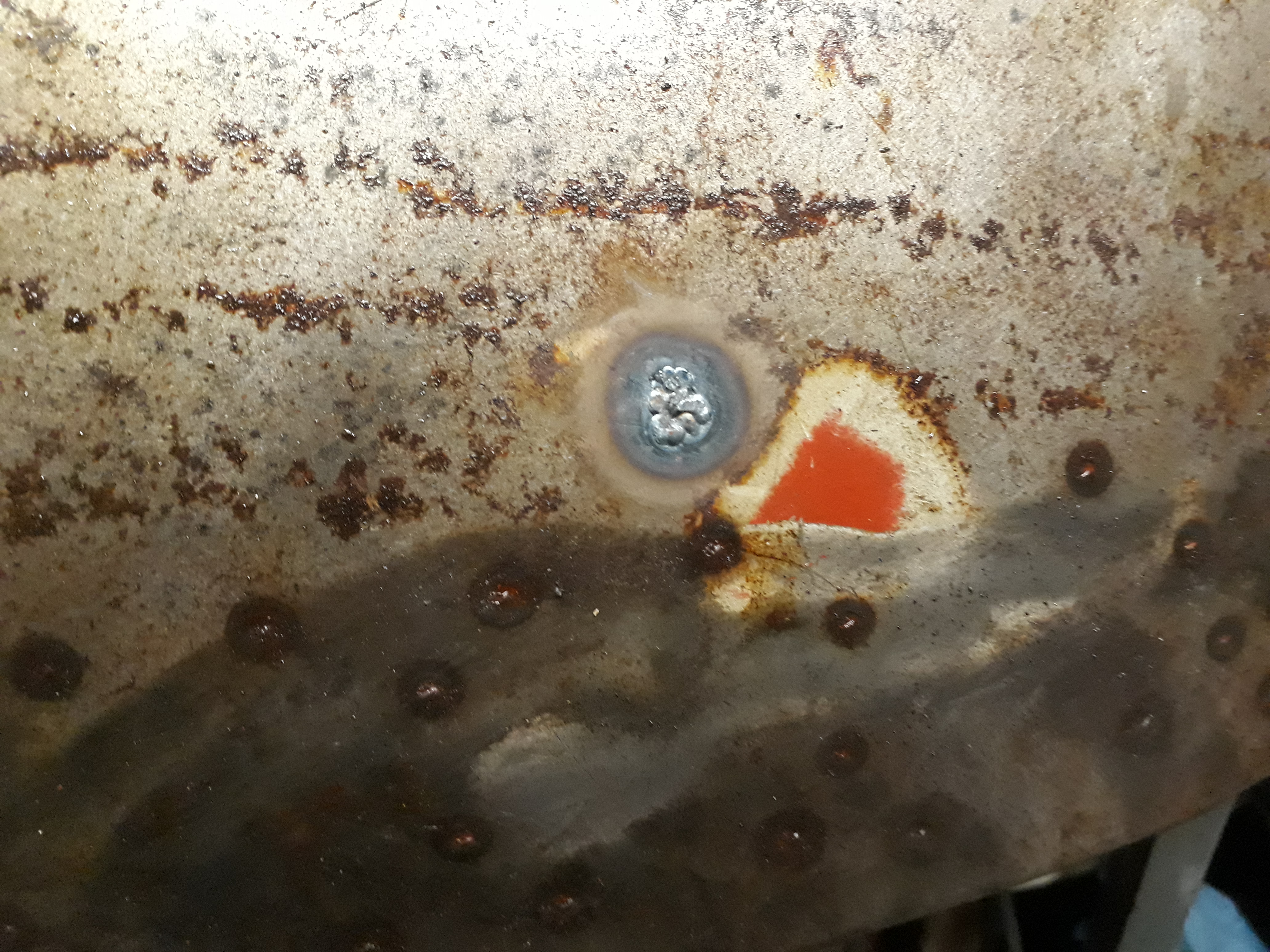

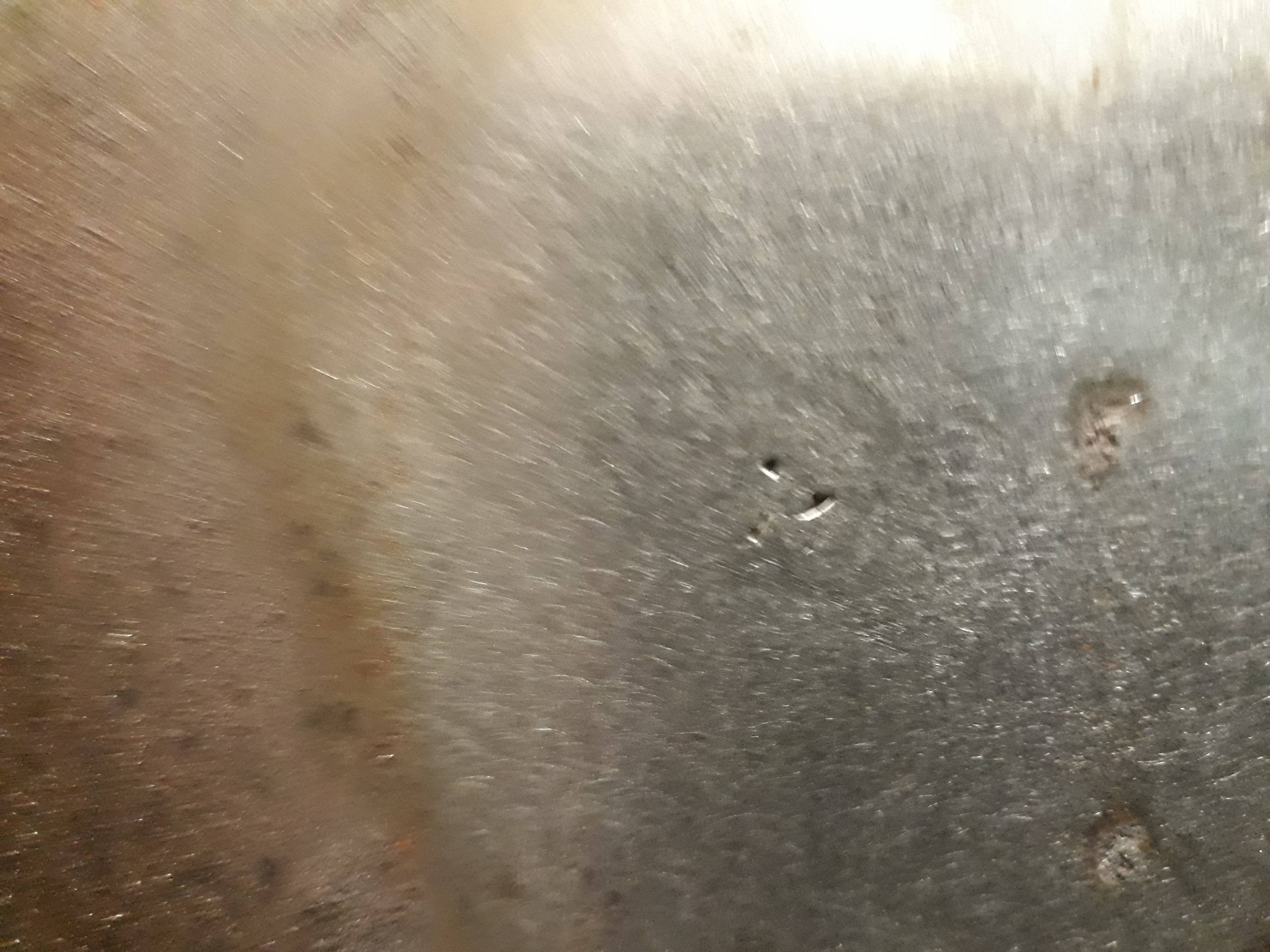

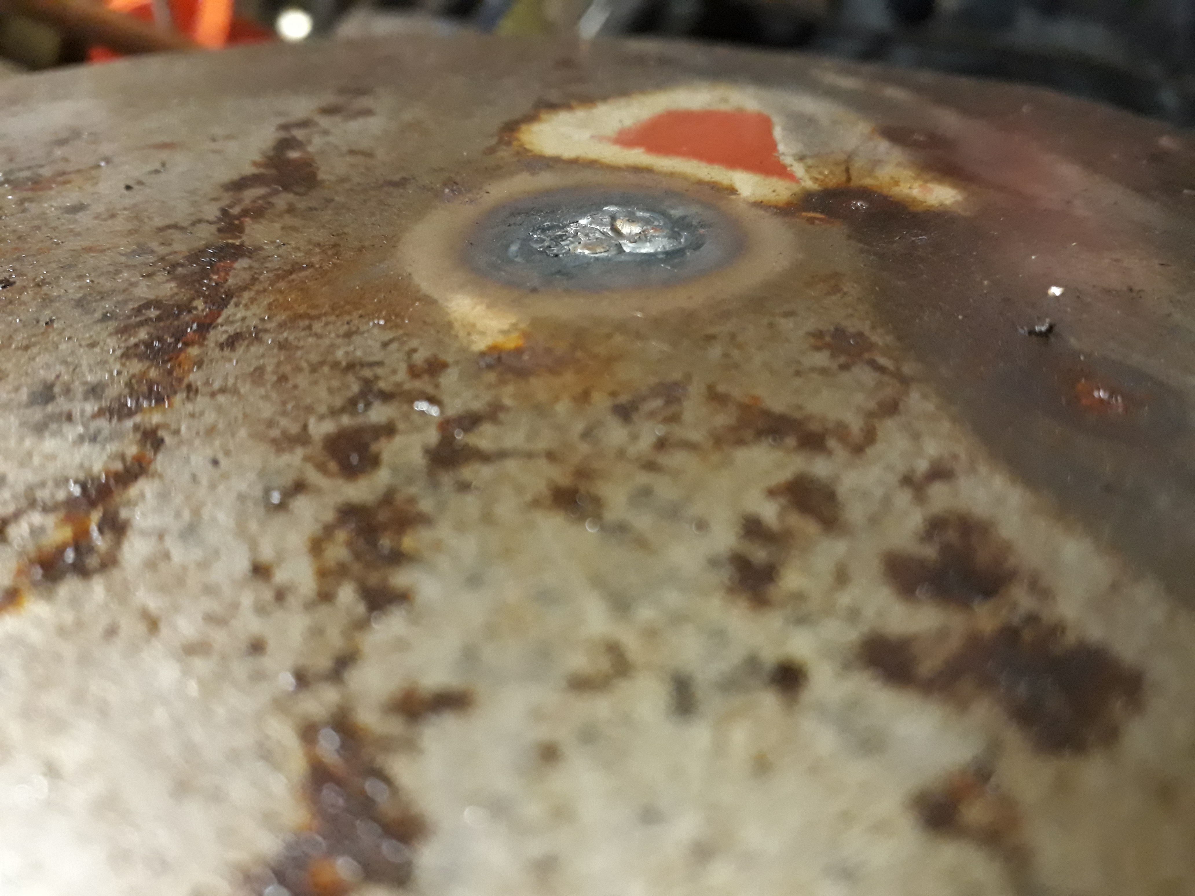

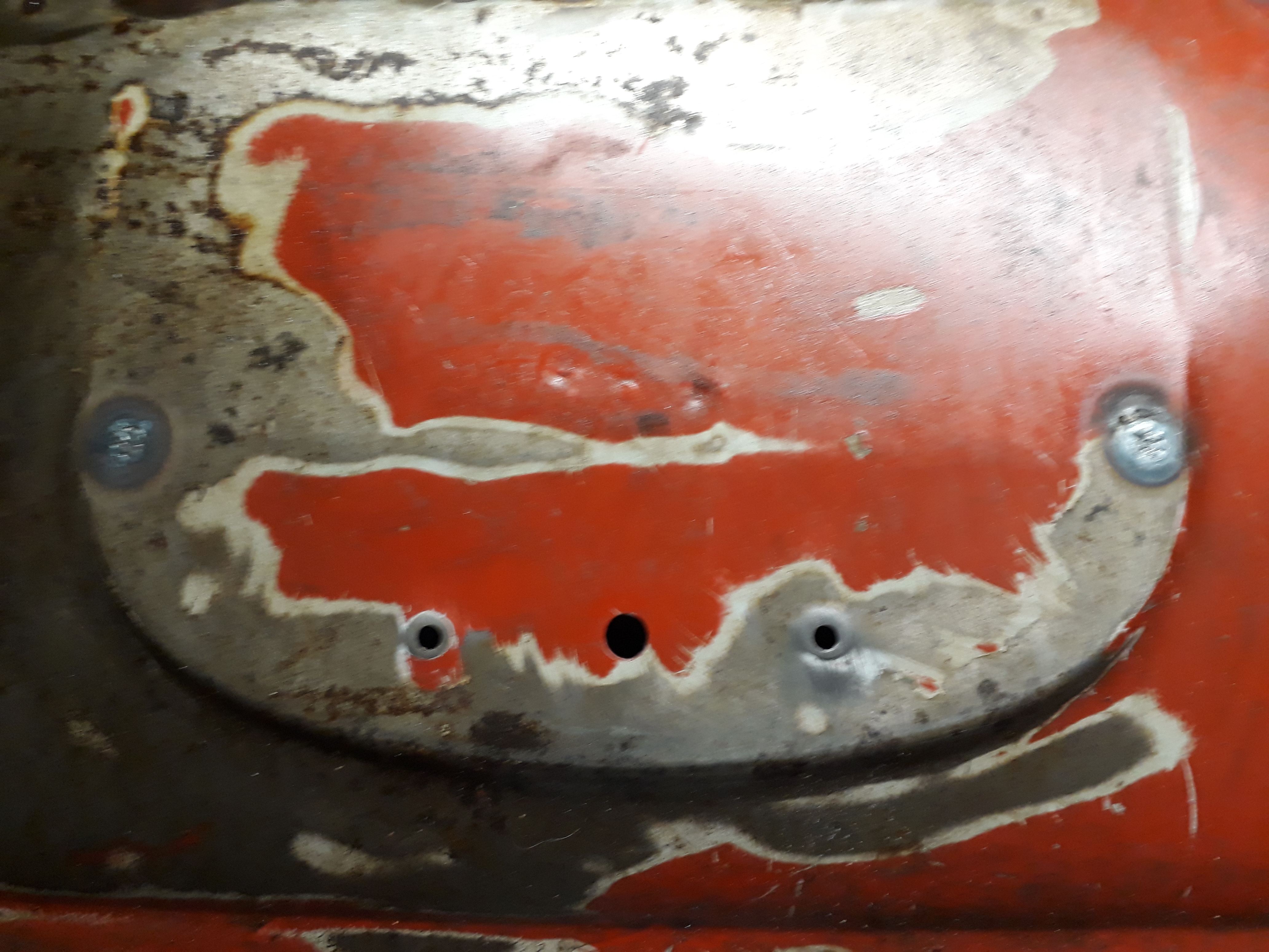

There were three holes in the bootlid that I wanted to fill in. Time for a bit of welding.
I borrowed a piece of brass bar from work because it doesn't let weld stick to it. I covered the hole from the outside with said bar then welded it from the inside.
Once welded I cleaned the weld up on the outside and I'm pretty happy with it. I think my photography skills are getting worse though!
