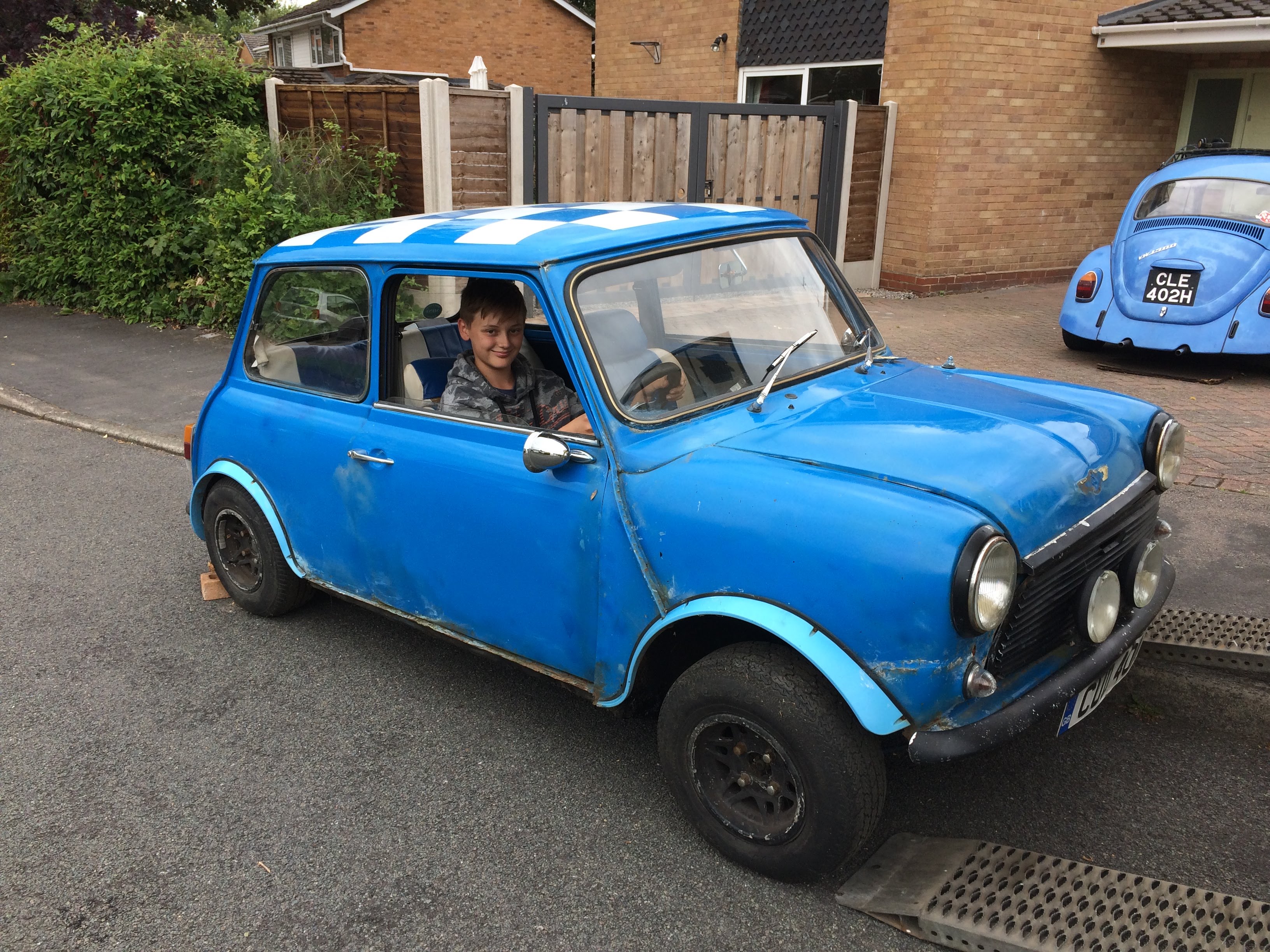

The last car I restored was a Mini for my son. Started like this:-

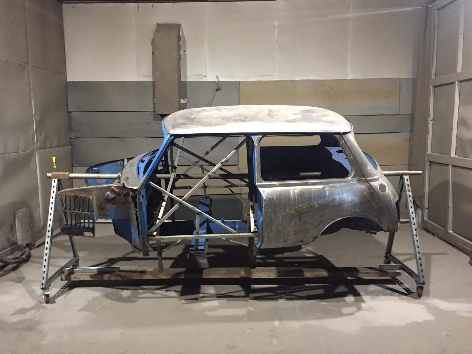

Some of a bodyshell just before it was shotblasted:-

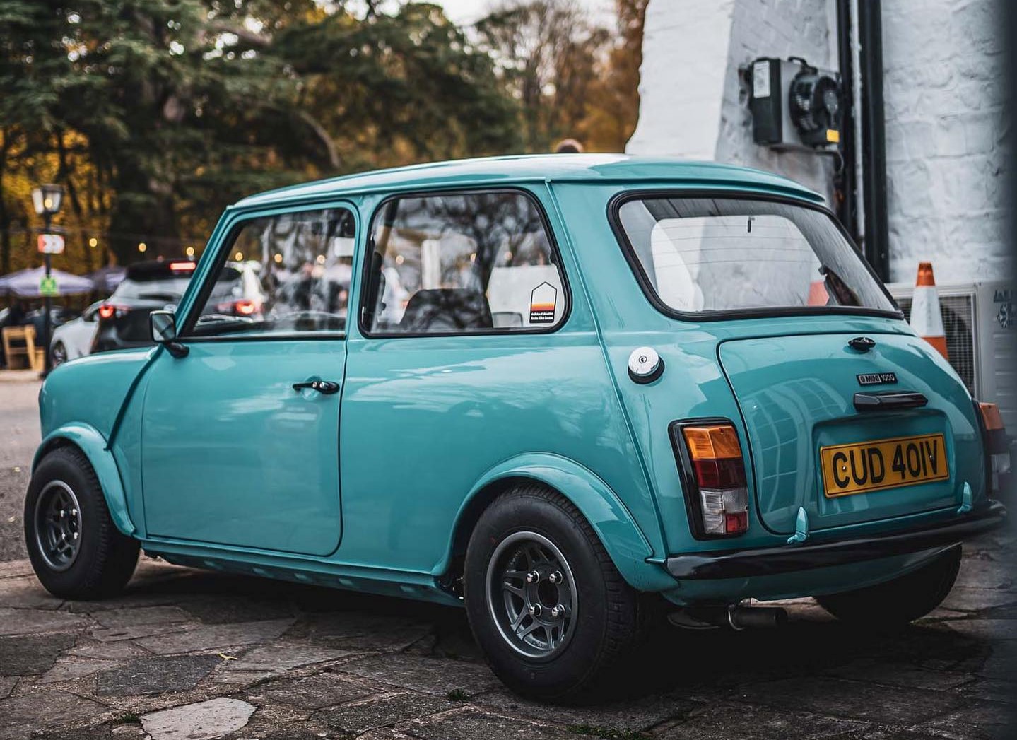

And how it is today - it came out rather well :). There is currently a very lucky 17 year old driving this to school every day...
It took just over a year from start to finish. Lucky Leo took it for a lap of the NC500 (turned out to be 800miles in the end) on Learner plates earlier this year when he was 17years and a 1 month old. I trailered it up there though as I don't think I could have faced a further 600miles each way (plus I'd have to drive it as he wouldn't have been able to use the motorways!)
