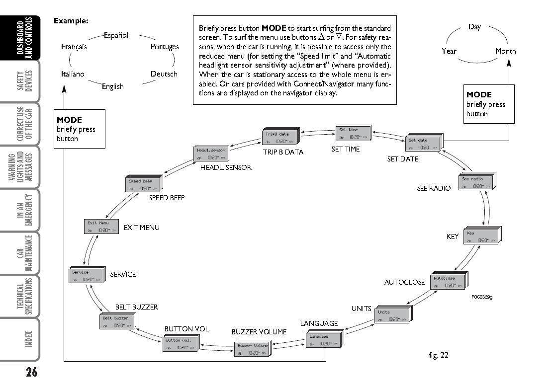

If you have CN+, it's: Setup/Vehicle/Independant Trunk Lid Opening.
If you don't have CN+, it's: MODE Button/Key/"Open doors" or "Open all"

Mysterious menu. I haven't got CN, just a standard menu (and ICE), but have never seen any "key" option. But I have some other items than shown in your menu. I will have a look when the day is dawning.
Problem solved... Thank your for your inputs - as they were somewhat correct. It was all in the menu.
