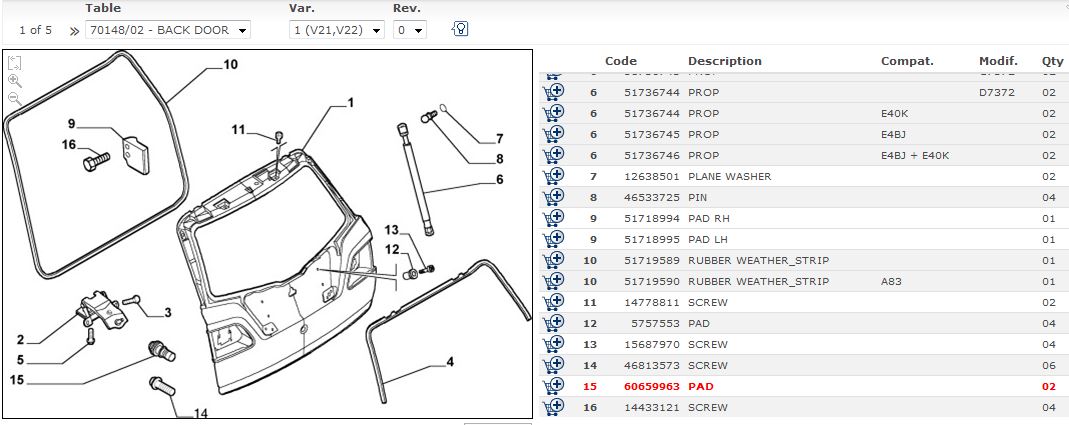

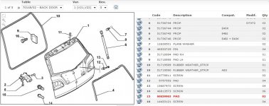

Part number is 60659963. Item 15 in the diagram below. Price was about £4 each, but my copy of ePER is November 2013 so they may have gone up.
