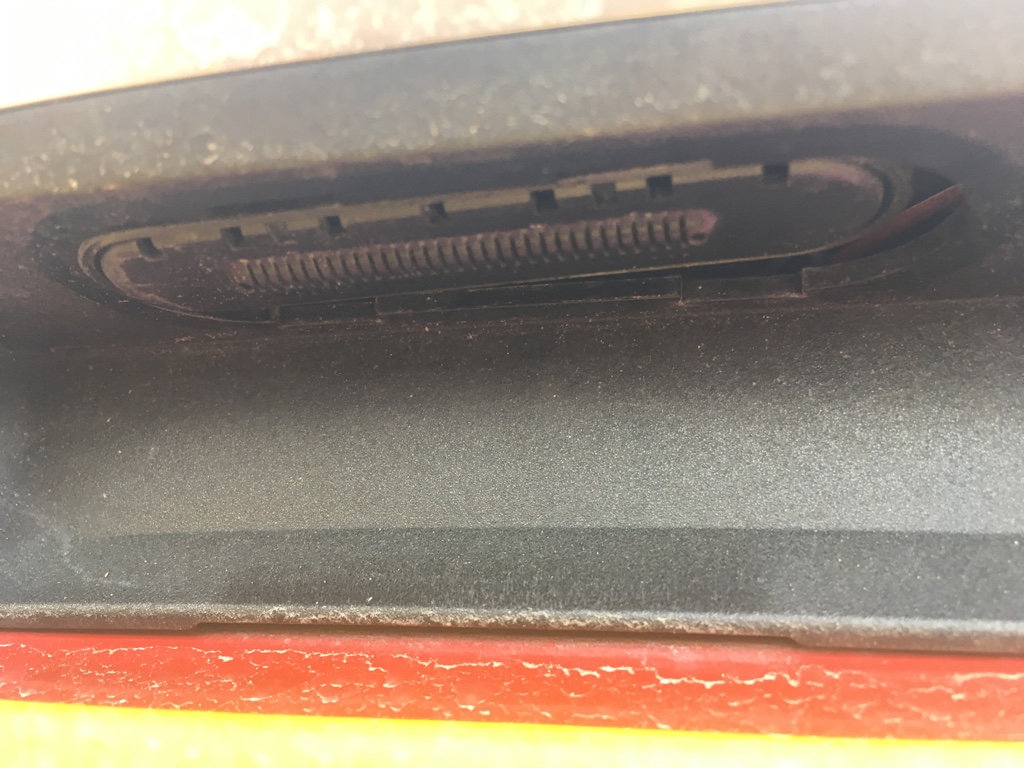

IMG_0538.JPGthis is what you mean!!

I'm looking at the picture you posted of the dislodge switch and it looks like nothing to my mine.
1) I don't have any "castling" around the perimeter
2) My centre pressure pad "ridge line" is smooth and not castled/corrugated.
This leads me to possibly conclude that Fiat changed the design to their detriment?

That looks like the rubber cover has come off.
