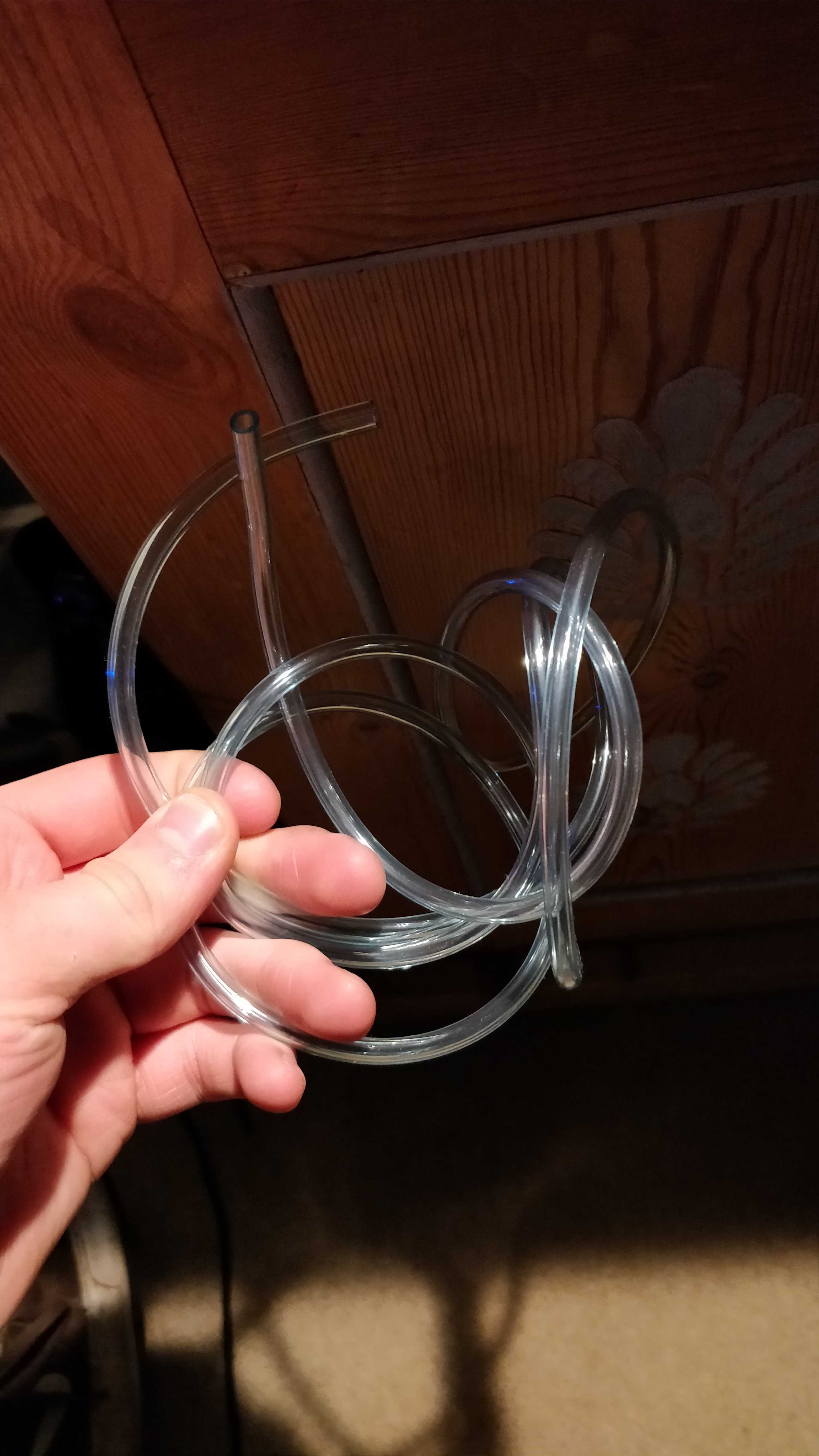

Thanks for that! I've got 3mm washer tubing that I use for my boost gauge at home...
Will this be okay?
It doesn't move too much, I think it's just happened over time.
The car over boosts at about 22psi...
Remove from turbo, cut bad part, reinstall, jubilee-clip (no tie-rap: too weak) and you're done. And definitely attach the valve somehow !
Will this be okay?
Hi,
I came across this type of tube you have, that someone previously installed,
I wouldn't recommend this,
Like mine before replacing, the tube gets too hot and soft, so when pulling a vacuum, the tube would collapse/squeeze,go get some 4mm high heat resistant tube, should only be a few bucks from your local hardware store,
I'll get a photo if you would like
Oh 4mm being the wall thickness,
Also yeah I have noticed my GP gets up to 22psi then drops if you wanna try keep pushing it,
