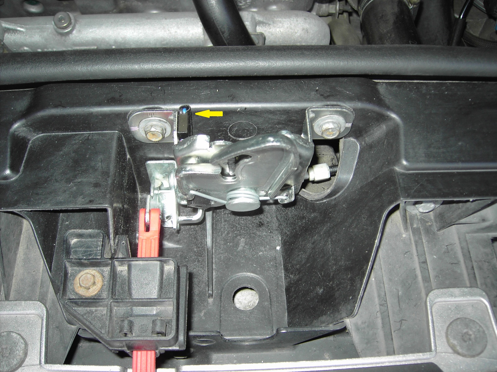

The bonnet open warning sensor is a small switch attached to the bonnet catch.

ok the bit the arrow pointing to I can not see nor can I see any wires for it there it was fine a few weeks ago
You will only have the bonnet switch if your car has the original Fiat alarm installed.
The link I posted in post #2 above is for people that have the "Bonnet Open" warning message, but don't have the alarm or bonnet switch.

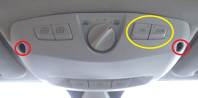

If you have the alarm, you will have the 2 volumetric sensors AND the 2 alarm cancelling switches in the roof console. Picture below is for Stilos with the electric sun roof, If you don't have an electric sun roof, the 2 switches will be in the centre of the roof console.
